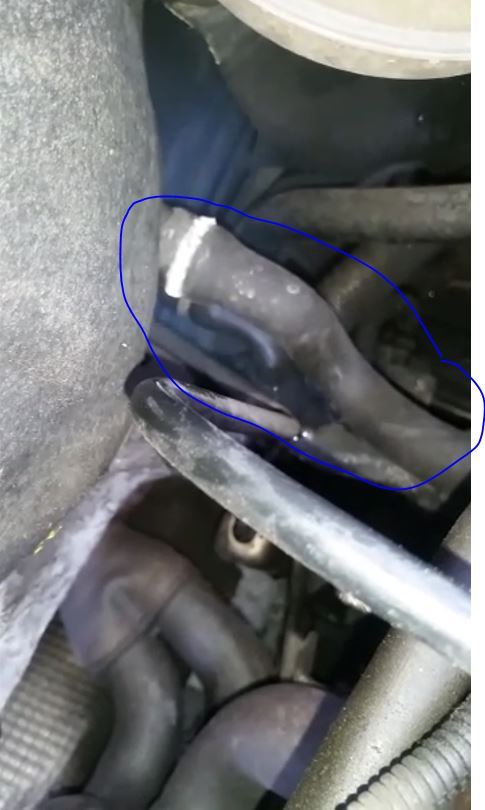

this may sound like a stupid question but my 172 appears to have a burst coolant pipe, the pipe is the thick pipe coming out of the bulkhead does anyone know where i can get this part to replace? unsure of the actual part name to be able to order it?
i know its a bland question just thought some of you boffins would know
Thanks
  Cup 172
heres a picture of the affected pipe

  172 Ph1/Scooby MY00
