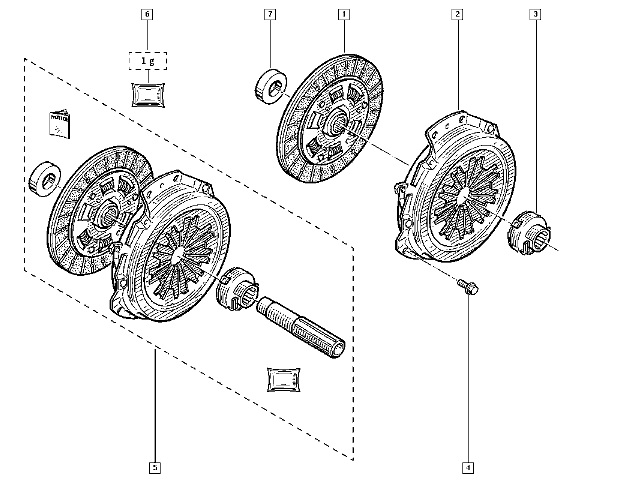

Take a look at the picture:
Possibly number 7 he's on about?
If so...part number 77 01 034 545, classed as a fixed bearing - not the release bearing.
  M3, Cup racer'd 182
Ah i was thinking no3.
Never seen a bearing before the clutch plate before, but then again it's a Clio nothing ever straight forward typical French cars lol.
