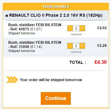

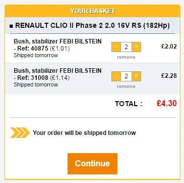

Ordered these from Mister-Auto.co.uk and they are surprisingly cheap, both FEBI parts have the exact Renault numbers matching as per above.
