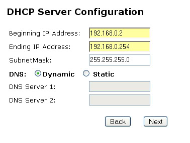

Somewhere in the settings (every router is different) there will be an option for DNS Servers. The following is an example on my router -
Mine is currently set to dynamic. This basically means it uses whatever DNS servers if wants. Most ISP's will have details of their specific DNS IP's on their website somewhere. These IP's are obviously entered into the relevant fields, saved and the router rebooted.

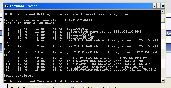

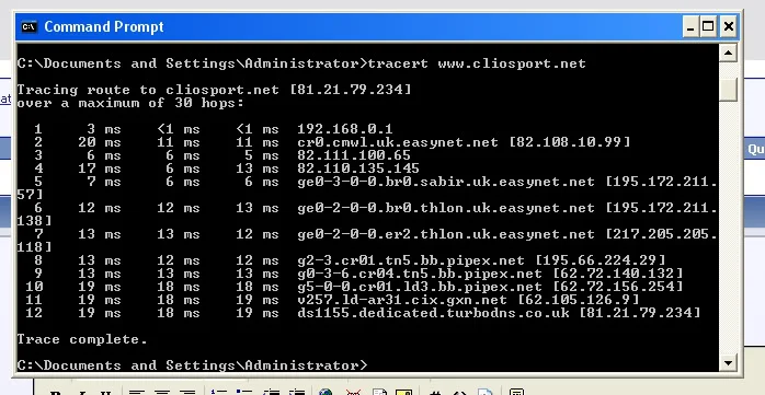

In order to establish if the problem is DNS related try this quick test. Open the comand prompt and type "tracert www.cliosport.net" -
If your DNS settings are fine your result will be similar to mine above. If you get errors repeat the process and type "tracert 81.21.79.234" and see what result comes back.
