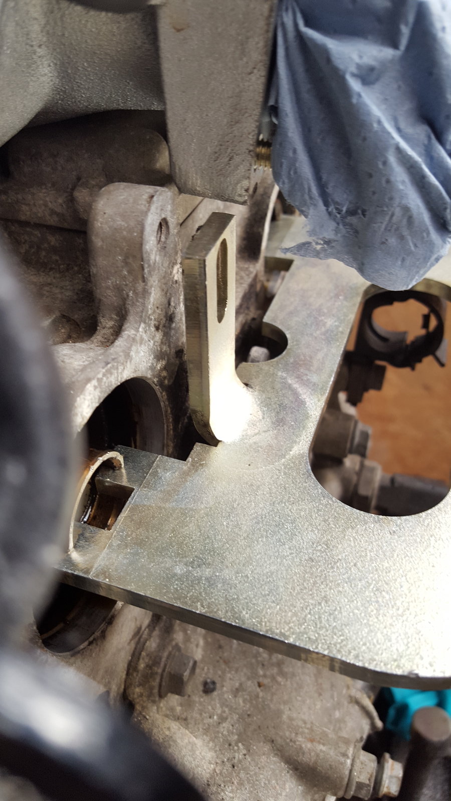

Yea that worked lol cheers you are being such a good help I was going to drill a new hole for it and bolt together lol but it's way too long as it leaves a big gap as in picture think I'm going to return it and get a better one

Hi everyone I have managed to change the belt but when manually turning the engine over I hear a faint tick I'm not sure if it's normal or there before but I don't want to go to the effort of putting it back in the car only to fine I have to take it out again can anyone help with this cheers
I suppose one question is if I was one tooth out on the dephaser would this cause that noise
it's not really a case of being 'one tooth out' you 100% certain crank was locked correctly?
Well yeah I had the locking tool in and the cam horseshoe and the flywheel mark in line with 0 but my horseshoe cam lock is slightly bent and I mean slightly not enough in my opinion to be out on the dephaser by one tooth think it's just the cheaply manufactured
Ah I have just spotted my tensioner mark was out so I just adjusted it but it became loose it seems I have cracked the thread so it won't tighten properly so need to get some threaded bar to replace it now maybe the clicking was the tensioner loosening off very strange as I never horsed it up
