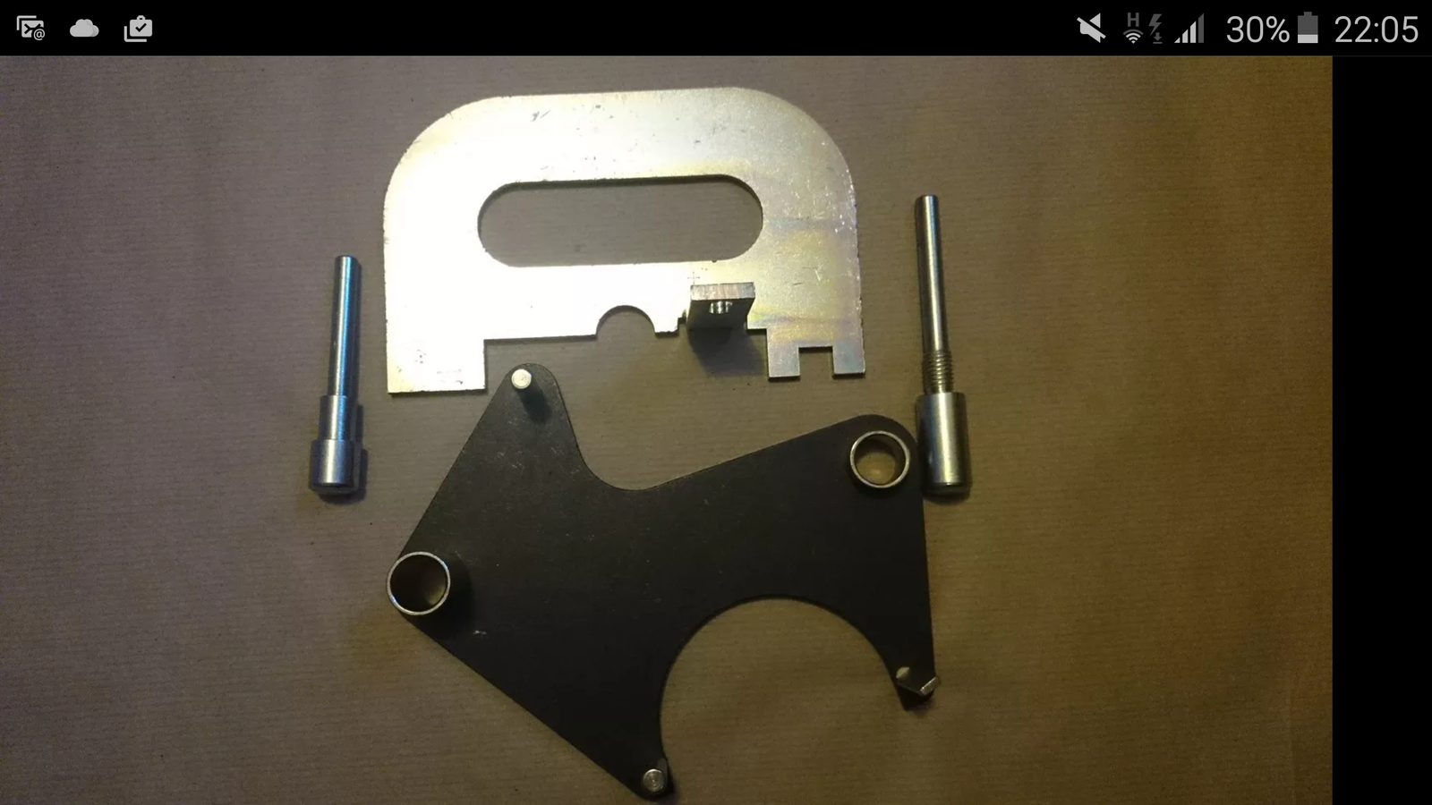

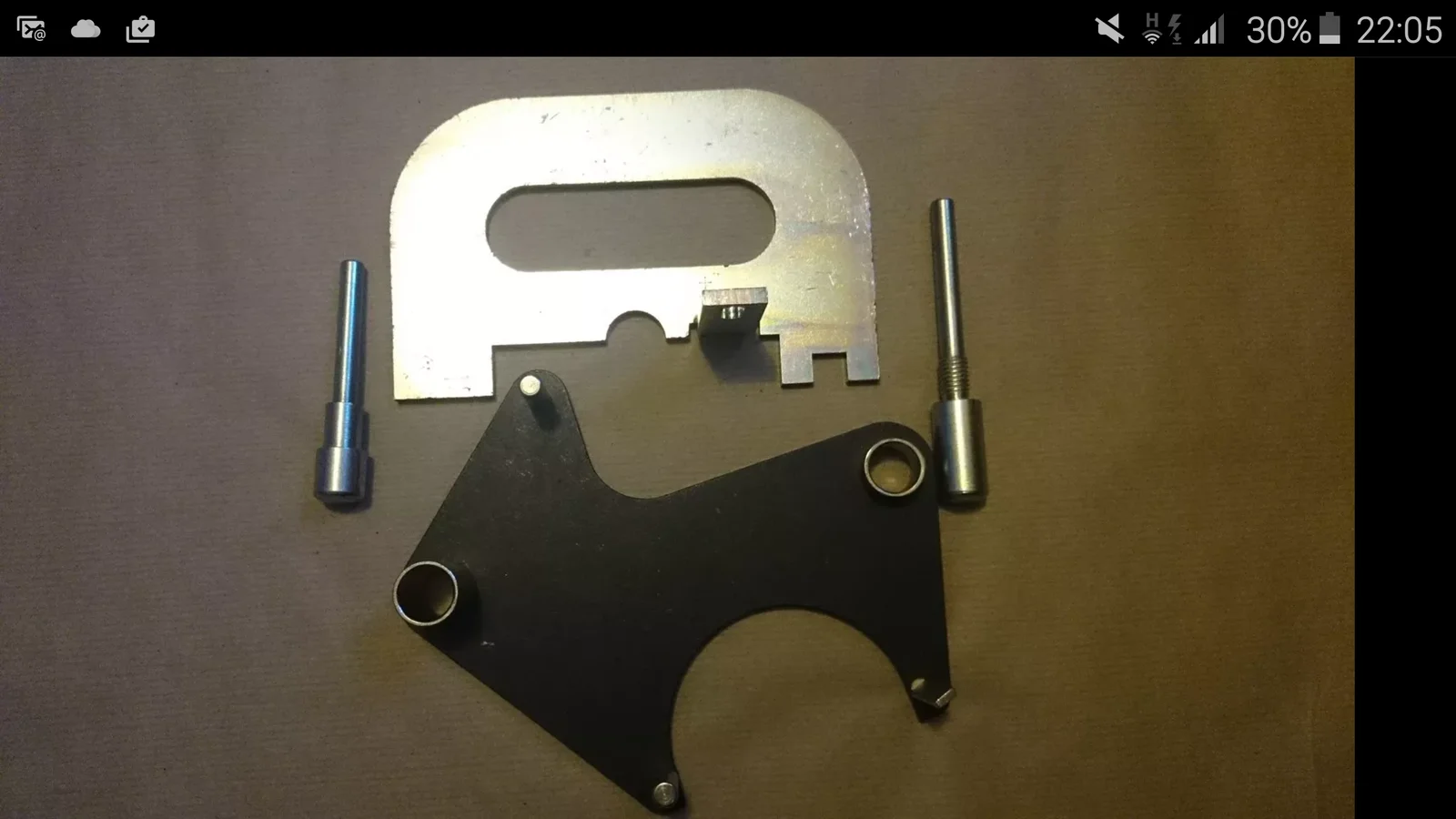

Is this right for 172 ph2 on eBay
262170995422 I have just bought it but just realised its different to the forum pictures

Yeah I agree shame about those tools maybe someone on here could hire them out which would be a fantastic thread anyway getting back to my original post does anyone know if the tool I have bought is the wrong one it looks to me like the 1.4-1.6 version but the advert definitely said f4r

Also I take it the original tools would have a renault stamp on them to identify as original renault
GrahamS
Yeah it looks like the right tools. The large plate should have a load of cogs with it. The horseshoe is the one that bends.
Yeah they are easily identifyable as genuine items but don't come up for sale often at all and when they do go very fast. Horseshoe is on backorder currently.
Paulstewart20
  Clio sport cup 172
Are they essential as there is no slots for them
  dan's cast offs.
the pulley locking tool you've shown doesn't work the same way as the reno one, it locks the pulleys with the pegs. not sure how well they would hold though?

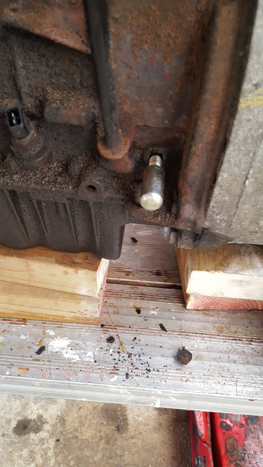

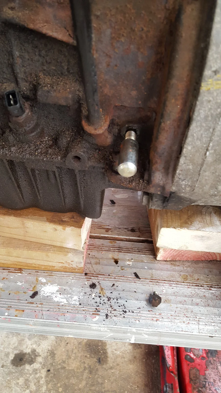

I have just fitted the fly wheel locking bolt but my camshaft slots are not horizontal but fractionally out does this mean my timing was out! So if the slots are supposed to be 3 and 9 o'clock (horizontal) mine is more like 2 and 8 o'clock does that make sense
  dan's cast offs.
make sure you're in the right hole with the crank pin!! check the timing mark on the flywheel first.
Paulstewart20
  Clio sport cup 172
My pin is in the hole next to the dip stick but not sure about the flywheel timing mark it does not mention that on the guide it just says turn over engine till pin fits in crank and cam shafts are somewhere near horizontal so that the cam tool will slot in but mine won't obviously as not lined up
Paulstewart20
  Clio sport cup 172
I see the hole and the marks on the housing but span the whole thing I could not see what was supposed to be lining up on the fly wheel it was early this morning when I looked maybe I was tired and it was obvious
  A special one.
Whip the plugs out and put a screwdriver down number one.
Turn the engine over until it gets to tdc, the crank locking pin should then fit in the correct slot.

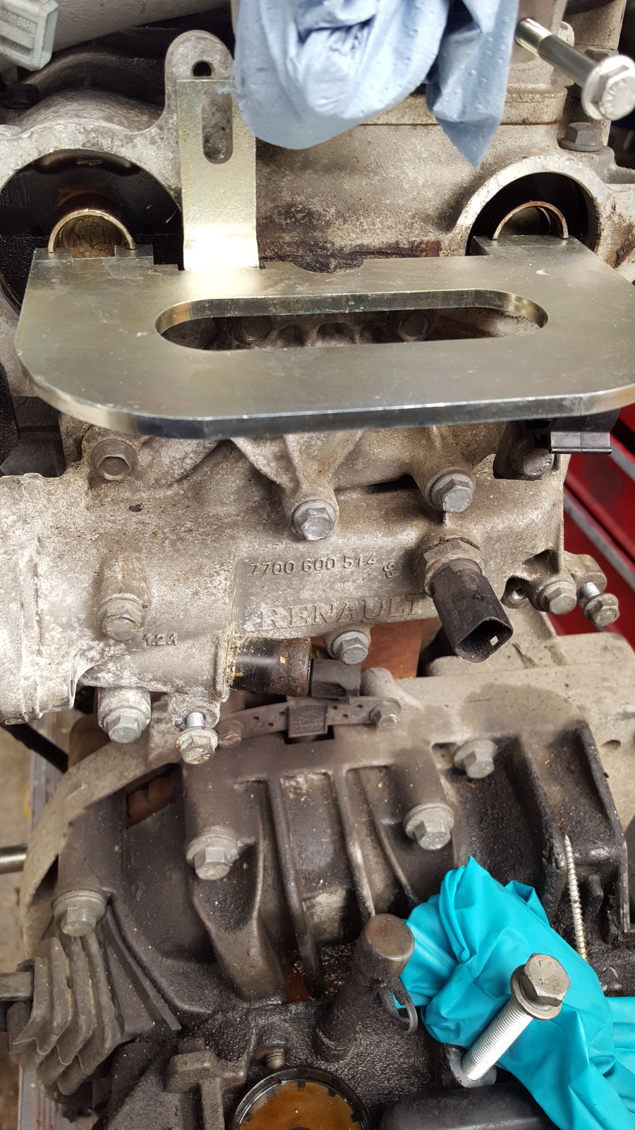

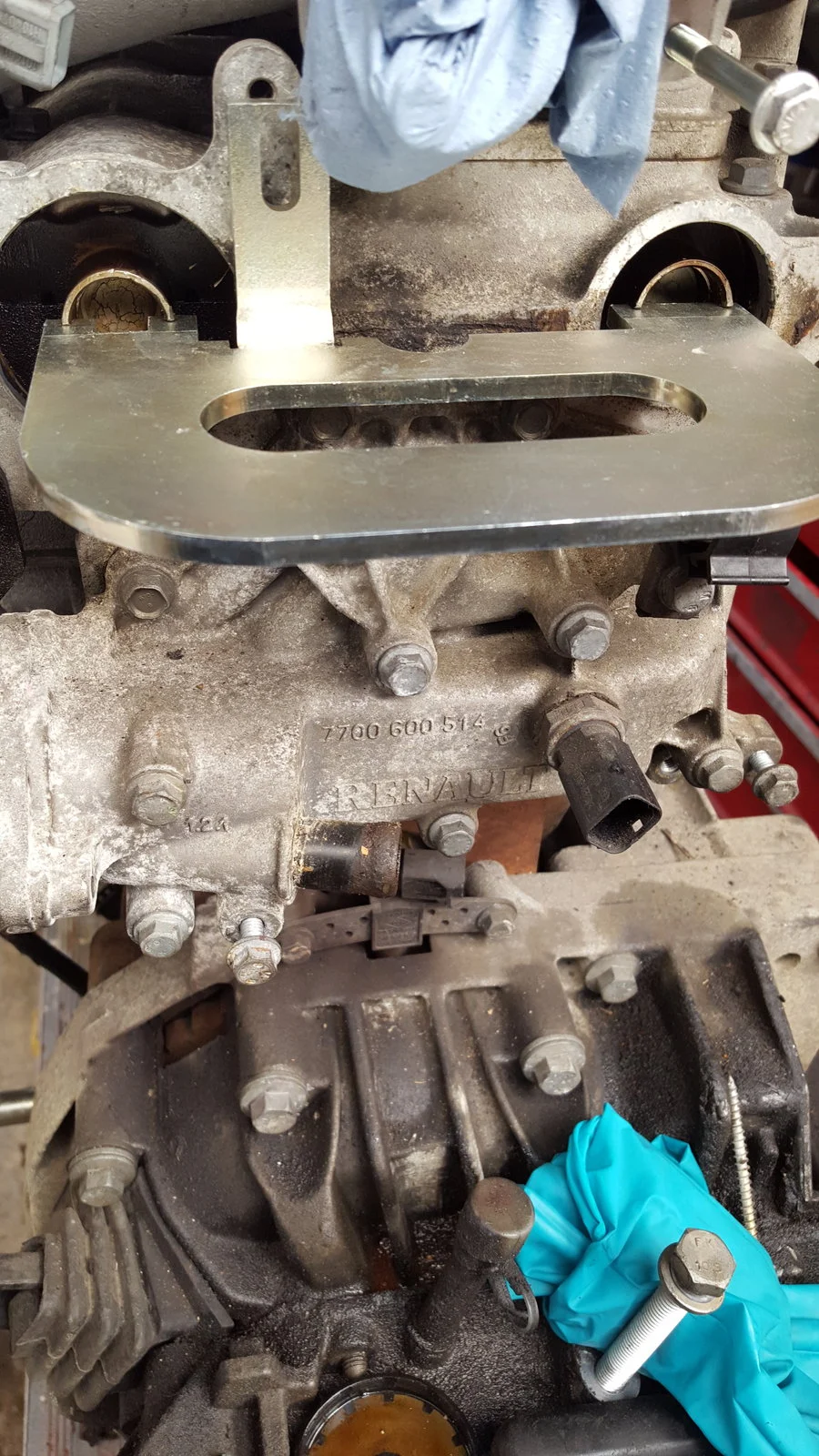

Ok where should the line be either linked email in view and camshaft lock in place the fly wheel bolt next to the dip stick won't go in fully will try the spare plug way as soon as I find the right socket
Paulstewart20
  Clio sport cup 172
This one shows cam shaft tool in and line on flywheel in view but flywheel bolt won't it needs to spin a bit more but then the other two are way off

wrong crank pin, the screw in one is for the k4m engine, the f4r slides in.
ignore the cams for now, crank needs to be locked first regardless of where the cams are. also your cam horseshoe should bolt to the cam cover but it's way to short to bolt up, you can see in the pic where it should bolt to the cam cover.
flywheel mark should line up with the line with 0 on the gearbox/bellhousing. not got pic sorry.
