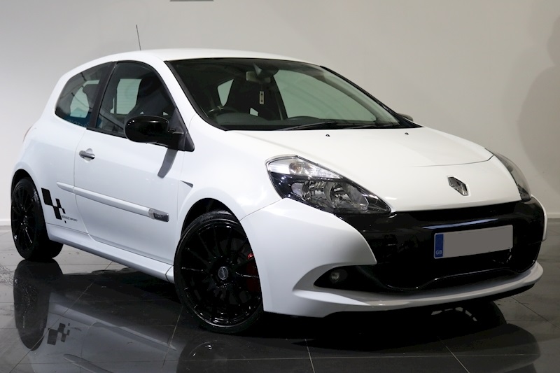

P.S. Car itself is shown below/attached :)

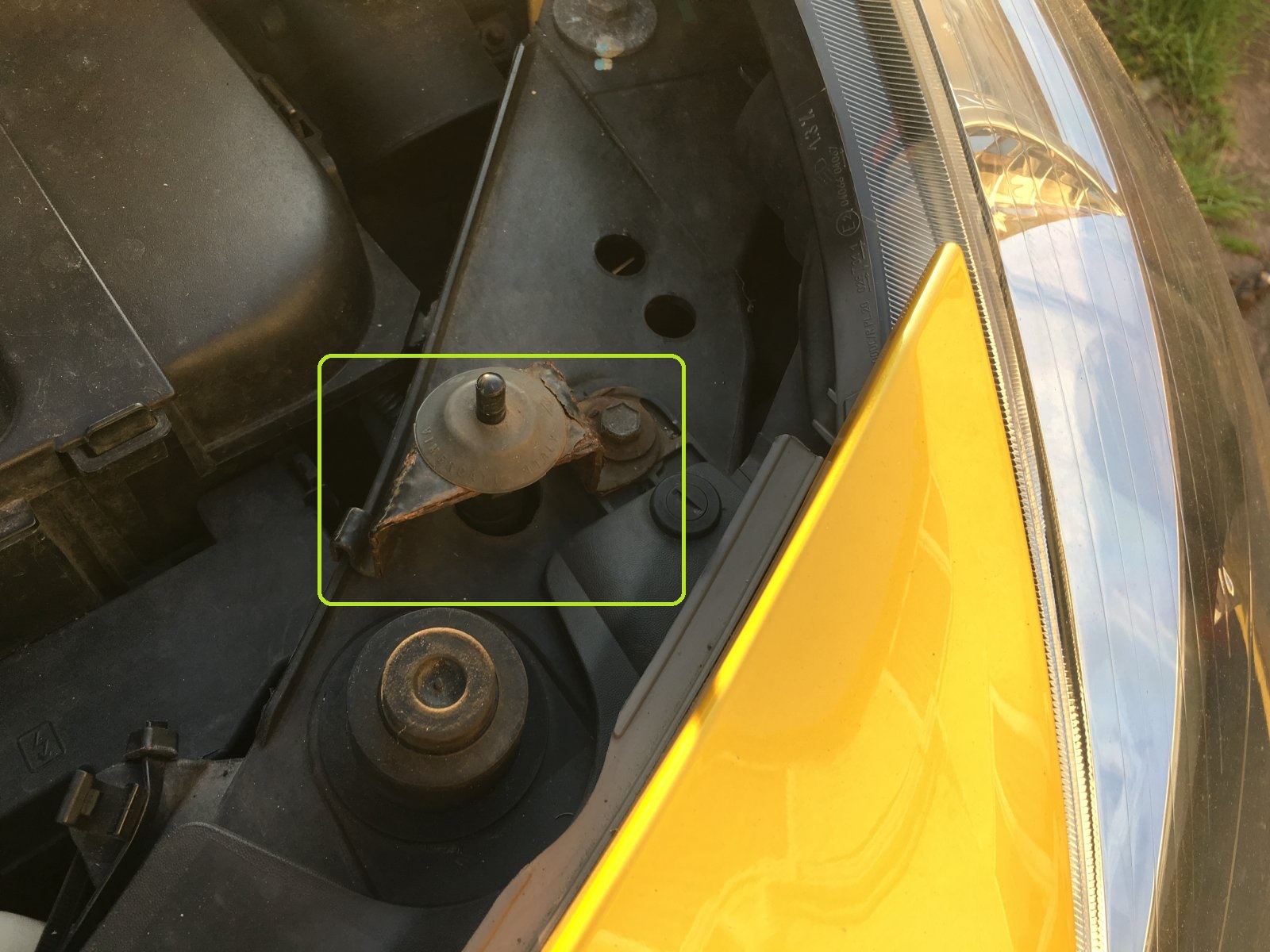

I believe the bonnet shut sensor on my car is missing completely, can someone advise as to the part number for it? It is the part highlighted in green in the attached, many thanks!
Dave

2. probably need an alarm sensor on top of the slam panel. About an inch circular with a springy nipple.
