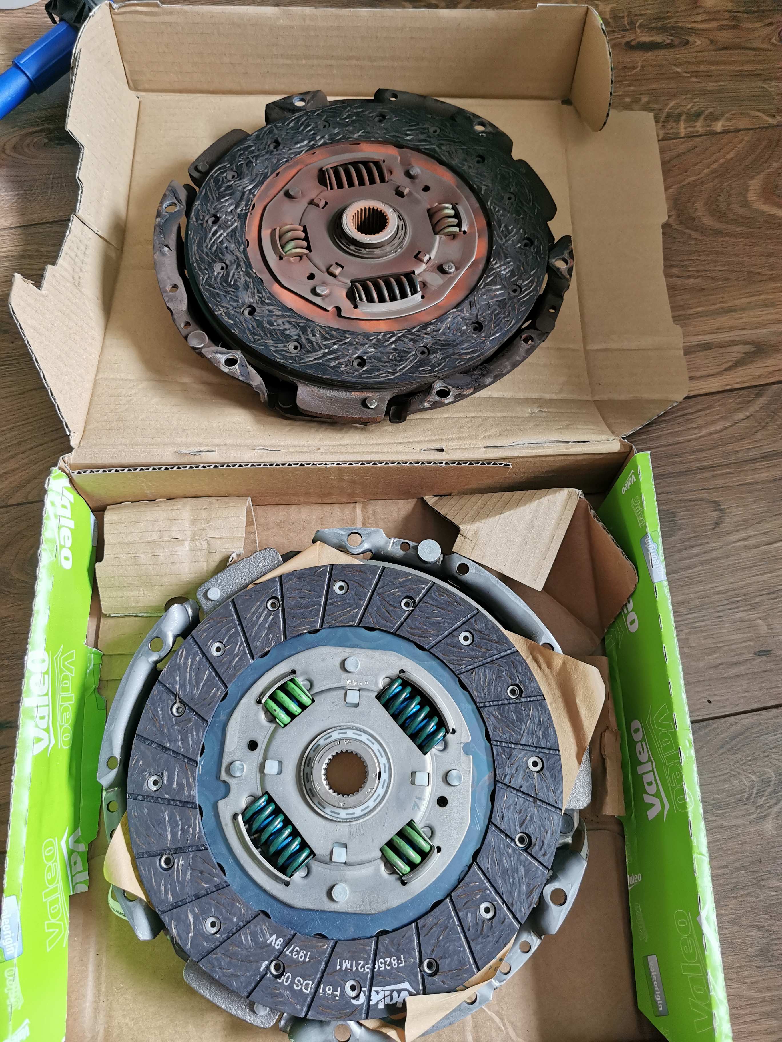

Hi.
After a new clutch. Valeo or Luk? Which is best?
Been given part no as follows
7701476557 Valeo
7701478115 what is this?
TIA
Clio_fool
I put a valeo in mine a couple of years ago and it worked.
