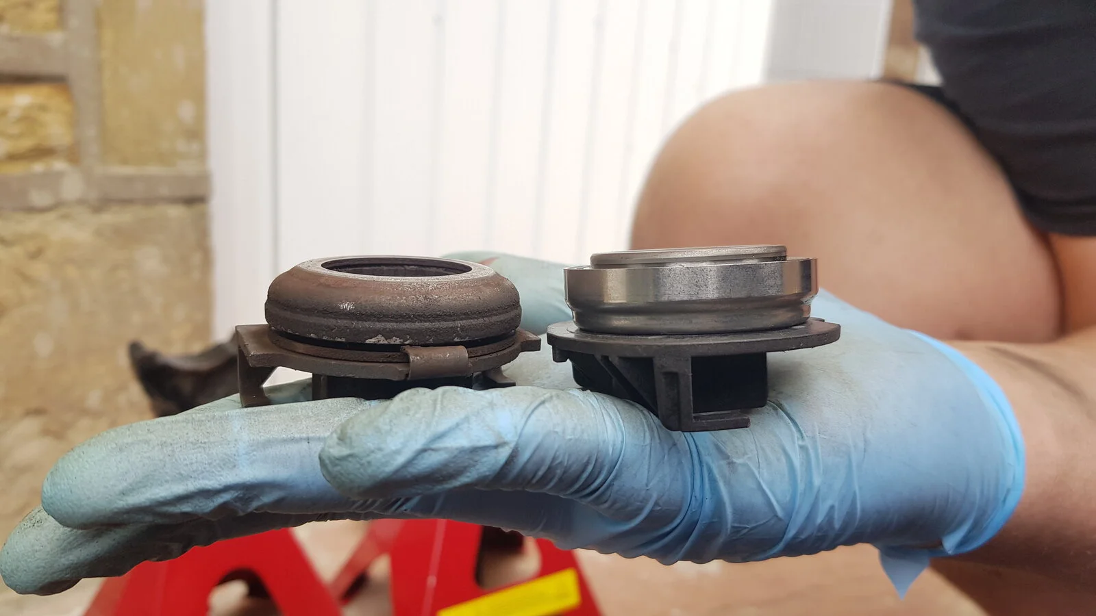

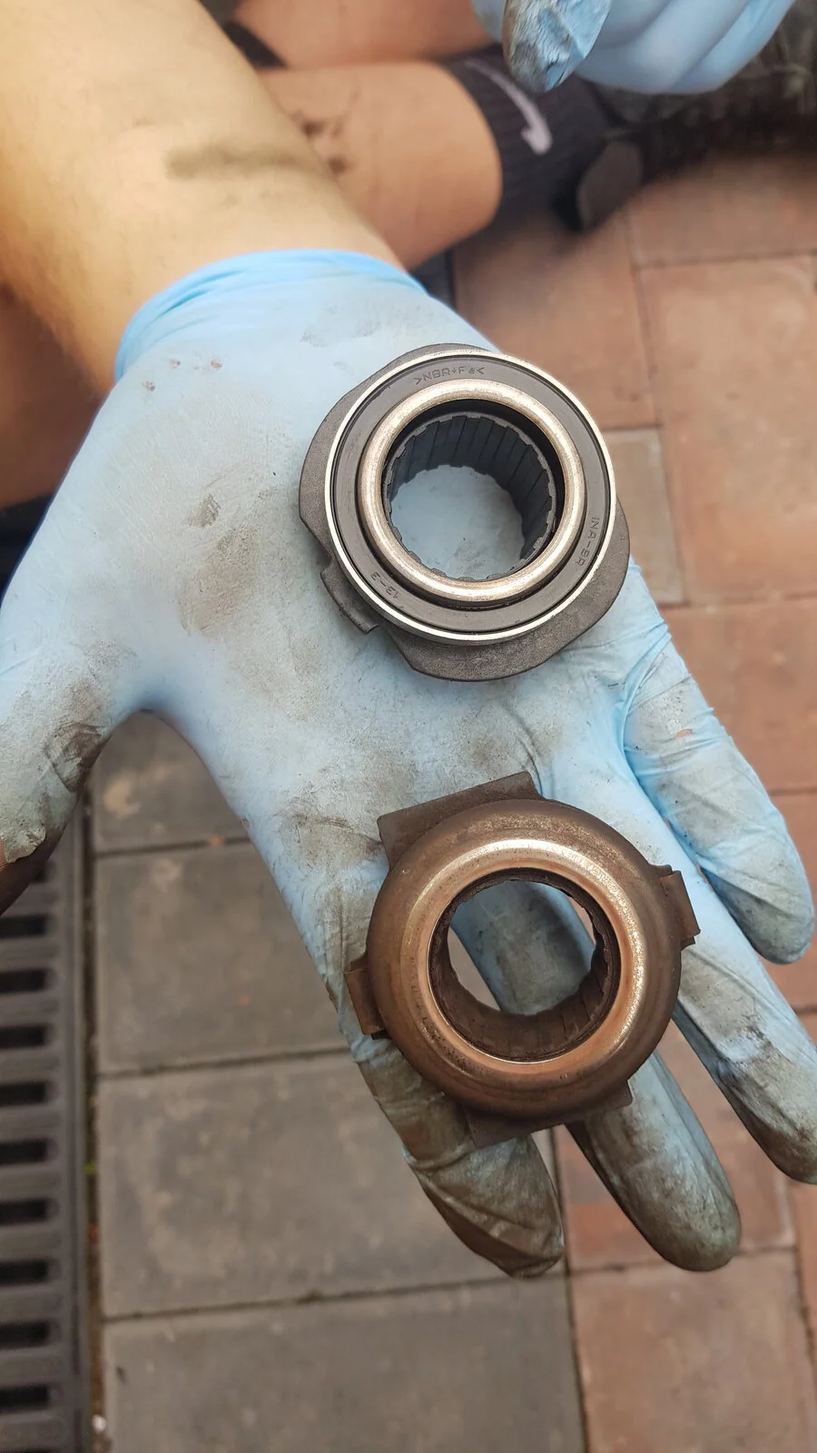

So the clio had a new gearbox and genuine valeo clutch fitted. Ever since the clutch biting point has been pretty high, higher than it was before.
I have tried disconnecting the clutch cable and resetting the clutch adjuster by pressing it loose a few times but it didnt help.
Any ideas? The release bearing was slightly different to the one that came off, but unsure if this would make a difference?
I’d say that’s deffo due to the release bearing. The new item appears thicker in profile which is why the pedal would be higher at the bite point. The pedal needs to move a greater distance before the bite point is achieved.
Assuming a non genuine release bearing?

Genuine with the Valeo Kit, we weren't keen on fitting it due to it being different but seems this is the updated design.
