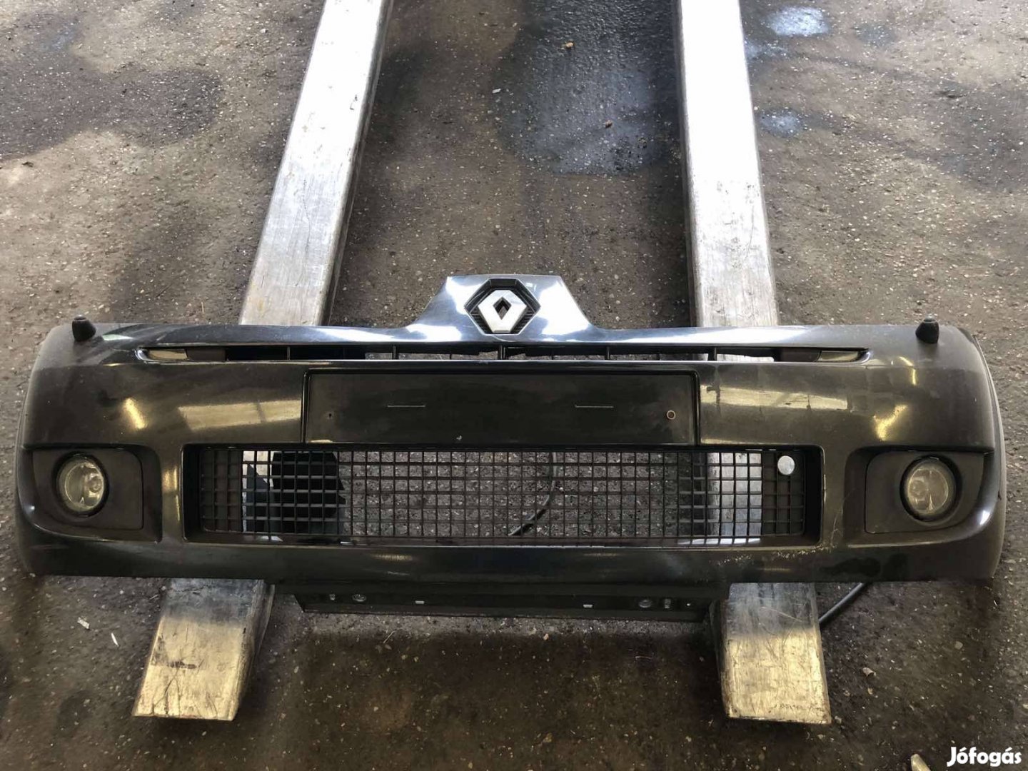

Does the Clio 172 or 182 ph2 front bumper fit on my 2003 Clio ph2 1.4 16V (5 doors)?
I'm pretty sure it fits but I just want to go for sure before purchasing one. Pictures attached below:
The bumper in question:

Yes, but you'll need the 172/182 front wings as well for the bumper to clip into.
Then massive spacers/low offset wheels to bring the front track width out so it doesn't look stupid.

Okay thanks for the reply!
So basically the 172/182 front is wider, right?
