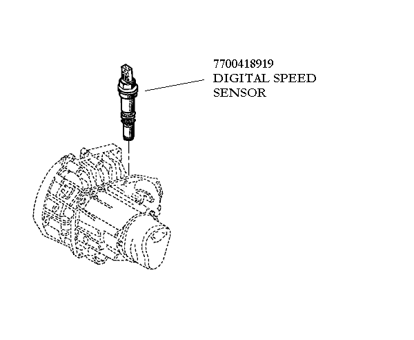

You need a JC5 129 with an digital speedo sensor in the casing

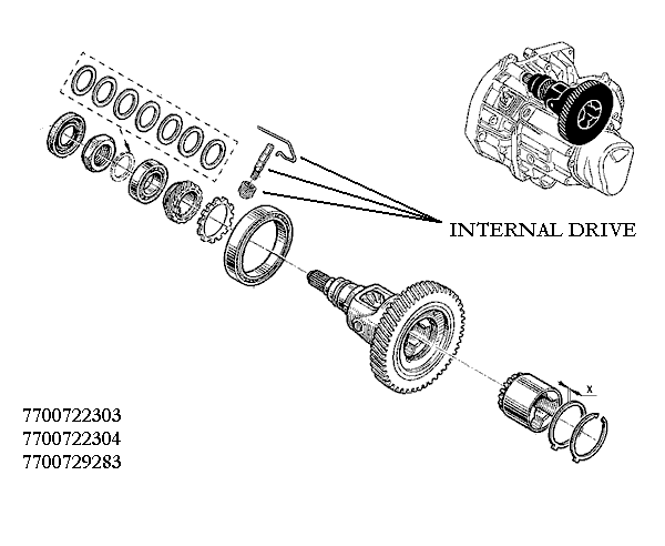

  MERCEDES CLS AMG
These pics may help

It's definately a speed sensor. The hole is there on the casting of the 130 but it feels tighter and there isn't a plastic bit inside like the 129's.
