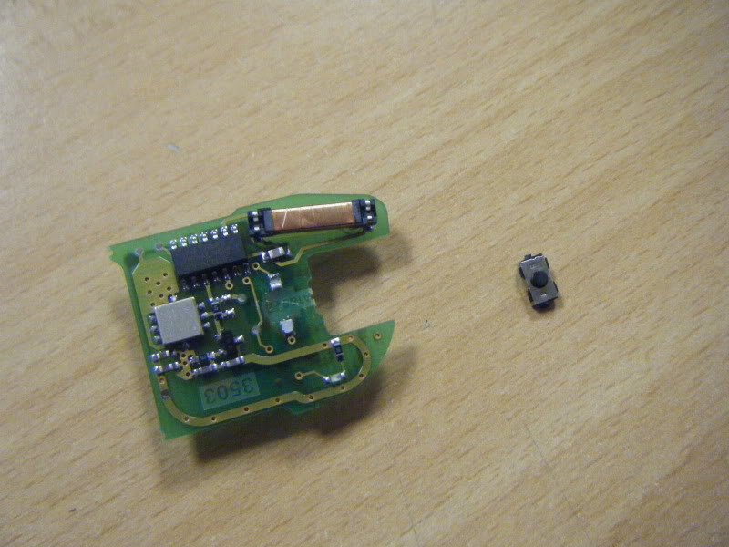

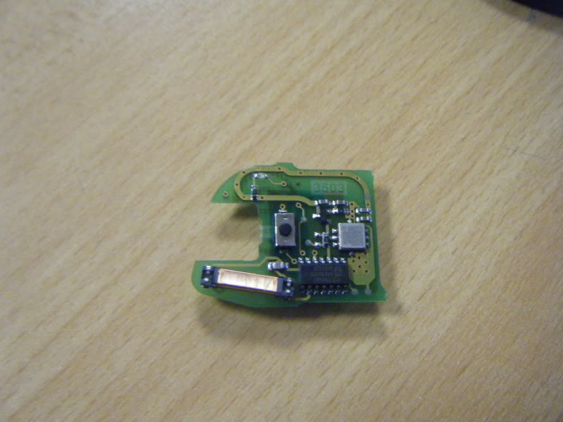

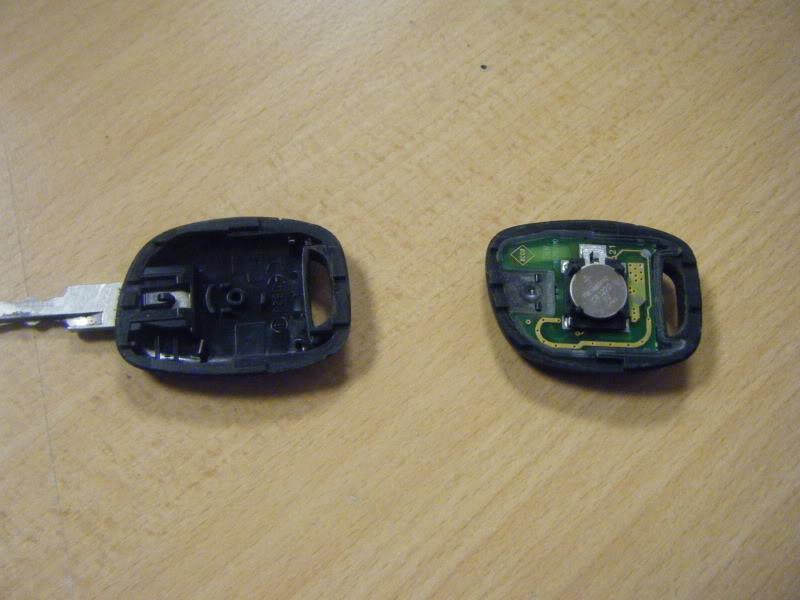

The micro switch on the circuit board has come off - split the key and solder it back on. It should work perfect after this.
New keys cost £120 + vat supplied and coded - repair this one then if you wish order a new one from Renault

Replace the battery and see what happens, if that dont make any difference, go from there.

haha. So if it doesn't even click... how's it gonna be the battery?! The "micro switch" came off my spare one.
working in Renault parts as i do, it will definitely be as Matt has suggested, the switches are common for coming away from the circuit board, it WILL be this
be careful not to lose the switch when you open the key

OP open the key up and see what you find, if it is as we think, give Matt's suggestion a try all should be well.
