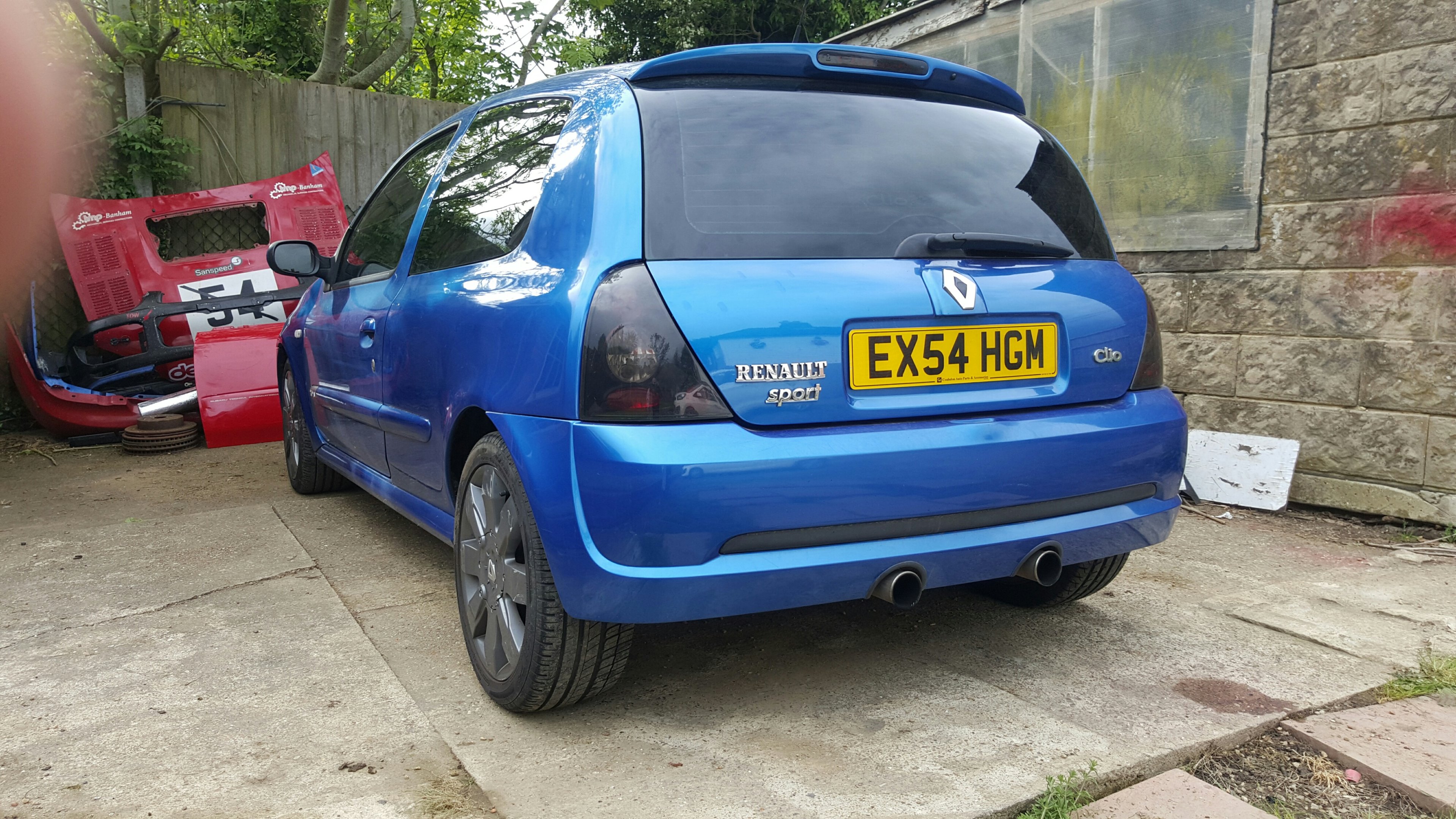

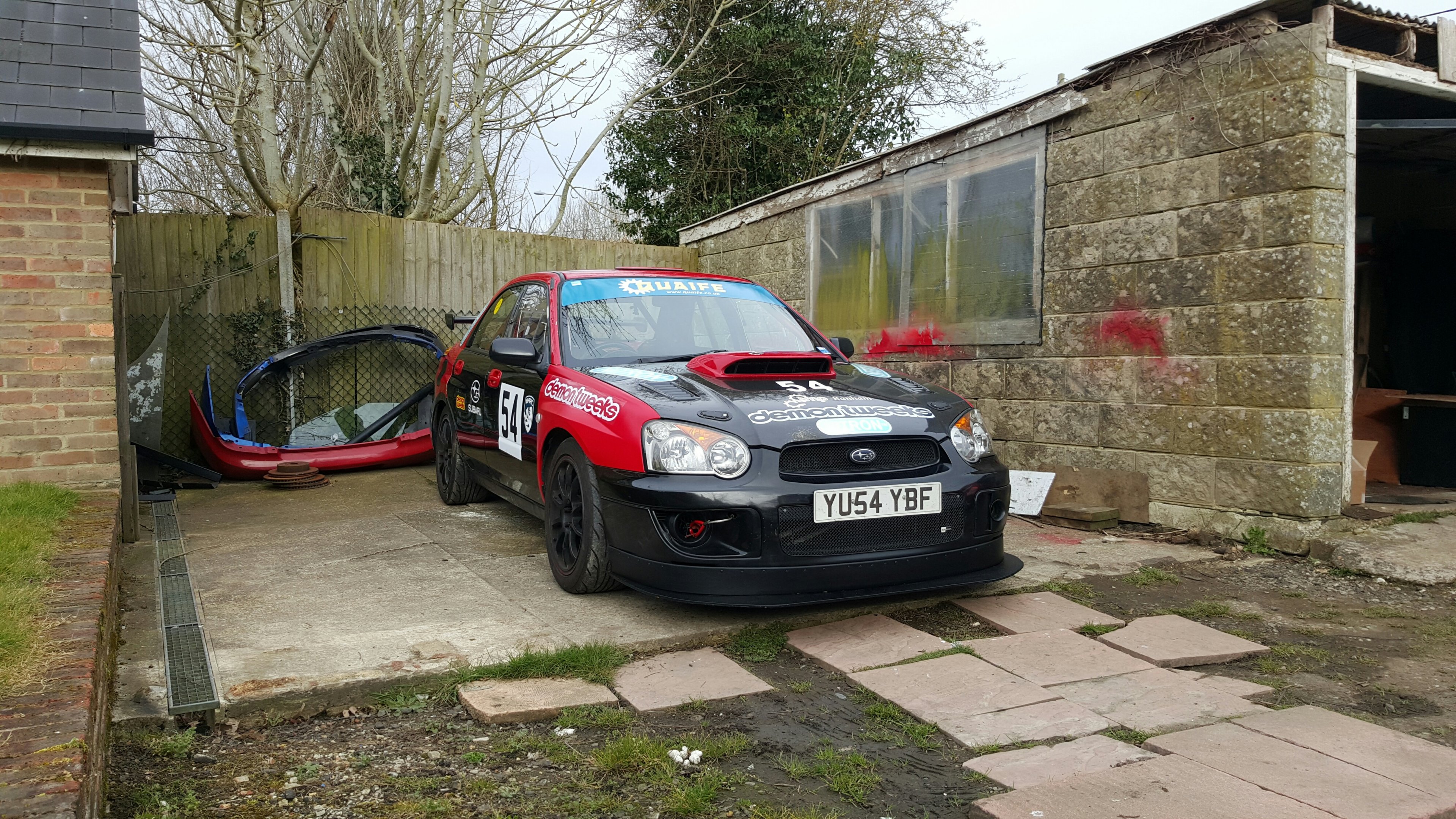

I only have this picture of the car at the moment and also one of the car it's replacing!
I'll get some more pictures at the weekend
