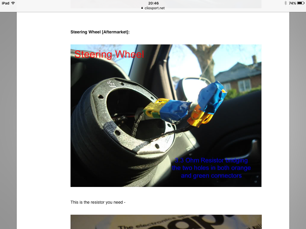

If it's an aftermarket steering wheel with no airbag you can put resistors in the wiring circuit to trick it.

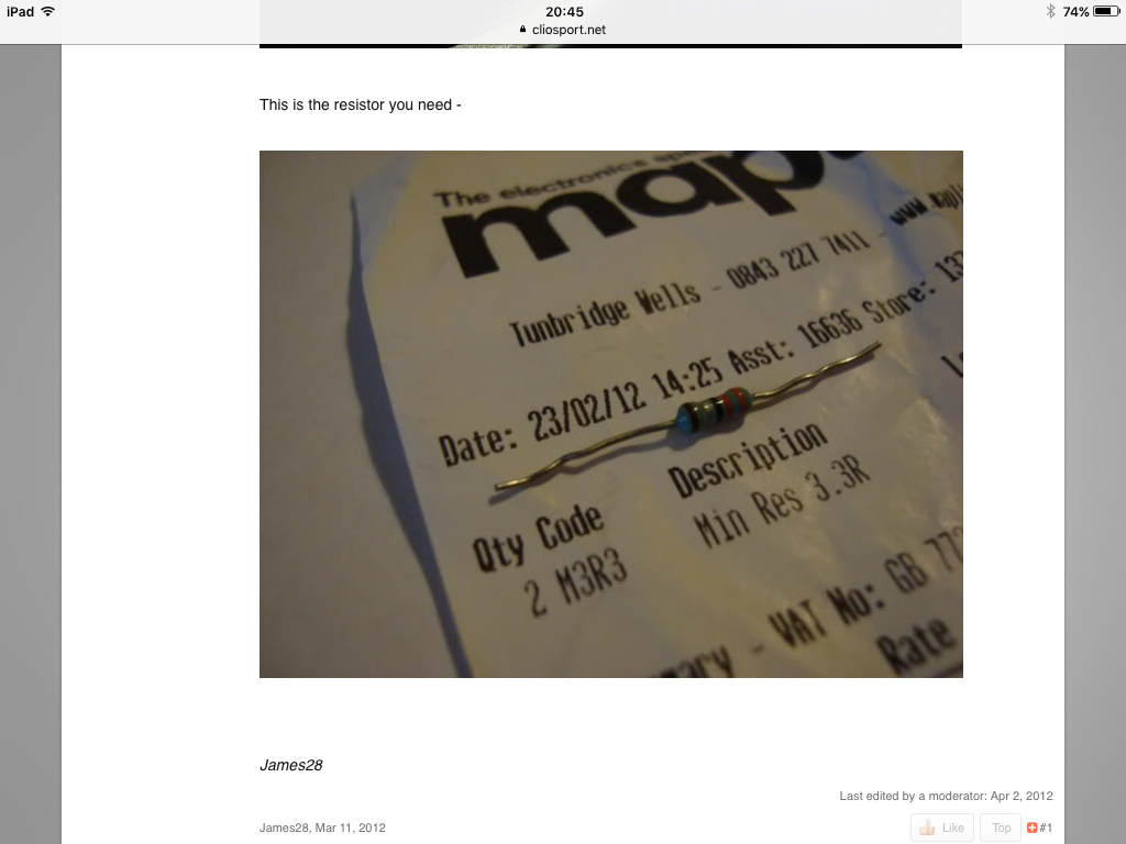

Two 3.3 ohms resistors from Maplins mate as per the photos below:
