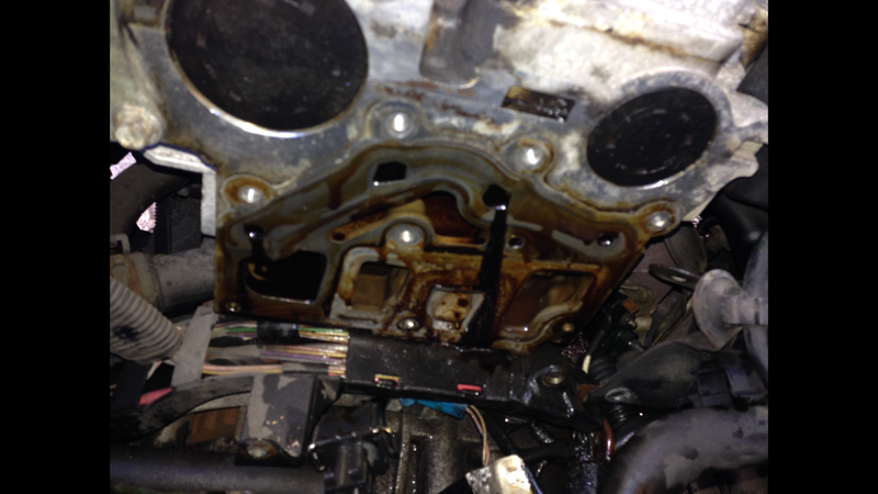

On my brothers old ph2 1.4, he was using water up,
Changed the thermostat, housing and temp sensor as it was all complete, and solved the issue,
Dont know if its the same engine in a ph1, theres little oil galleries that flow to the thermostat to cool the oil (at a guess) and the coolant in the 1.4 was turning dark, as it had a minimal amount of oil and water mixing,
New thermostat housing, oil change and coolant change and its been great
Edit: found a pic
In the housing theres a few seala that stop the two mixing, the seals on the old housing went flat and mixed
Ok. Will try changing them. Thanks pal
