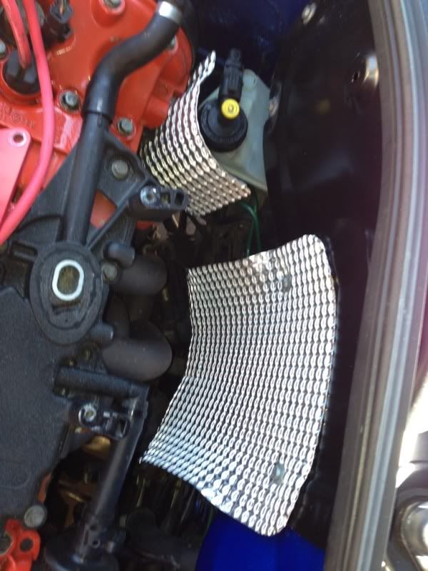

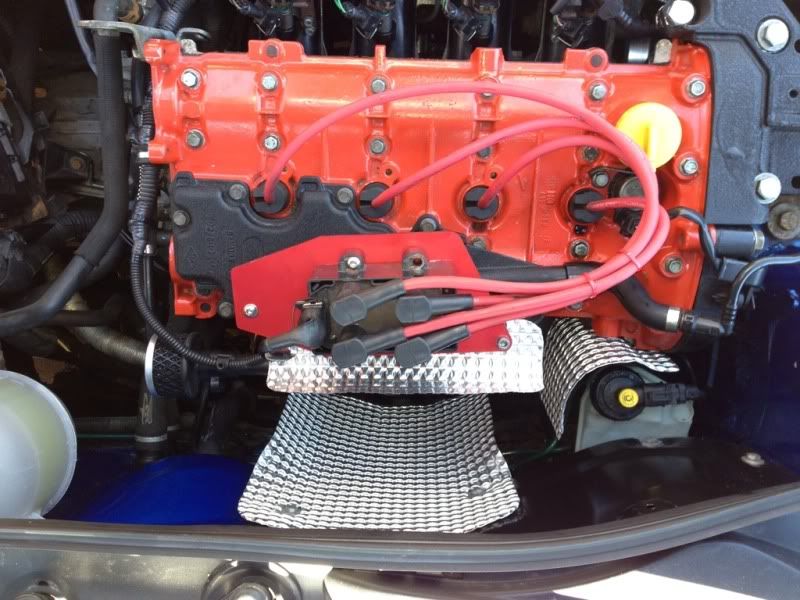

As seen here
I bought it in a bundle of other things - I am sure they would sell it separately though?
I'll drop them a line. They probably just buy it from the same place as Demon Tweaks though and sell on with a mark up ;P
500x500mm is plenty, you'll find uses for the rest in a racecar. You are better making two heat shields rather what you have pictured.

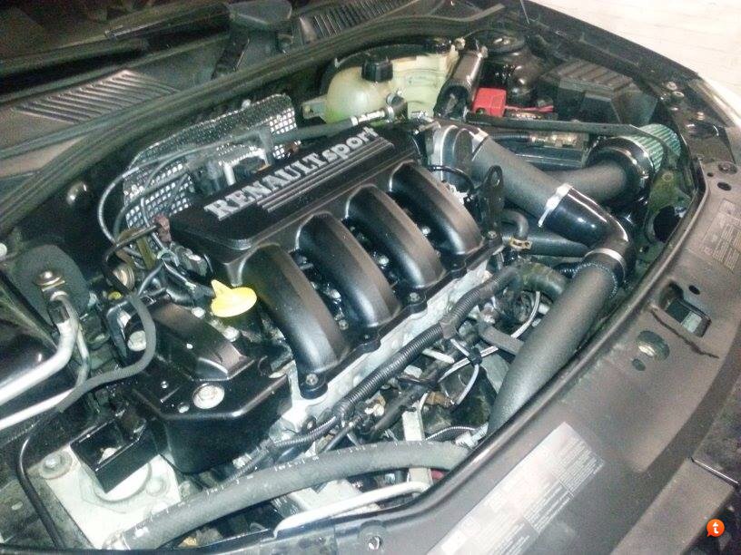

Something like this.
http://i142.photobucket.com/albums/...C591C0D4-118-00000089F5A573C4_zps11978e87.jpg
http://i142.photobucket.com/albums/...38FE4828-118-00000089EEC33935_zpsf29ac104.jpg
Thanks, what about the brake lines too though?
I wasn't sure if the general 500x500 odd would be enough but now I know, cheers.

That one I made is only like 350mm or so, you could just make it bigger although I never had bother with that size on track.
