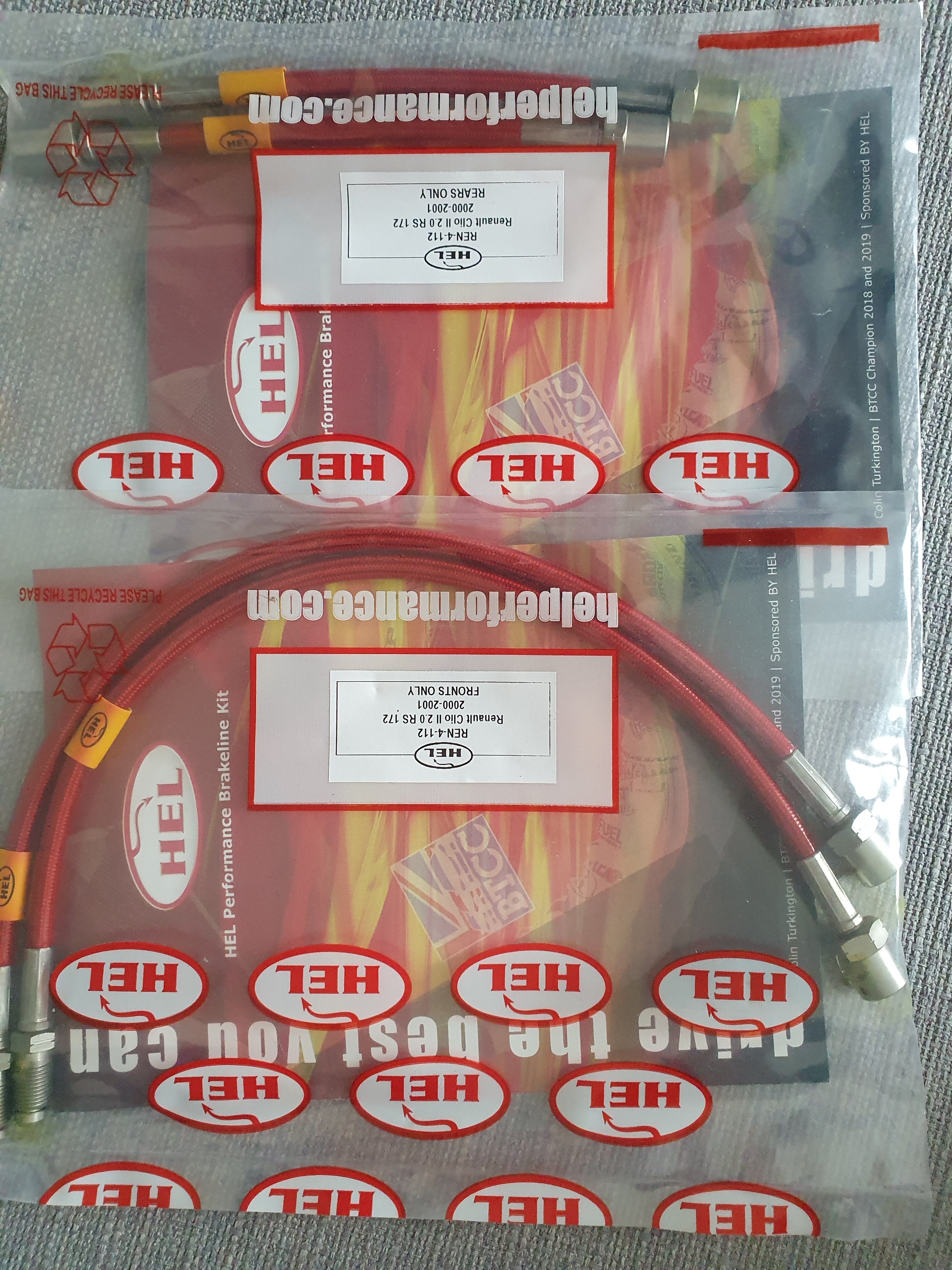

I purchased these HEL Brakelines from Kam Racing...amazing service and speedy delivery! Also love the pack of haribo with my invoice.

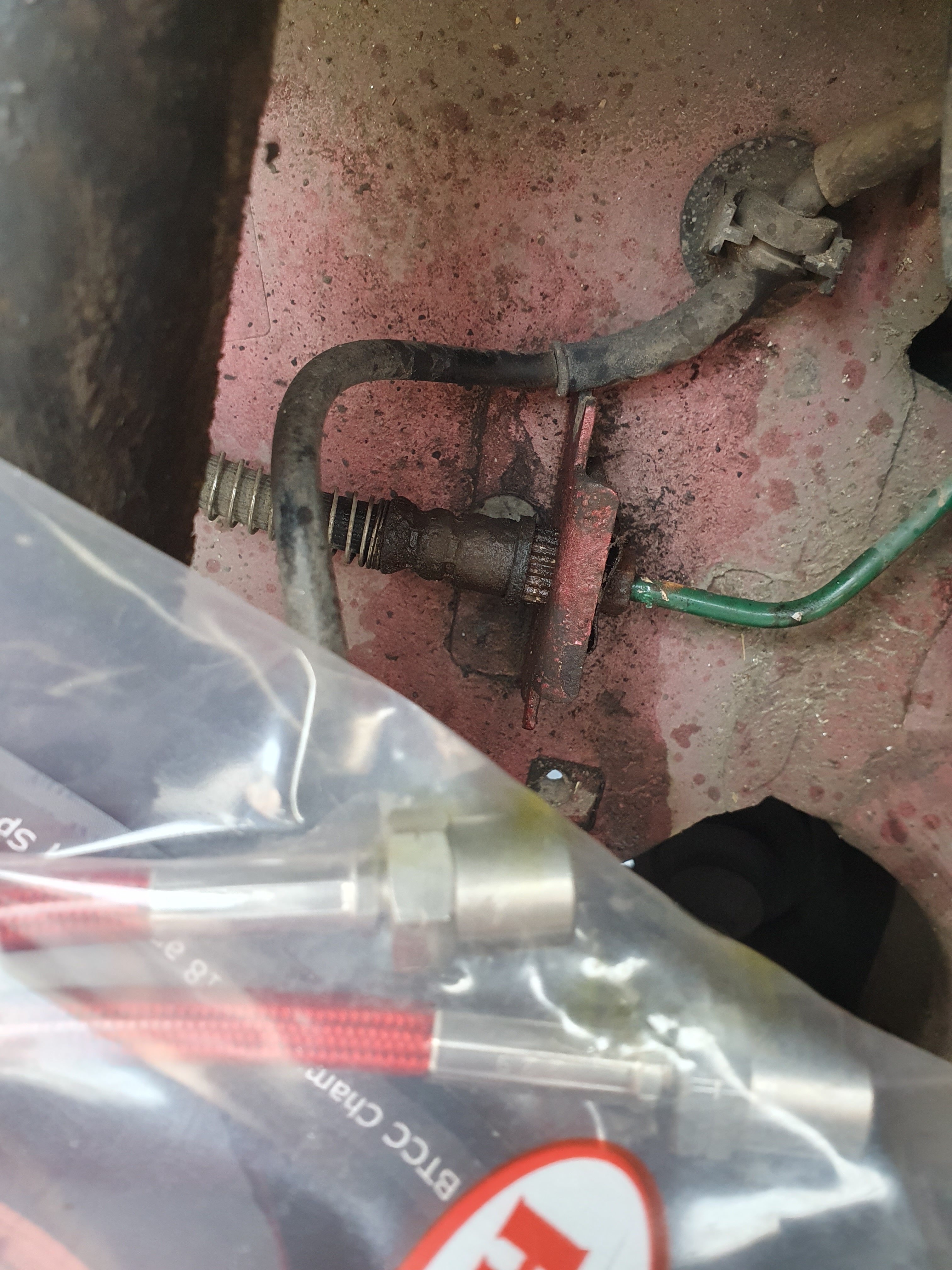

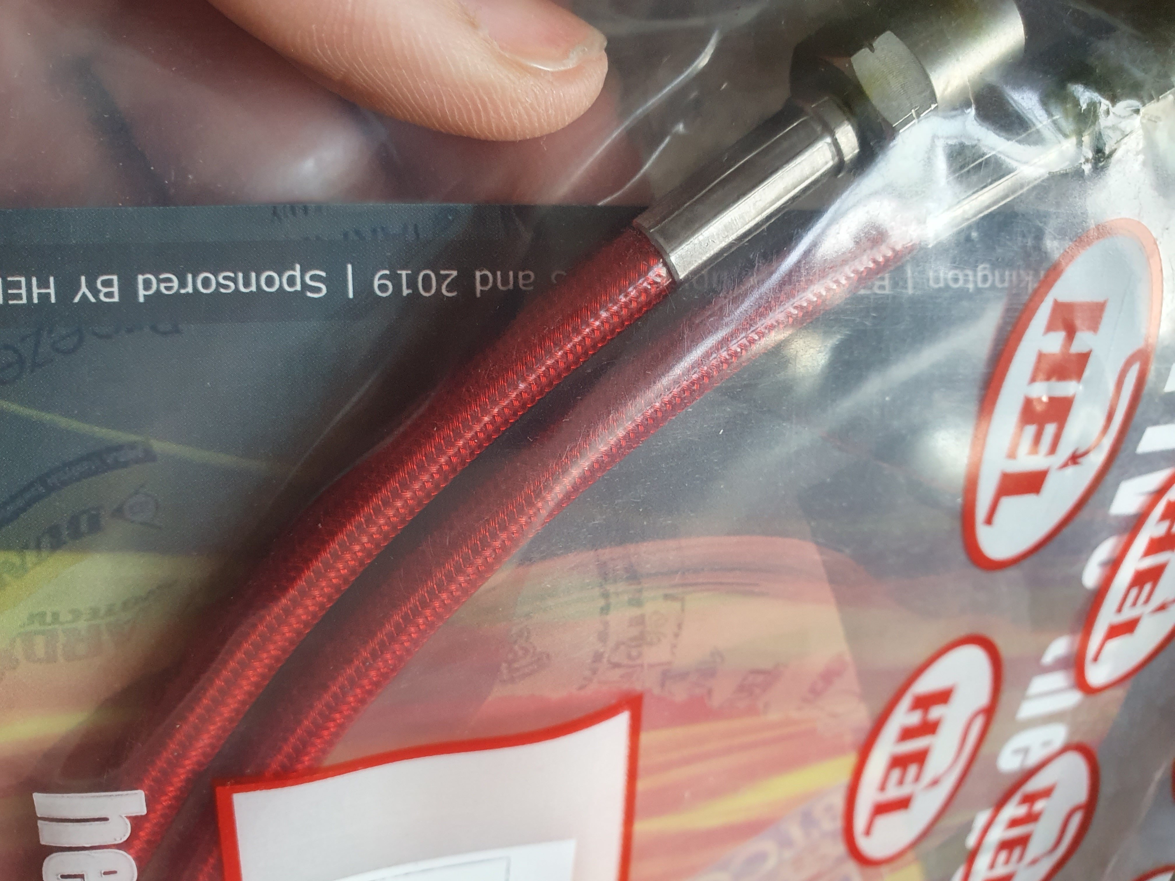

I forgot to ask when ordering if these were the proper ones for my car, (2000-2001 172 - I have a 2003 172)...these were the only ones I could find anywhere for sale so went with them.
Before I actually take them out the pack and attempt to fit, can I get any confirmation these are correct please? The fitting into the bracket on the car looks different.
On the OEM ones the end into the bracket is splined but these ones aren't, just a hex nut.
I don't want to open incase I need to send them back. I believe the calliper end will fit and so will the hardline end, but unsure with the bracket.

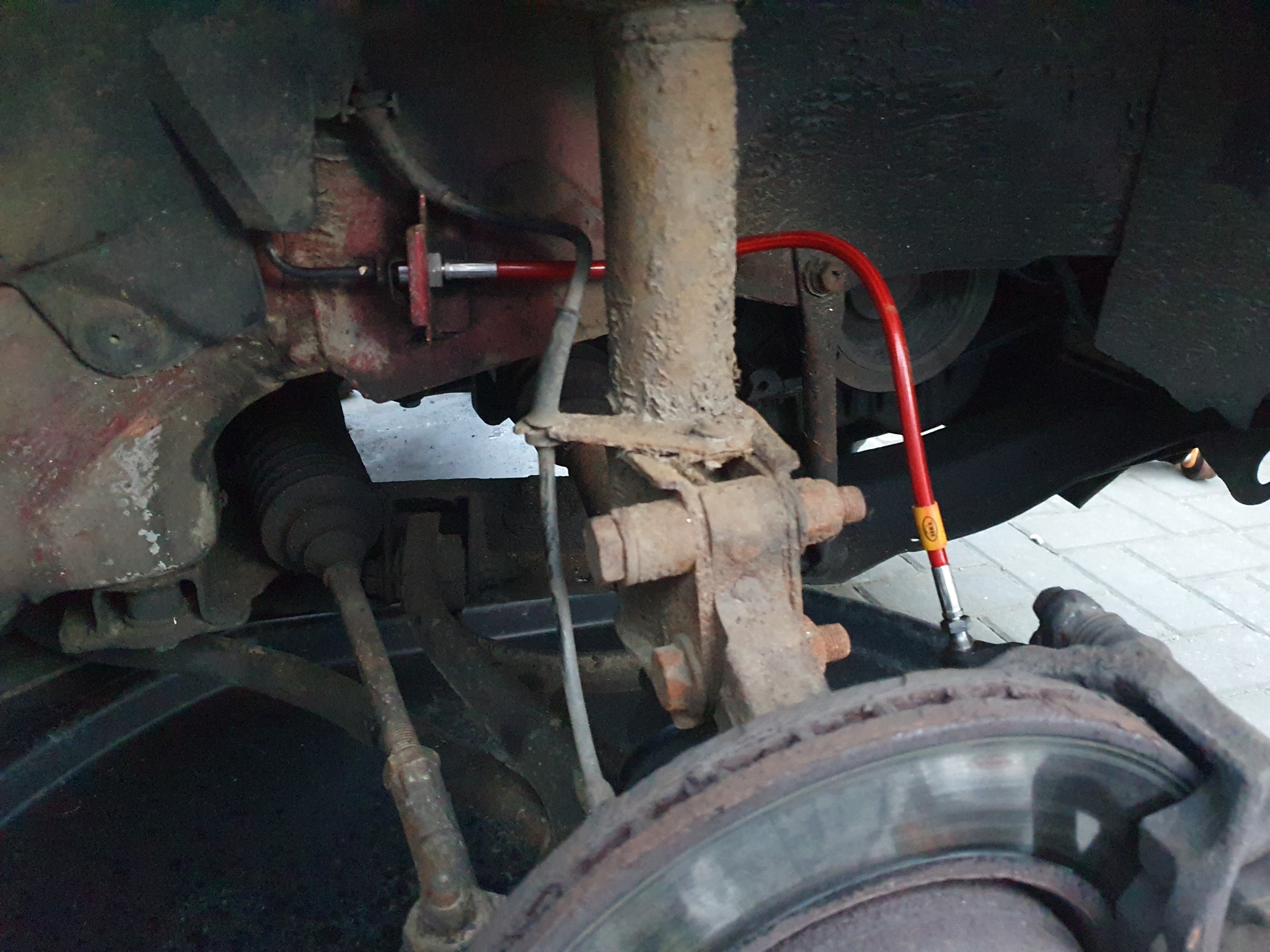

All done! That was easy!!!!
Now to wait to bleed as 1 nipple is 8mm which I have a spanner, other is 7mm randomly which I don't 🤦‍♂ always the way 😅

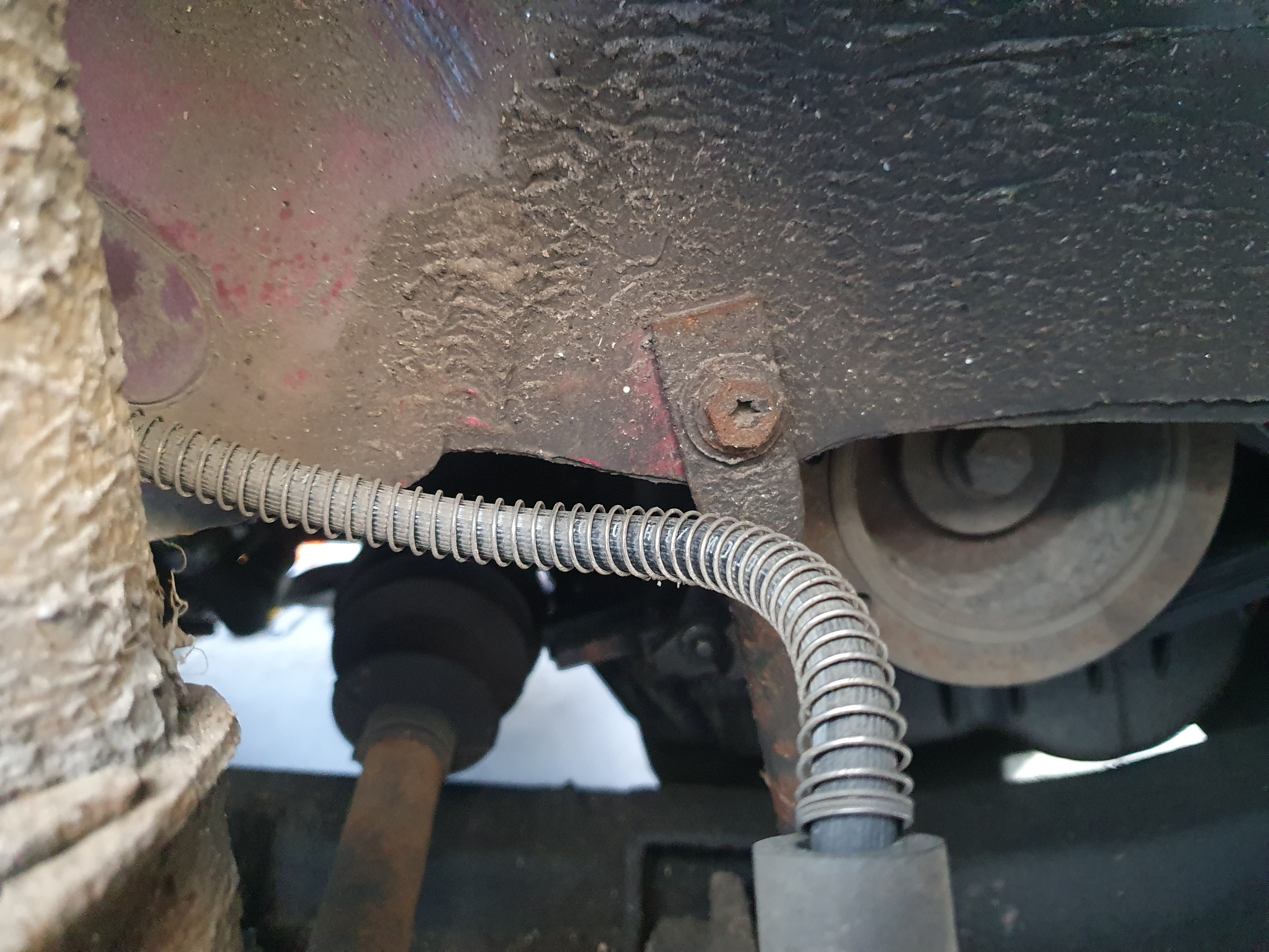

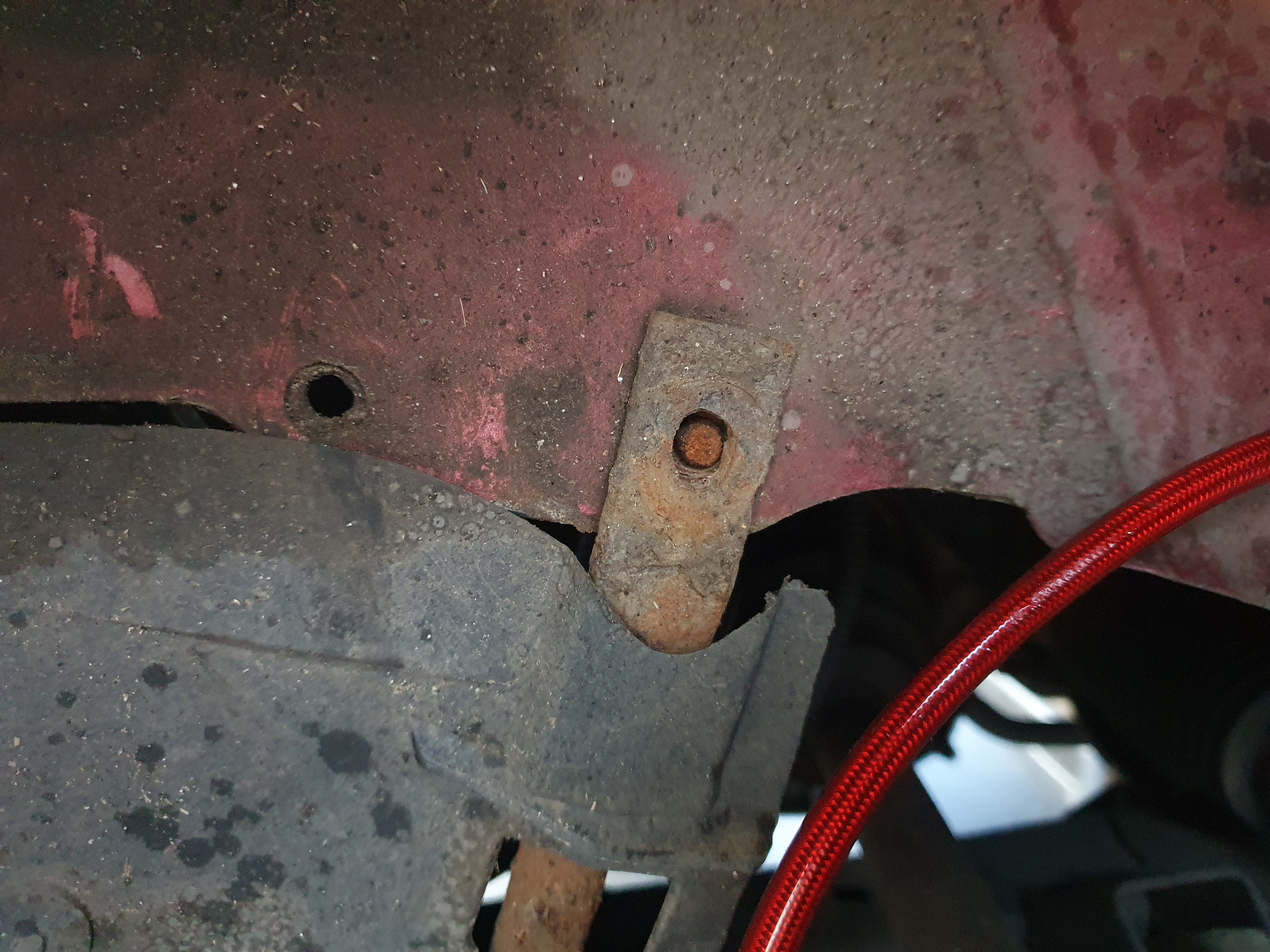

I also noticed I'm missing this bolt which is sheared...not happy about that as maybe by someone who did some work on my car and has kept shtum about it when changing clutch and new caliper...😡 can't prove it as maybe longer than that and never noticed before.
Can anyone give me advise on which bolt I need? It looks like this is quite important as it's the link between subframe by the front of my wishbone and chassis

Have seen that before, is it the same both sides?
Cant remember if they're M8 bolts or not, probably 25mm long.

To be fair id imagine those do very very little (you can see theres no marks where its been flexing and moving)
should be able to drill it out, clean up the threads and get a bolt from a scrappy, or just drill it out and nut and bolt it as you can get access to the other side easily.
