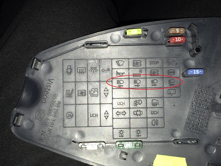

when i turn my head lights on my dash/climate control/clock or window switches do not illuminate. This happened after removing passengers side bulb. Now i can not make that side to work either.
I have checked all the fuses inside the red circle and there are fine. Any other ideas?

Have you tried another bulb ? Is the interior light working ? The one above your head. That's also a 501 bulb . Try the failed passenger side light in there and the interior light in the passenger side bulb holder and see if they both work.
In your pic. There is a green fuse at the bottom . Just above that you'll see two light symbols with arrows . According to the manual these are the sidelight fuses . Maybe try those fuses.
Yep I tried all that. Does not matter what bulb I will put in doesn't light up. All interior lights work except the mentioned above
