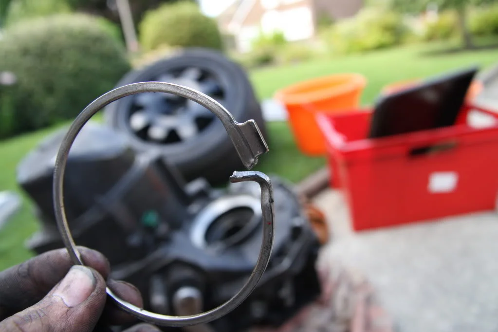

put it in gear, if the speedo goes up and there is no drive its the circlip that retains the diff in the box, can be found behind the n/s driveshaft welly.
Drain the box oil and check for one of these that will probably be loose in the N/S gaitor as said above...
If you find the circlip loose, its sometimes possible to fit a new circlip (in situ) and hope for the best. Sometimes they will just keep popping out though, and the only thing that will fix it is a rebuild or new/replacement box.
