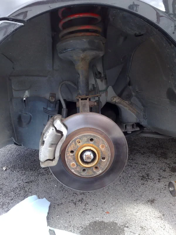

I took wheel off and took few snaps see if any of you's can see anything out of place or f**ked up, cos i cant!

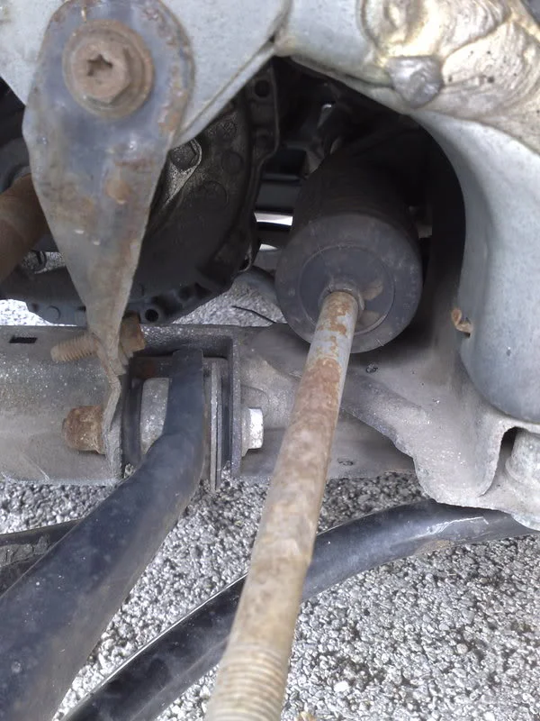

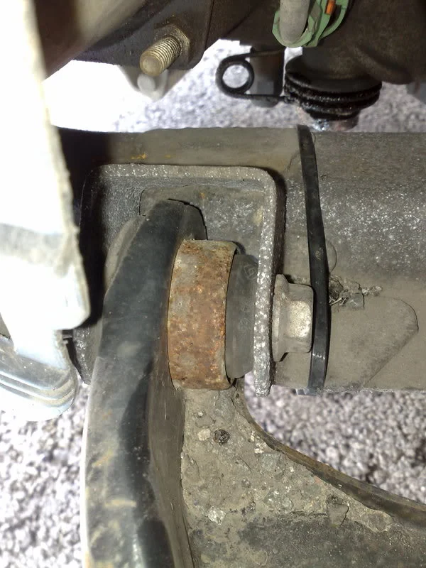

Ok so thats those! Then i got my head under to see if anythin obvious was wrong under there!

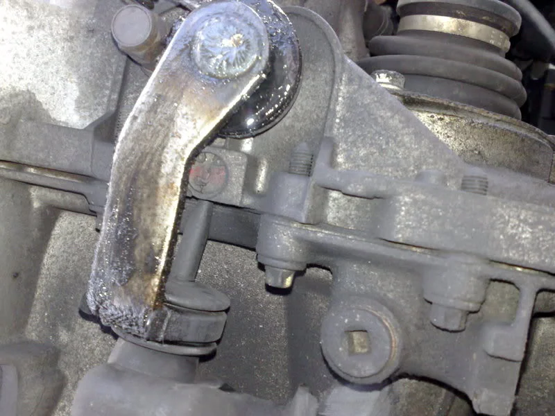

Im unsure whether its supposed to be this loose but . . . this is the gear control with me puttin a lil bit of movement on it, then shakin it lol . . .
Is that normal? plus would that make the noking noise as im turning left only?

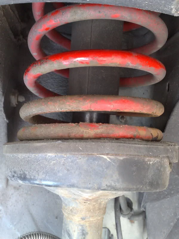

i think it may be the spring mate. From the picture you can see that it has been "cleaned" on one side. Unless you have been touching it etc it may have been rubbing or hitting on something as it looks like an aftermarket part
  Clio 197 Cup
yeah that clean bit was from me grabbing it to see if that was loose, it wasnt!
They are aftermarket, 60mm Pi springs

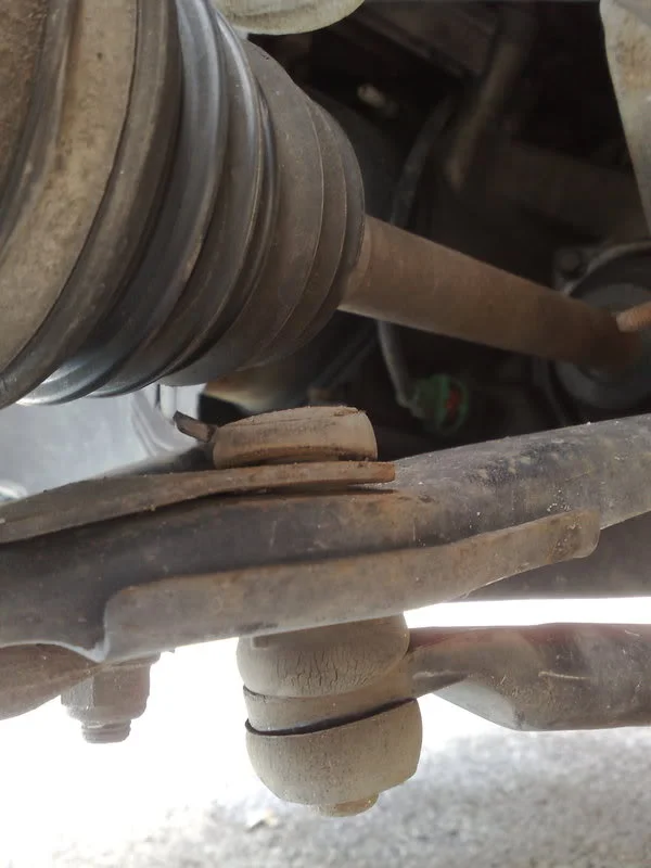

i'd say it was the lower ARB bush, looks a bit loose and the rubbers look knackered. pennys to fit even if its not and at least you can rule that out then :)
i had the same problem on my car too and this fixed it :)
