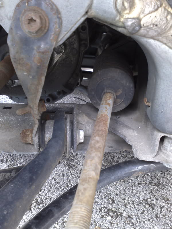

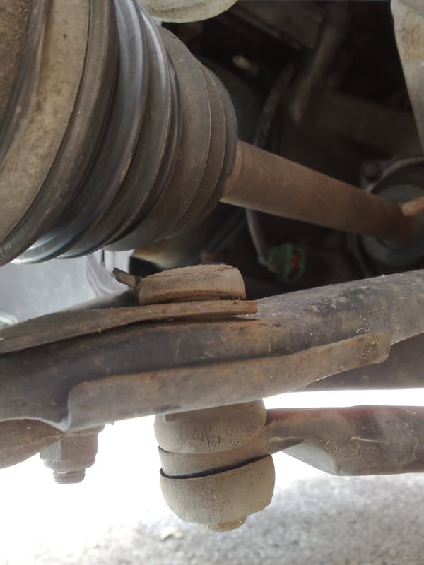

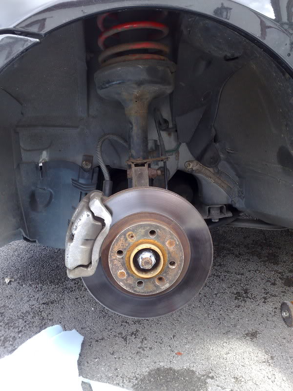

I took wheel off and took few snaps see if any of you's can see anything out of place or f**ked up, cos i cant!
Ok so thats those! Then i got my head under to see if anythin obvious was wrong under there!

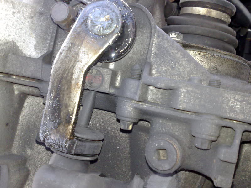

Im unsure whether its supposed to be this loose but . . . this is the gear control with me puttin a lil bit of movement on it, then shakin it lol . . .
Is that normal? plus would that make the noking noise as im turning left only?
