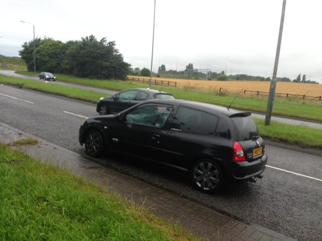

Recently posted up that I span off a dual carriage way.. Ended up like this:
Anyway the curb I slammed over has now slightly bent my rear axle. Now giving me the perfect excuse to do a rear sport conversion. I can buy a whole 182 rear axle including all brakes discs pads etc for 120. My brothers childhood best friend is now a Renault senior mechanic so he can do all sorts with it.
