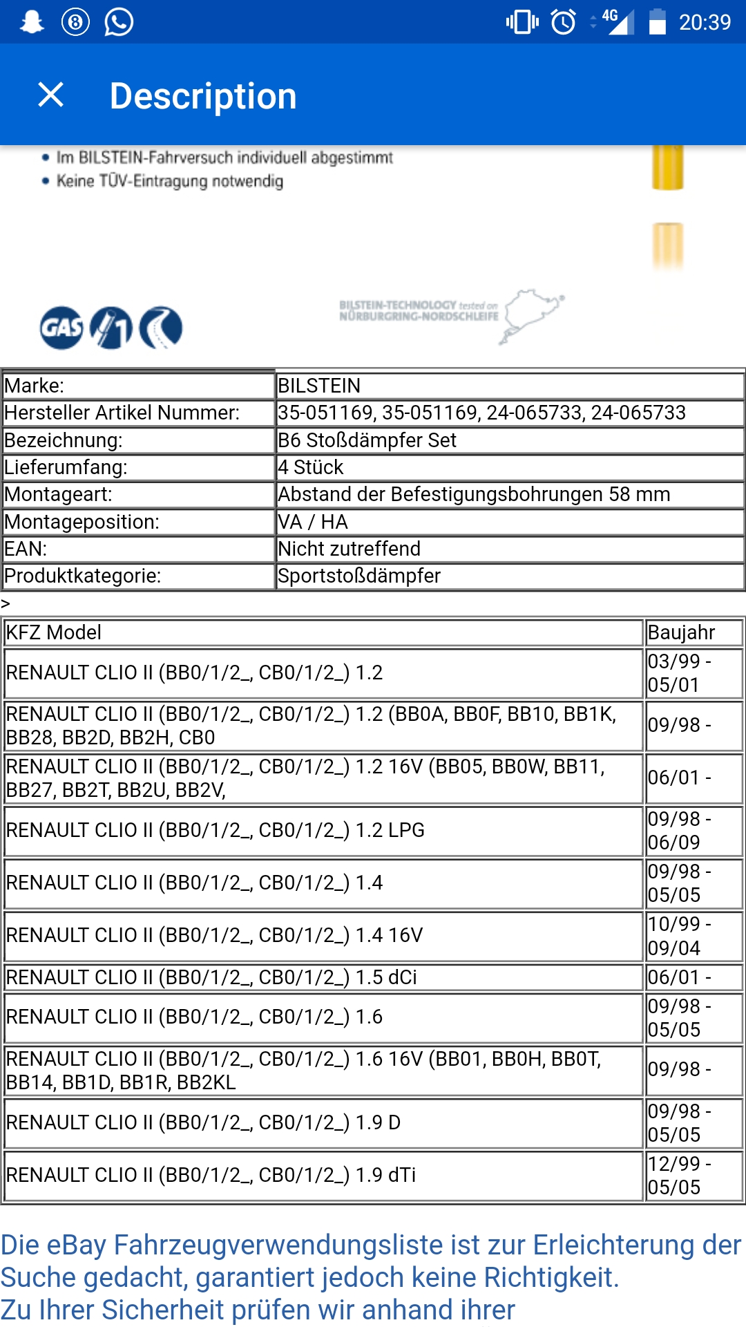

What is needed to modify Non-sport shocks to fit them in a sport? I want Non-sport bilstein B6's fitted to my sport, because there aren't any for sport.

They don't make Bilstein B6's for sport clios. I want them because of they are perfect for rally driving on gravel roads because of their ruggedness and because they are quite soft.
