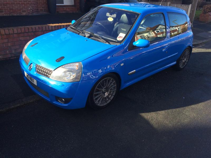

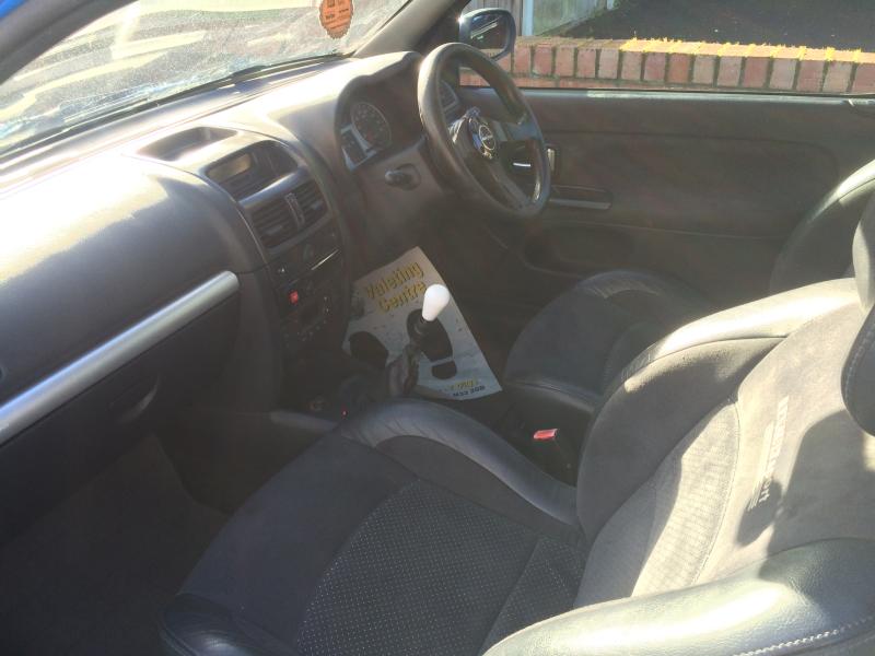

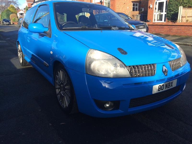

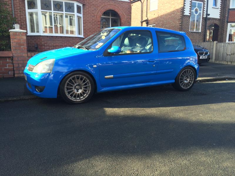

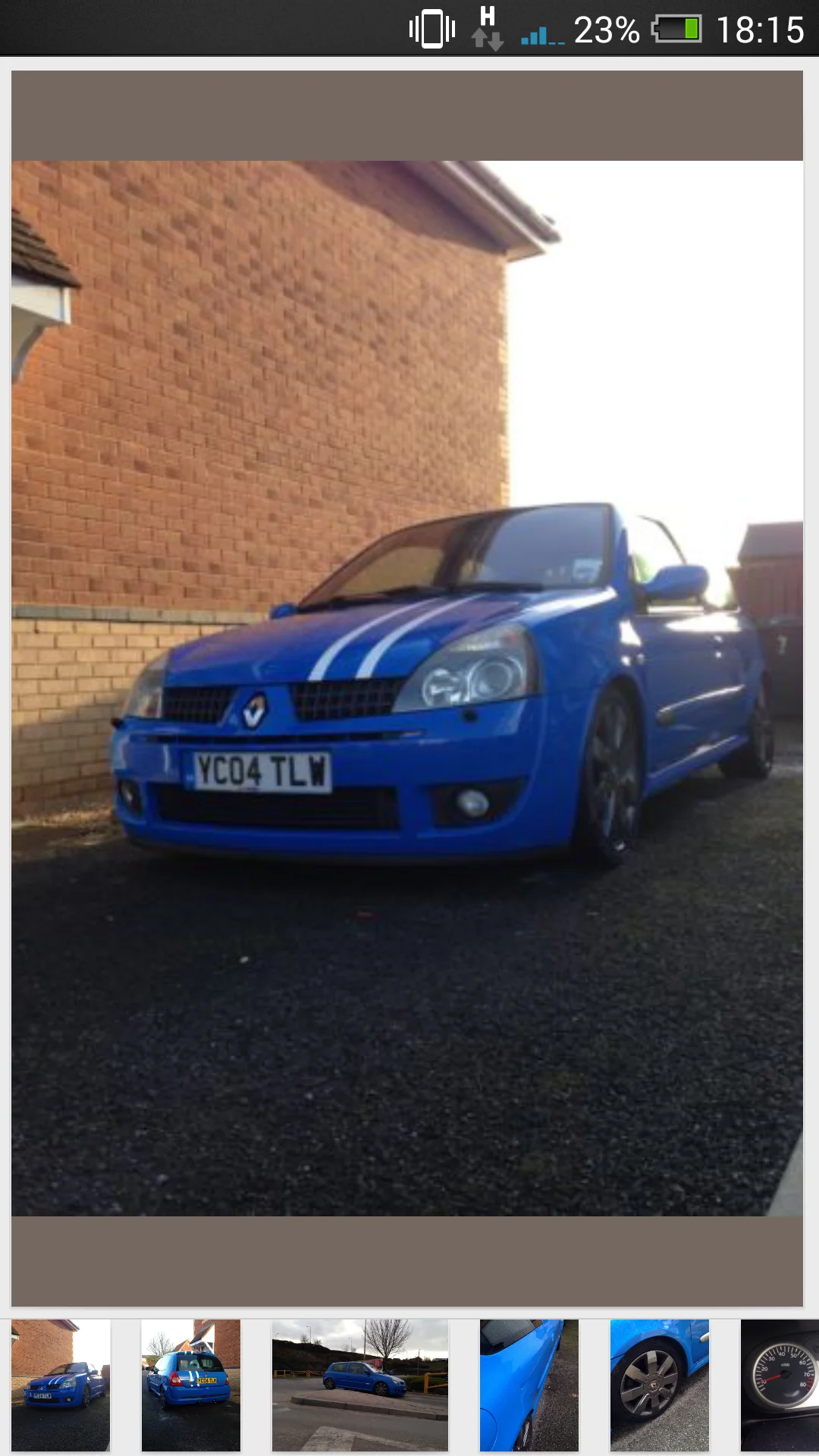

It's home. Needs suspension raising desperately and lots of new parts are on the way.

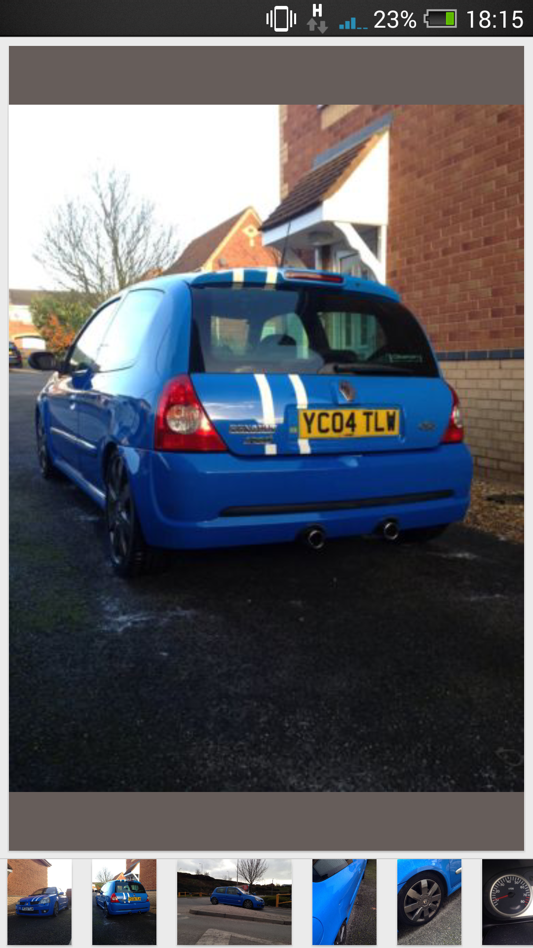

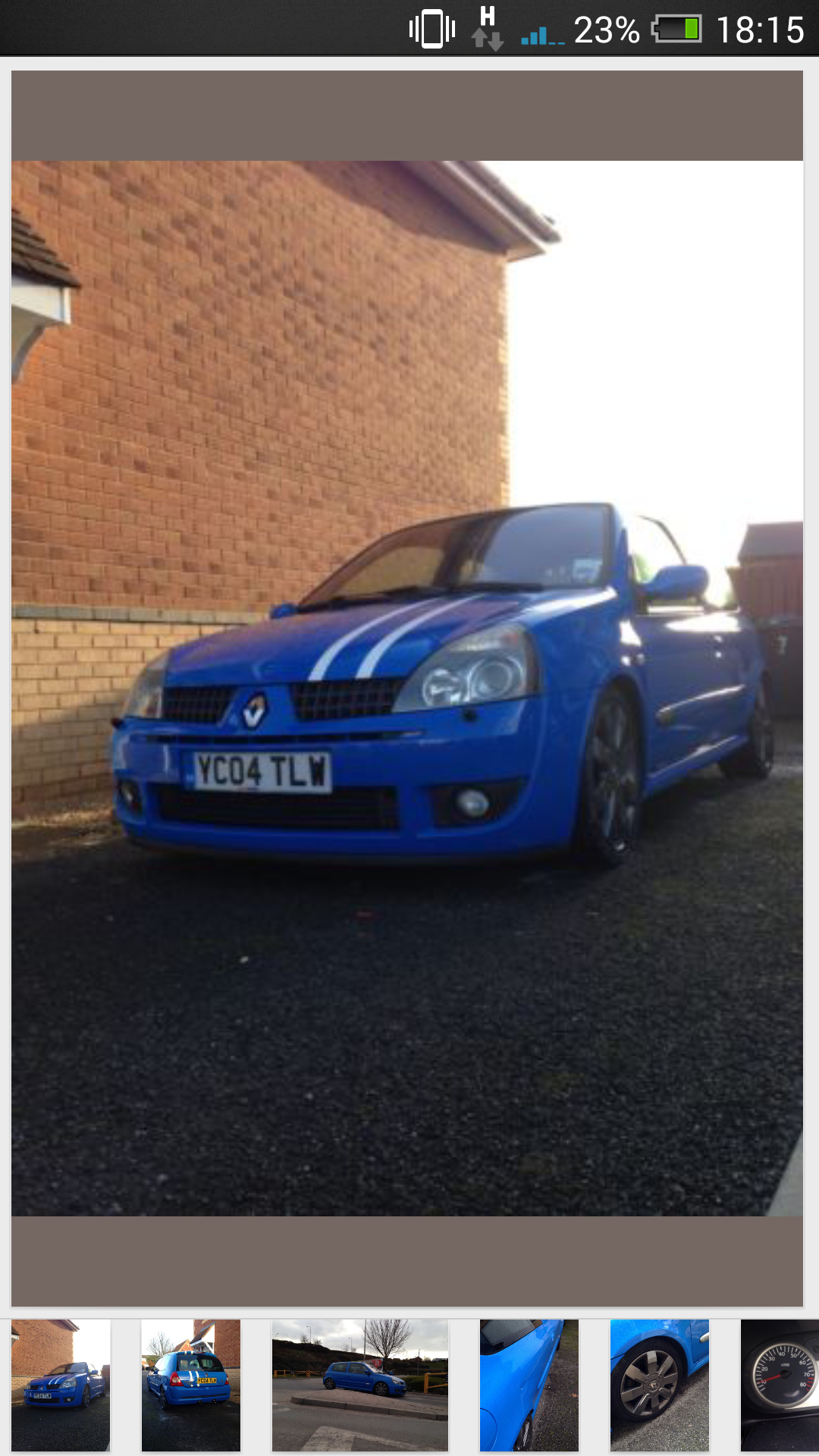

This is what I'm starting with

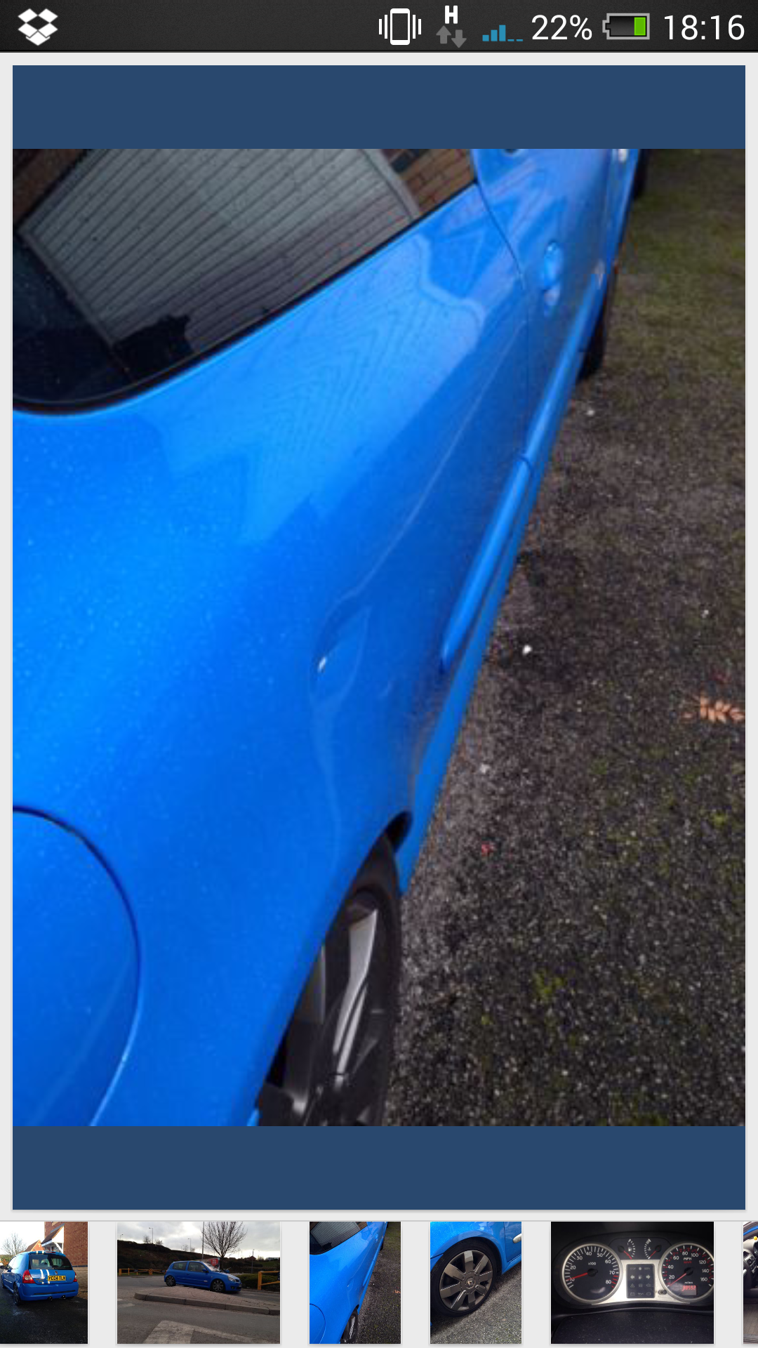

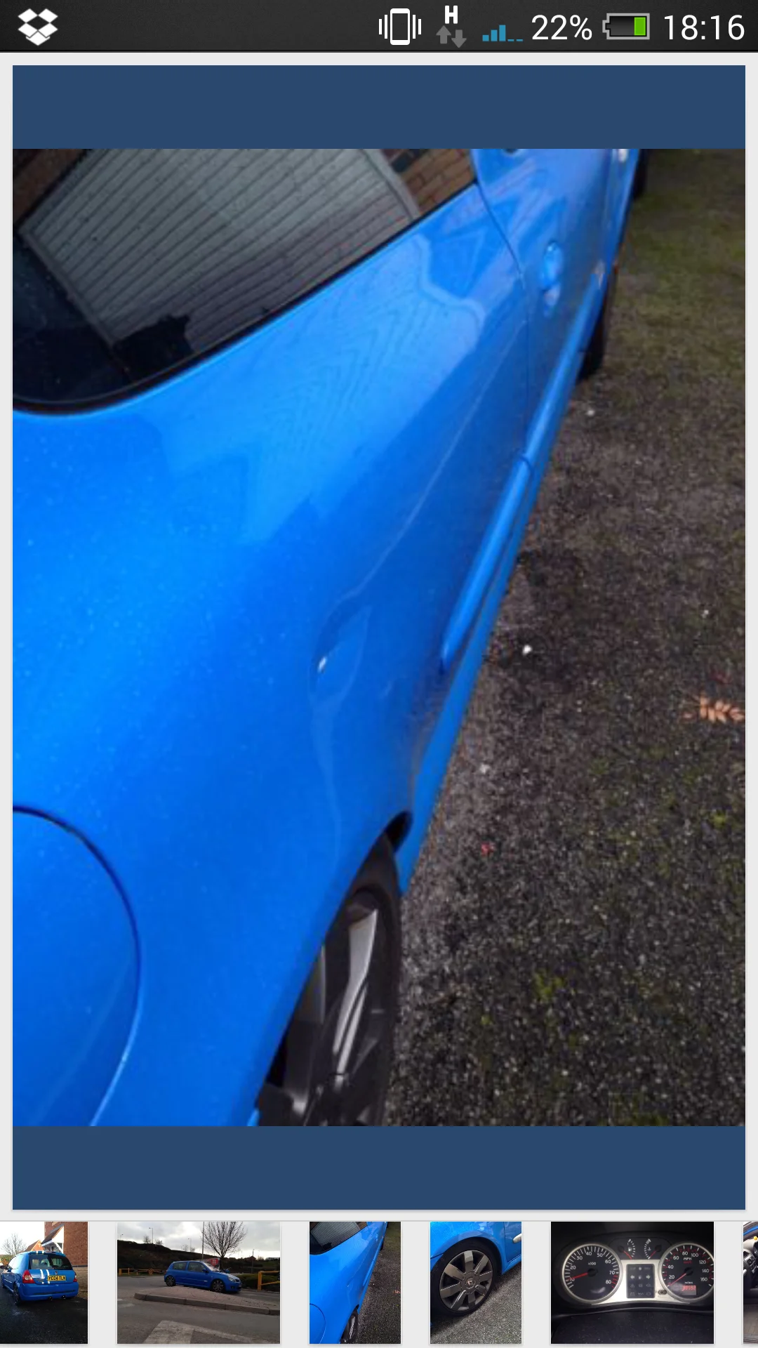

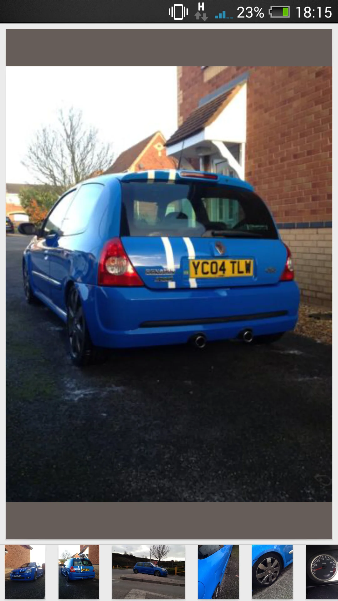

Yes it was on eBay. It cost me £1200. It has a dent in the rear quarter off a child's handle bar. Not pretty but as I own a body repair business it's the least of my problems and will be done last once every thing else is to my liking. :-)

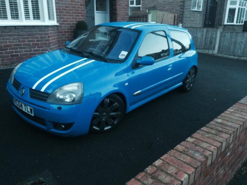

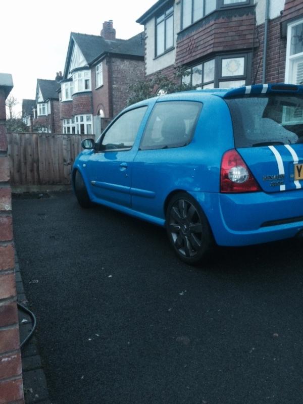

Found these from 16th Nov last year from the eBay add :)
