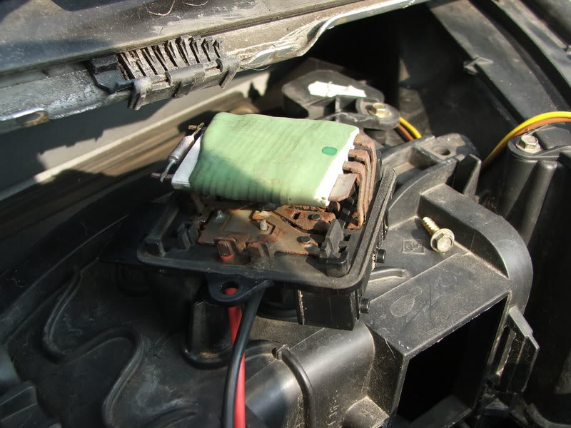

Yep i've seen the guide for the regulated AC. however mine the normal type. Which pin's do i need to short out, the check it's not the fan. As i've lost all the speed's.
I;ve found a handy photo on here that got the same set-up as mine.
http://i106.photobucket.com/albums/m271/BrianR_04/DSCF2553.jpg
Cheer's Brian R for the pic.
Sorted it, The fan dead. took it out and shorted the live and neg wire, with the battery. no spinning what so ever.
