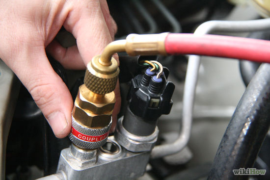

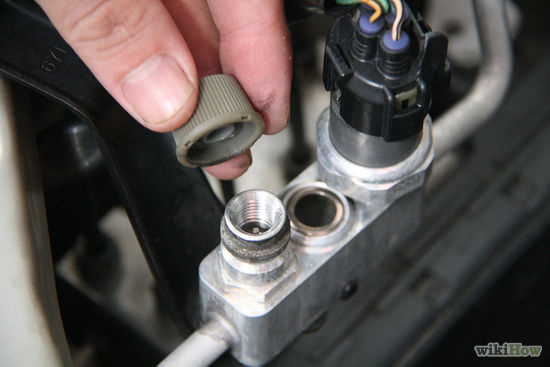

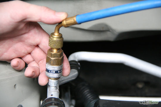

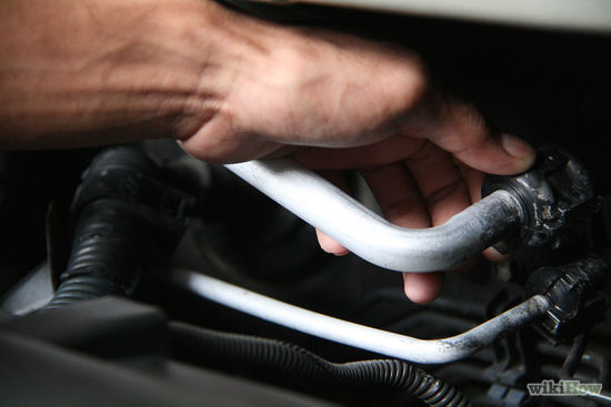

7. Locate the low pressure charging port on the refrigerant line on your car. This will be on the larger tube, usually near or on the accumulator. Connect the quick coupling and make sure it is not leaking.

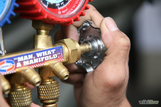

9. Open the valve until you hear refrigerant passing through the hose.

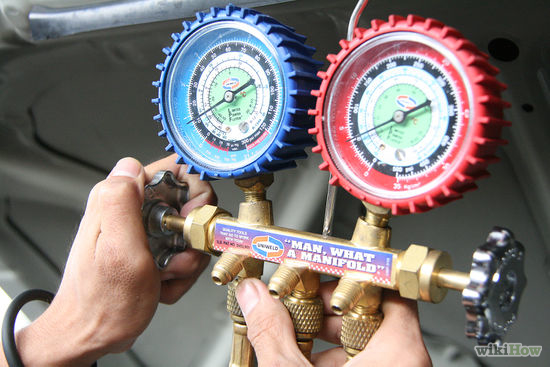

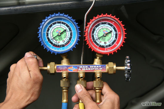

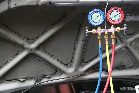

10. Allow the can to dispense its contents. This often takes anywhere from two to five minutes. The hotter the outside temperature, the more quickly the contents will discharge. Keep the can with the tap up at all times, to allow non-liquid refrigerant into the suction side of the system to prevent compressor damage. Do Not overcharge! A manifold gauge should be used to measure both high and low side pressure. Consult a Pressure temperature chart.

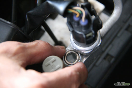

11. Close the valve and disconnect the hose when the can is empty or no longer discharging enough to keep the can cold. Check the charging port for leaks, and replace the plastic cap.

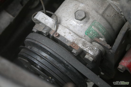

You can get an R12 to R134a conversion kit at an auto parts store, but should consider having it done professionally.
If your car is earlier than approximately 1993, the air conditioning will operate on R12 which is now obsolete. However there are replacement refrigerants such as Freeze12 which will not require you to convert your system to R134a in order to recharge.
Later vehicles run on R134a. These systems have different size ports, making identification easy.
