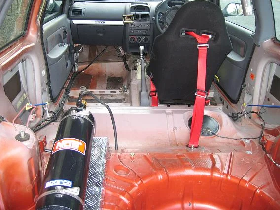

Had a 50hp jet with digimax progressive controller on the original sleeper - ran a 13.6 @ 106 mph - its good stuff !!!!
