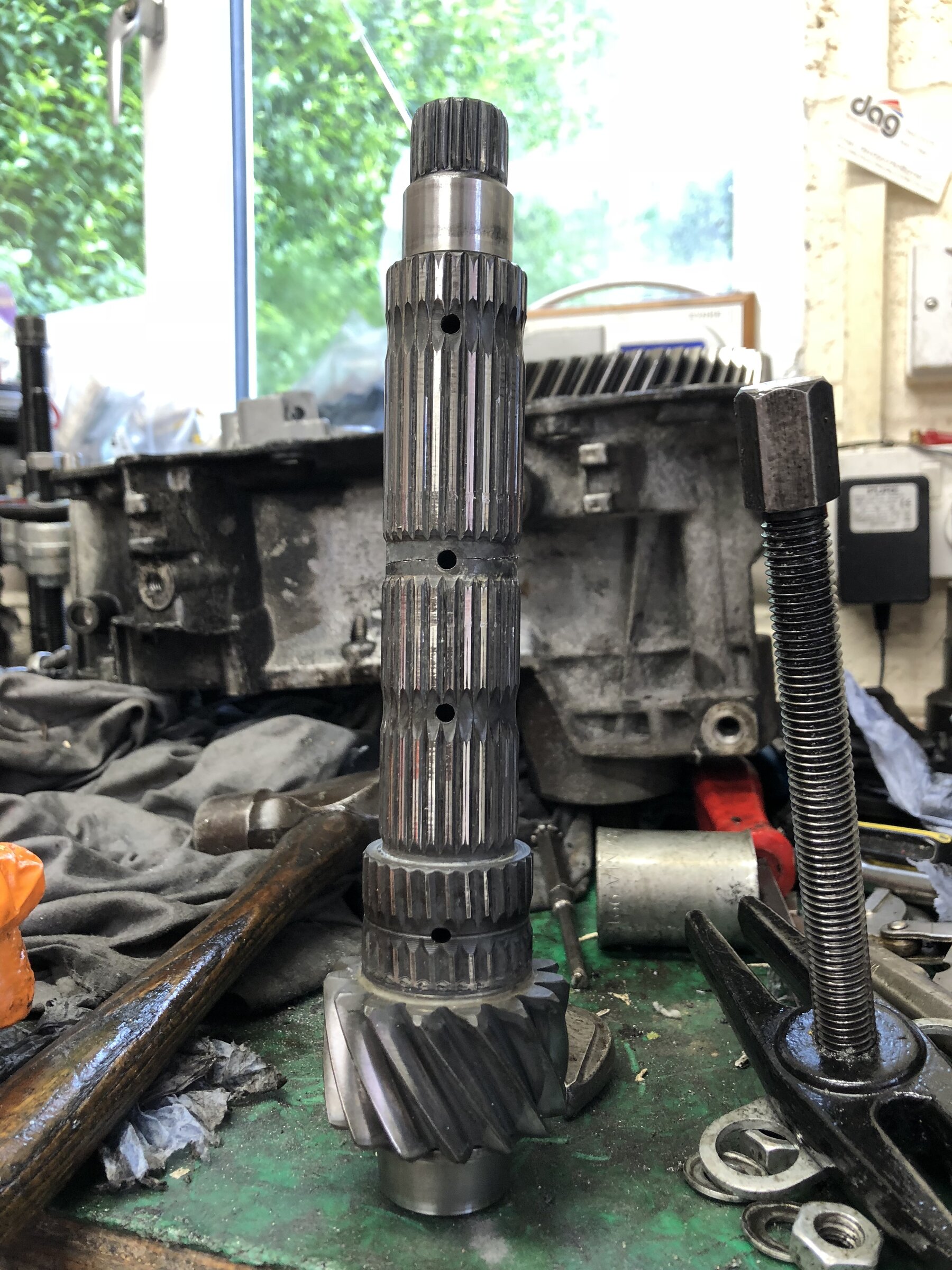

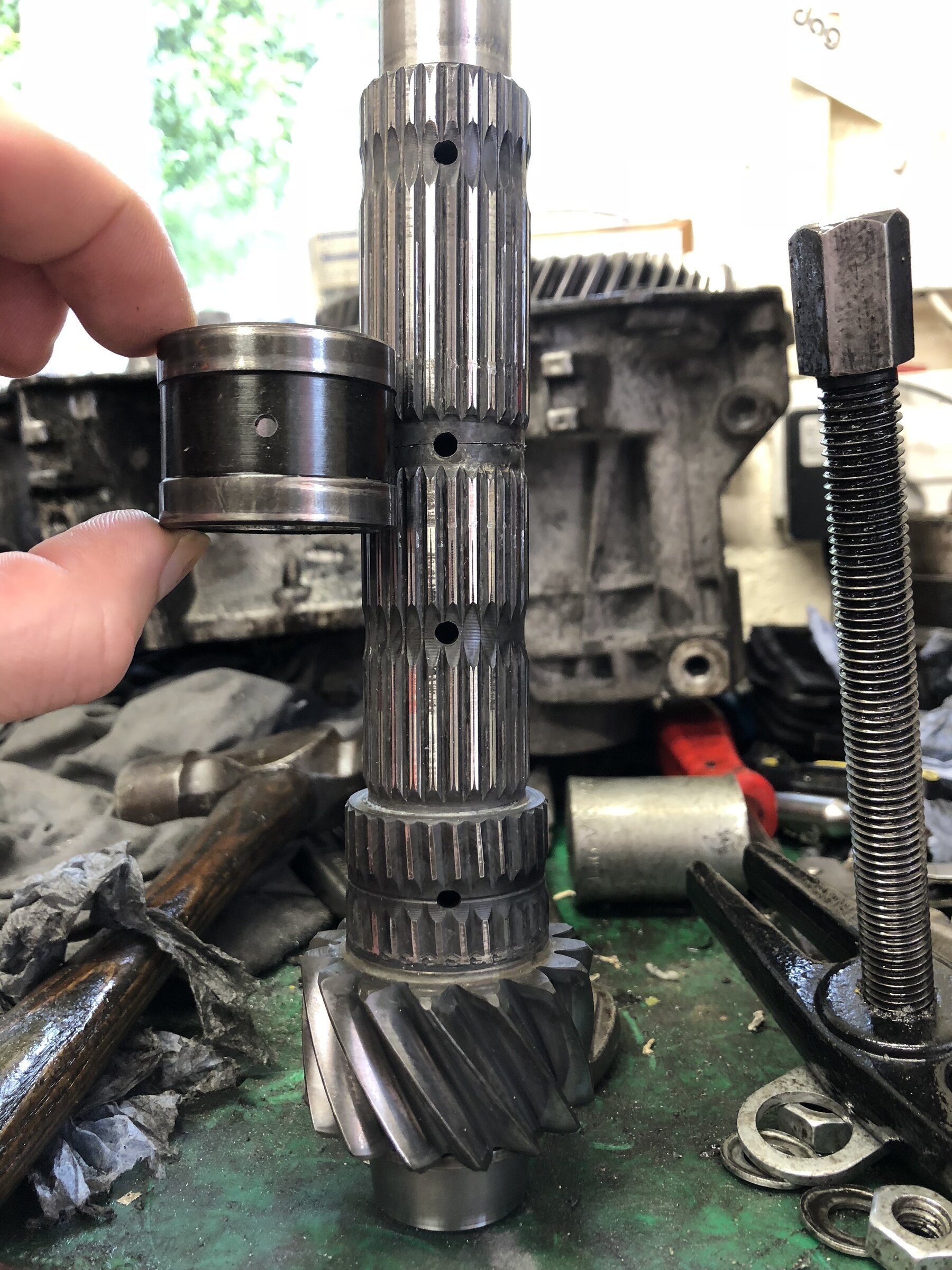

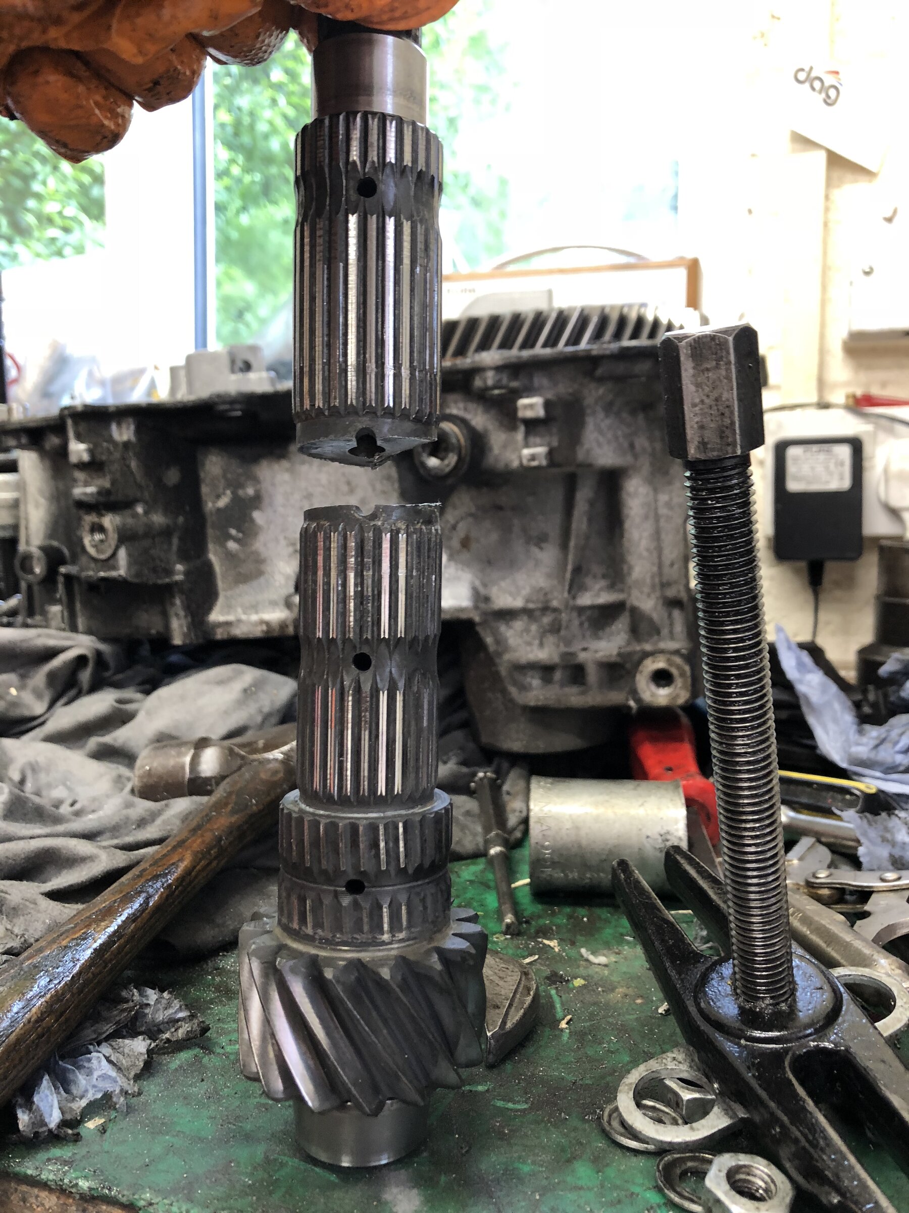

It’s not often that I’m left speechless by what I find when I pull a Jc5 apart, but this one left me laughing in disbelief! I’ll let the pics do the rest of the talking.
Ok so brief background - stripped the teeth off 5th gear but still driving as a working box. That collar was holding the shaft as best it could, but it’s popped the top casing, so essentially it’s written that particular gearbox off.
I’ve NEVER seen one of these snapped! And this was only in a near enough standard 182. Lol!
Clearly rolling 180bhp and 1600lb/ft of torque. 😂😂😂

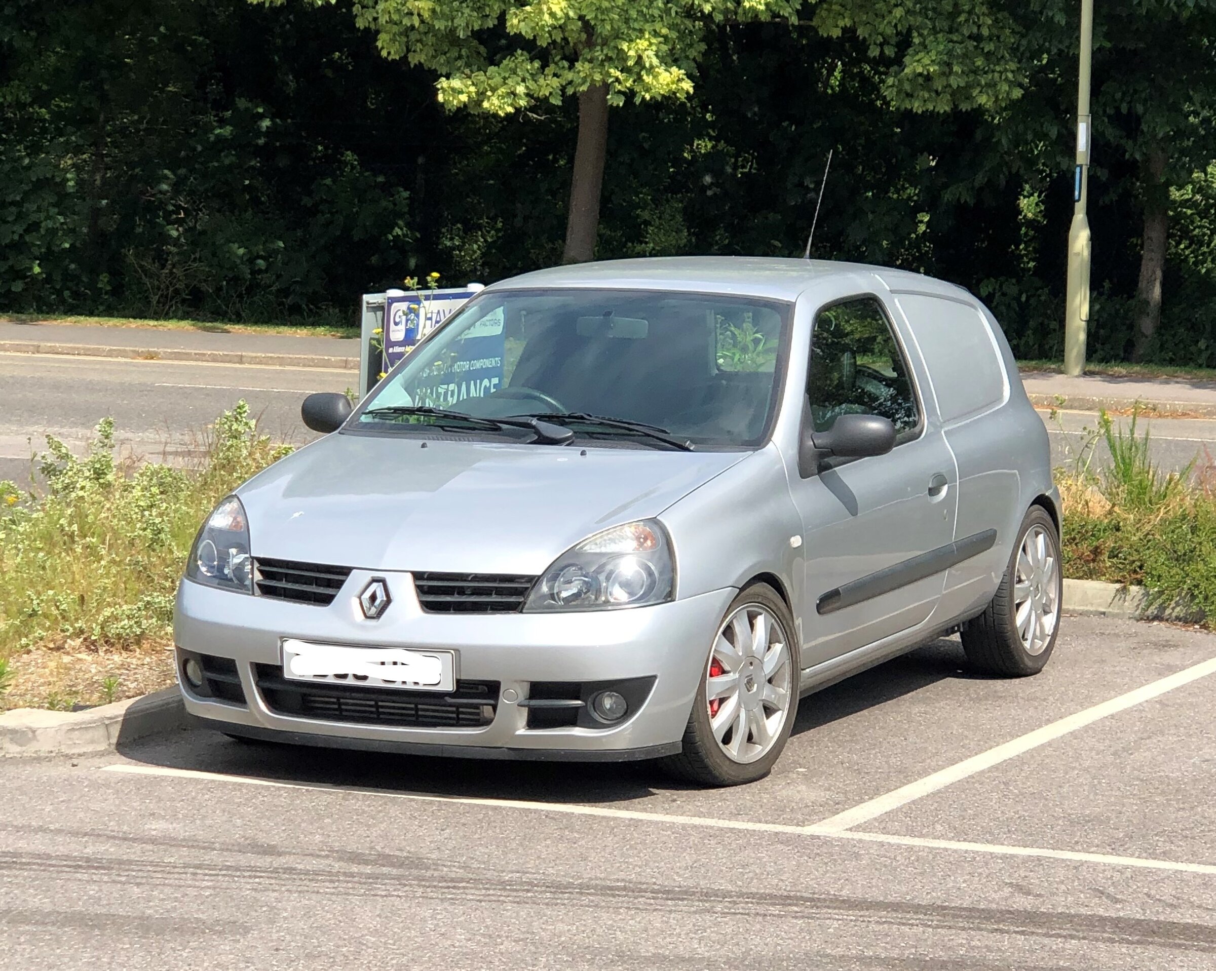

No mate. I picked it up in for £360 with the clutch gone, and now it's 182 spec front interior with 237bhp lump.
