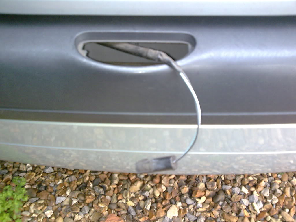

It's down to corrosion, it's a common fault. You need to pop the bulb holder out of the bumper and clean up the contacts a little.
Failing that it's probably time for a new unit completely! :)

Lewis, yeah that's the correct bulb exactly the same as the one I have.
As for checking, it's just a matter of popping the holder out of the bumper and giving it the once over.
Clean the contacts and see if that helps, if not then check the wiring. Often this can rot and fail. That should help identify which part needs replacing mate.

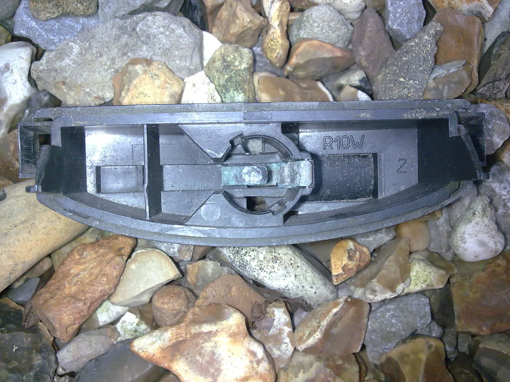

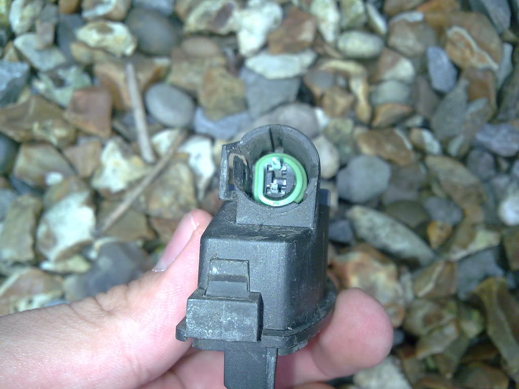

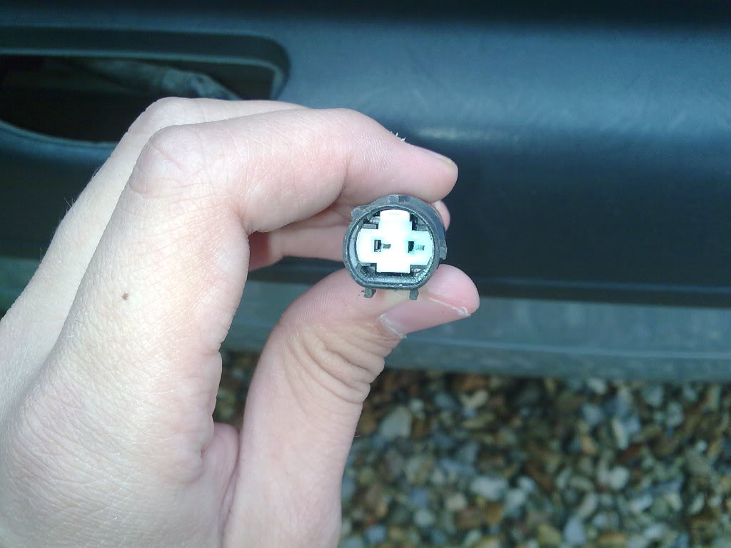

Right i took a look at the cluster etc. today and i'm clueless still. if anything it looks like the contact is dirty... but how would i clean it? any ideas?
  1998 BMW e46 323i
use an abrasive on the contacts the bulb touches, clean everything and oil the metal bits. then try again, check fuses etc! I'm gonna have to do mine, will prob' end up getting the tin foil out!
  "Navy" N17 TWO
Put a bit of sandpaper on the end of something thin enough to get into the contacts
get the rough off and spray some wd40 in
clean up and try it again :)
  "Navy" N17 TWO
Also, the little metal contact inside the housing can sometimes be bent out of shape so needs pushed gently so it touches the bulb

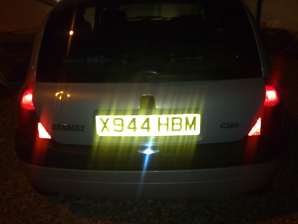

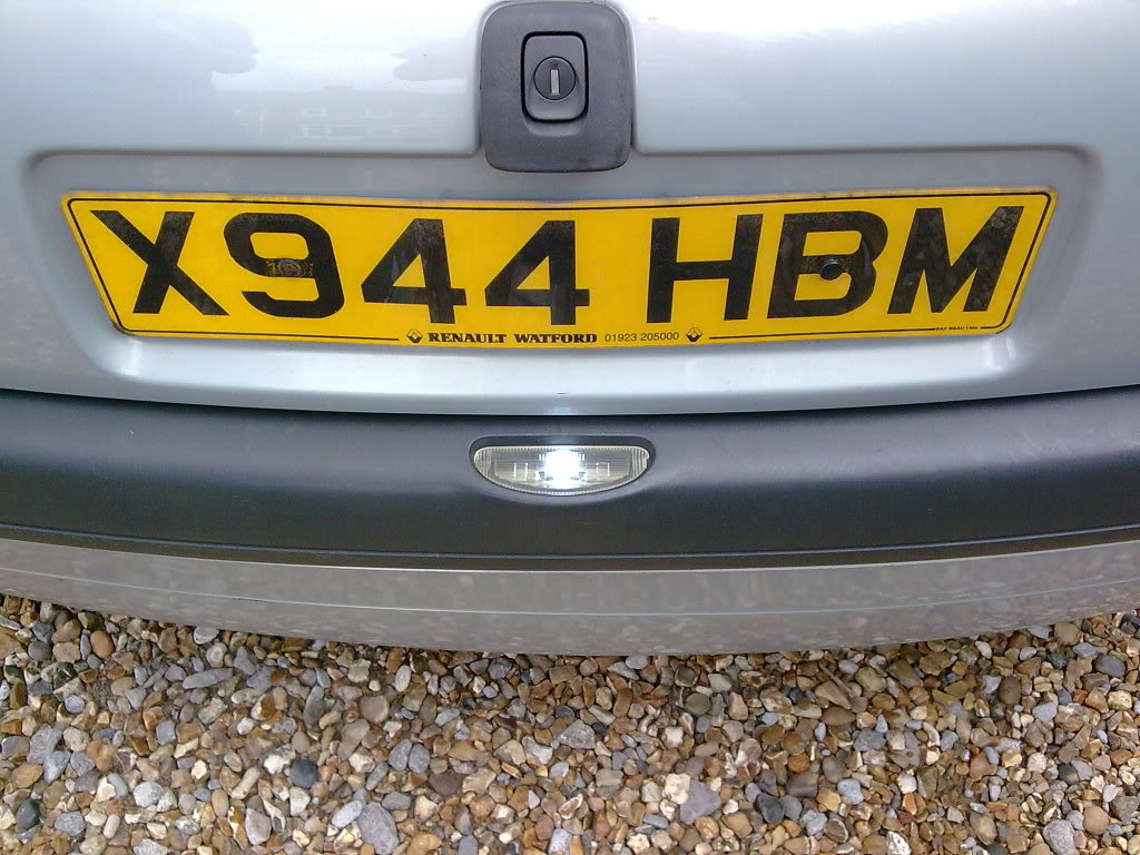

Okay I sanded the connections a bit and put some wd40 on it and left that overnight.
put it all together today and at first nothing... :( put my hand round it to see if it was lighting at all and then all of a sudden it blinded me :D will get a pic at night but for the moment...
appreciate your help guys, thanks
