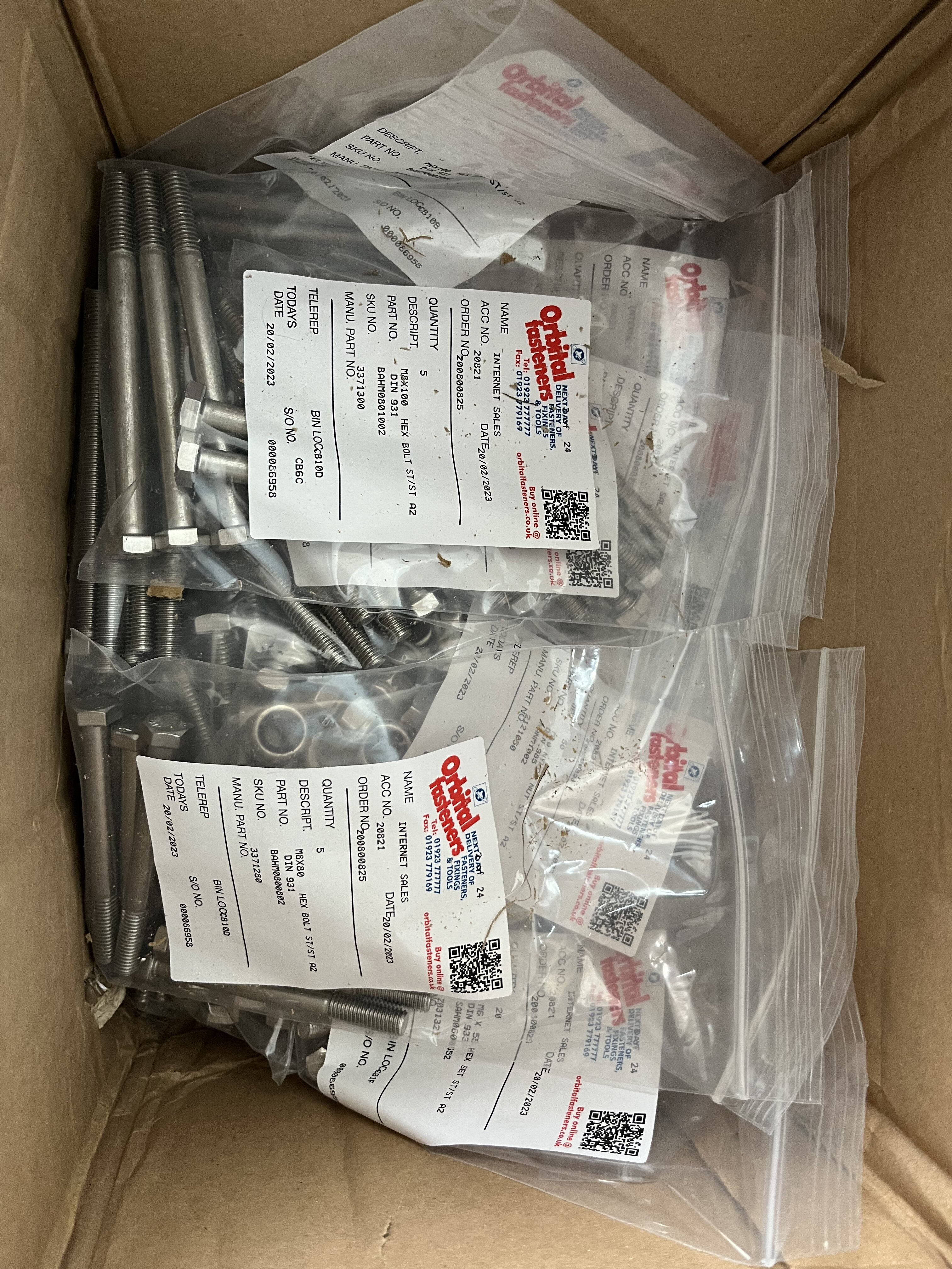

15kg of stainless is here!

Be careful of using stainless bolts on carbon steel parts, can often cause further issues due to galvanic corrosion and dissimilar metals. Especially in a corrosive atmosphere or where theres lots of moisture / salty roads

Not sure if all the stuff purchased is for the car as stainless has differing structural properties [tensile wise] to steel so for [some] structural elements is not suitable.

Almost all the stainless steel fasteners on sale will be of one if two grades; A304 ( also known as A2) and A316 (aka A4). Their strengths are very similar but A316 has better corrosion resistance, particularly in salty environments.
Neither of these grades is equivalent to a high-tensile carbon steel ; Renault often specify a Grade 10.9 fastener, which has more than twice the strength of any SS item. In practice this means that an SS fastener may stretch when being torque-tightened or will loosen in service. For lightly loaded applications SS fasteners are fine but for highly-load parts like some engine, brake of or suspension parts, they are not suitable.
An additional problem is that when both bolt and nut are SS they may be prone to ‘galling’ , which means that the threads will strip when you attempt to loosen them. In most but not all cases, prior application of Loctite will prevent this.
It’s a bit of a minefield
  Clio Cup F1
Well put (y) - thats exactly what I meant. Also, even though austenitic st/steel grades have general corrosion resistance they are susceptible to damage by stress corrosion cracking in corrosive atmospheres especially between dissimilar metals [salty water/steel/aluminium] unless fully and properly separated/sealed.

Alot of good points made, quite often a misconception that stainless is best

This is important. Do not use stainless bolts on suspension, steering or load bearing items, you need to stick to 10.9 carbon steel. Stainless is no stronger than normal 8.8 steel bolts. 10.9's if plated are fairly resistant to corrosion so get those.
If it helps add weight to the above I studied a degree in materials science, so please do take note of what @Hillclimb182 said.

All my Stainless fixings are for engine bay dress purposes and those random little things that crop up.
