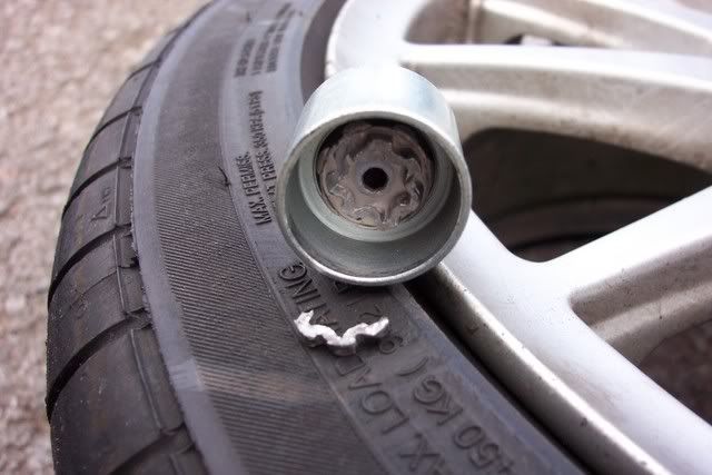

If you paint the wheels, don't paint where the bolts seat - sounds obvious, but I didn't and lost one bolt and almost the wheel as well around Goodwood once.
Don't use your locking wheel nut on the valaver alloys, get 4 standard bolts and use them when you swap for trackdays. On a Turini the bolt heads are set inside a recess, which helps keep the wheel-nut key where it should be. On the valver wheels, there's no recess. I managed to do this when the key twisted off the end on one trackday...
http://i7.photobucket.com/albums/y260/MarkCup/100_3487.jpg
