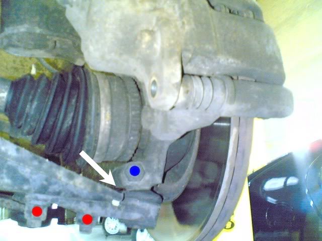

Thats the ball joint, you can see the 2 bolts going downwards (Red dot), and the 16mm bolt going into the hub (Blue dot).
In a nutshell, the day before your going to do it, soak the lot in penetrating oil. Remove the 2 bolts holding the ball joint to the wishbone, remove the 16mm nut on the end of the Ball joint bolt, tap the bolt through the hole, use a ball joint splitter to remove the ball joint from the bottom of the hub. When refitting you've just goto line the indent in the ball joint up with the hole in the bottom of the hub, get the bolt through and your away.
wise words above soak in wd40 or the like the day before. I just changed a ball joint on my clio didnt soak it and what a git that was i ended up using a nut splitter to undo the two bolts that hold it to the wishbone. job took about an hour no need to take the hub off as said before. Nice easy job really, if you need any help im more than happy to offer advice as are most users on here. Pattern parts are pretty good they have to be, service centres dont use stuff from the manufacturer unless told to so id say save some dosh and go to GSF or Eurocarparts or partco and get the ball joint from there. It will be a load cheaper than those robbing Renault dealerships.
