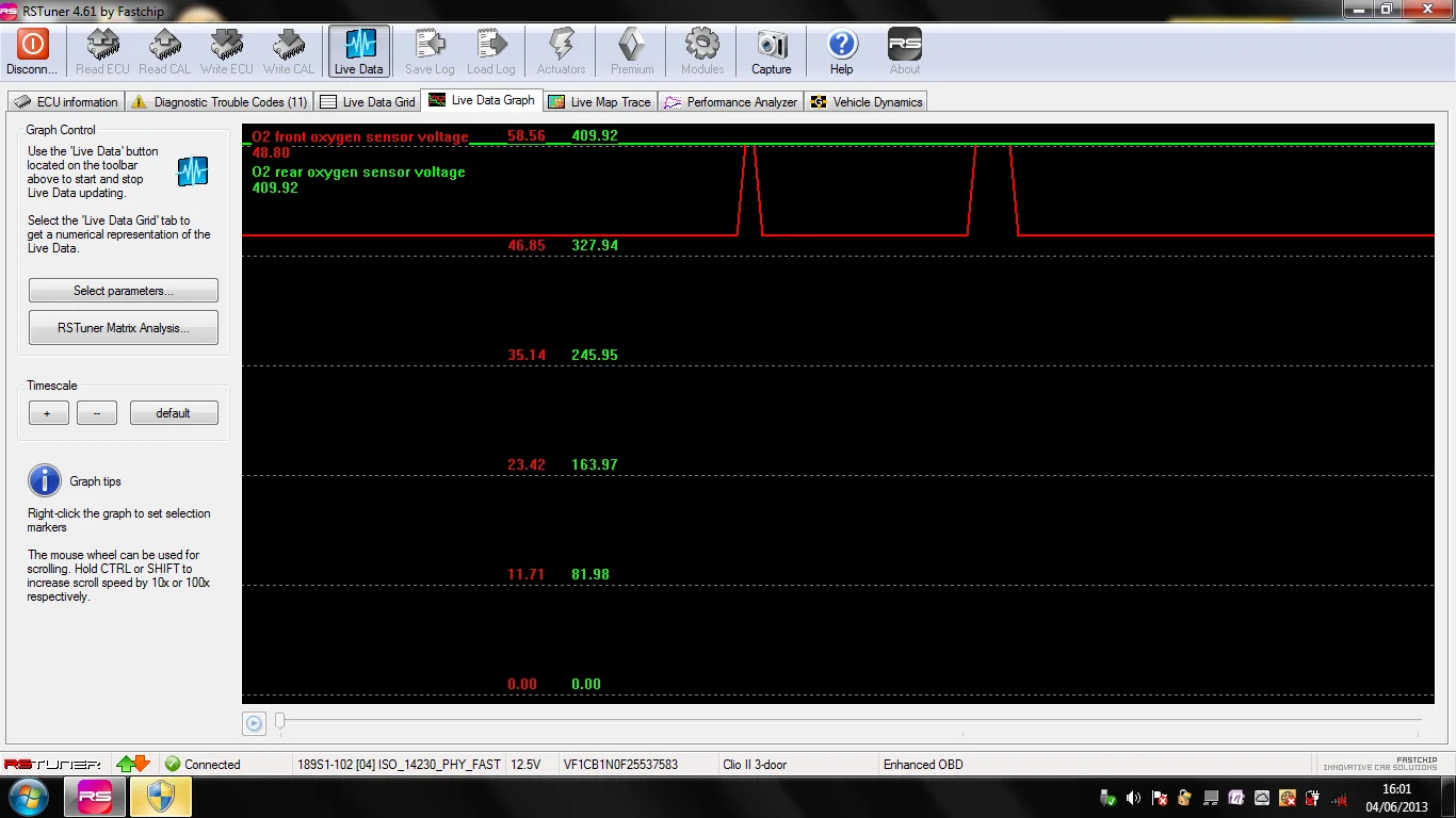

Car started to be a bit hesitant and a slight misfire so had a quick look on my rstuner.
Had a current fault Rear o2 heater sensor, checked plug was corroded so wired in bypassing the plug hoping if would just be that.

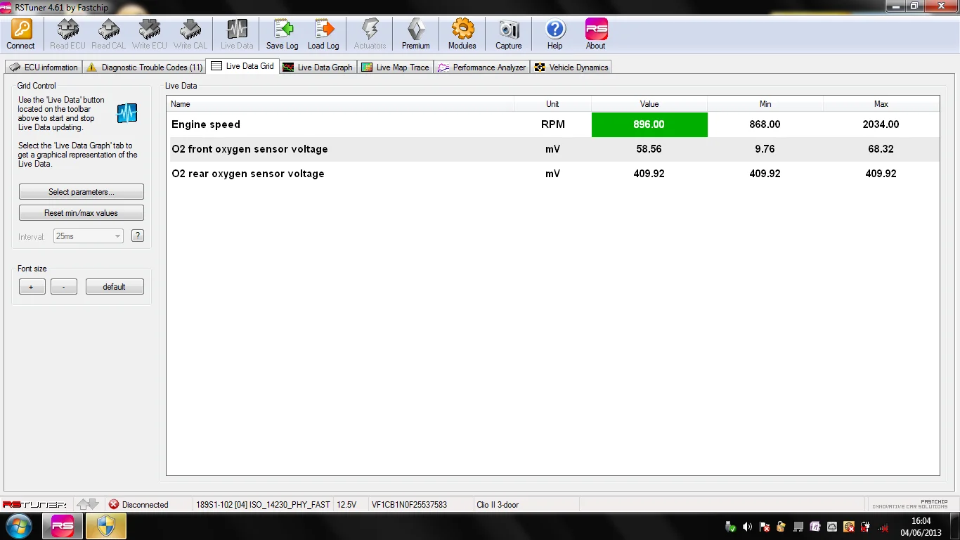

Still got the fault so had a quick look on the live data and it was showing this. Looks like the rears fine but the front is goosed and should be fluctuating a hell of a lot more than that suspect Causing my misfire?

The rear one is meant to flat line as that's only a diagnostic probe, so doesn't actually influence anything.
The front one should be anywhere I between 100mv and 700mv, and fluctuating a lot more than that like you say.
That graph looks a lot like my gf's graph on her fiesta st, I know it's a different car but she had a slight misfire, changed the lambda and it cured the problem and the graph looked normal again.
Id say give that spare one a try that you've got as the front n rear lambdas are the same iirc

Yeah I was pretty sure the front should be 700 something mv max?

Front should fluctuate between 4-800mv and the rear downstream used to measure gases after Cat. Hence why after de cat most people encounter EML lights.

Front isn't working as it should. As above it should fluctuate between 100 - 800 mv aprox.

Yeah engine is up to temp, just jacked the car up at home and I've got a horrible feeling my cat has gone, blowing and rattling quite bad...sensor was too tight so will get u.it up on the ramp at work and have a look.

pre cat sensor signal is a 1000mV (1V) range. It's a switching signal, between roughly 40mV and 950mV
