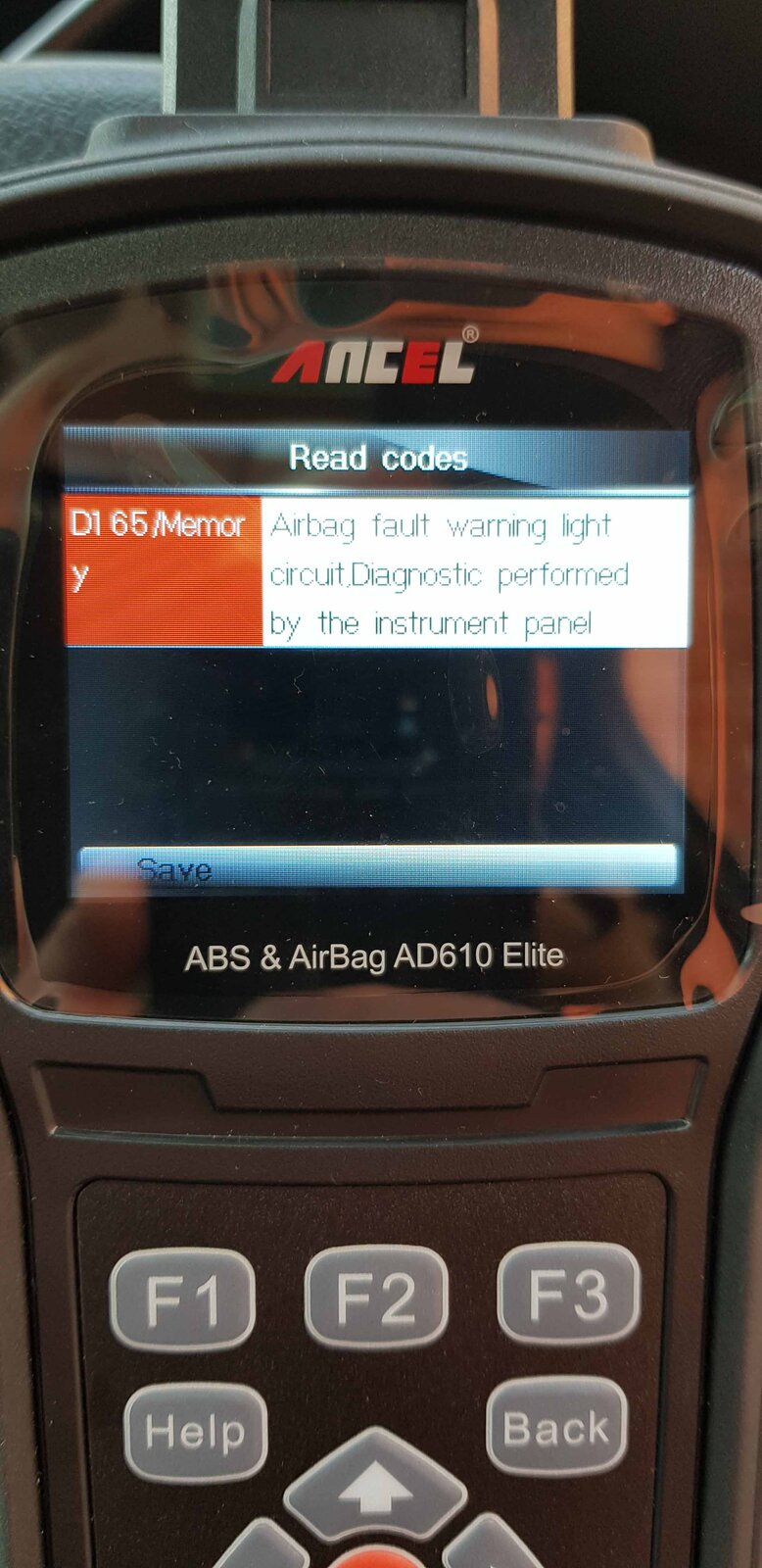

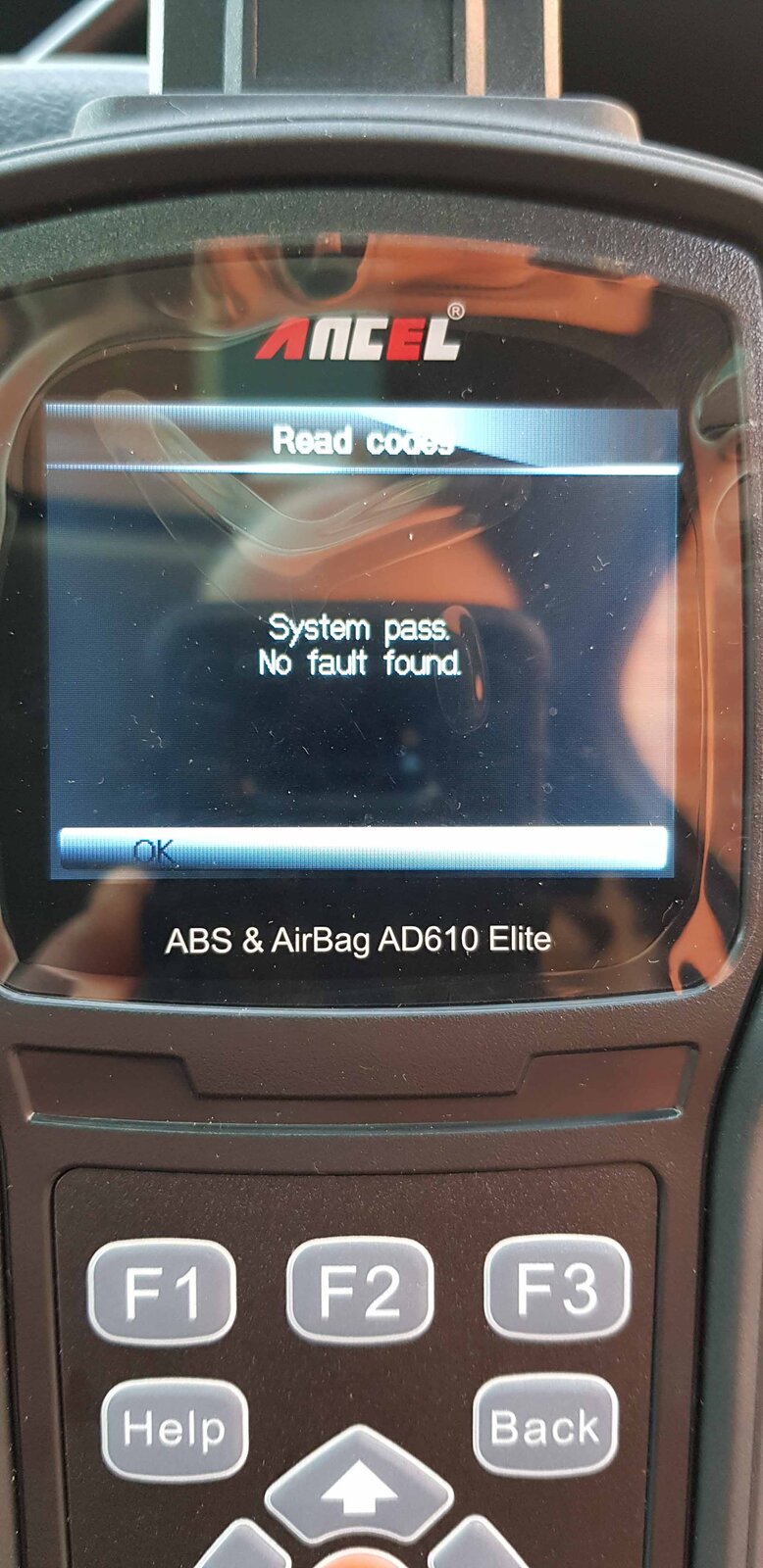

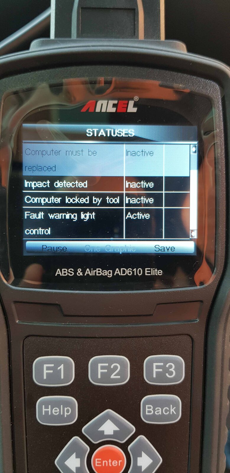

I have the dreaded Airbag / Serv lights on on my wifes 2004 Clio 1.5 dci
My OBD2 scanner can read airbag ECU, but it shows no faults, other than when I turn on ignition then I get the fault shown below that I think is just the control panel telling me the warning lights are on.
I've tried unplugging various airbags and I get the correct fault codes on my OBD2 scanner.
The pretensioner wires under the passenger seat has been soldered together.

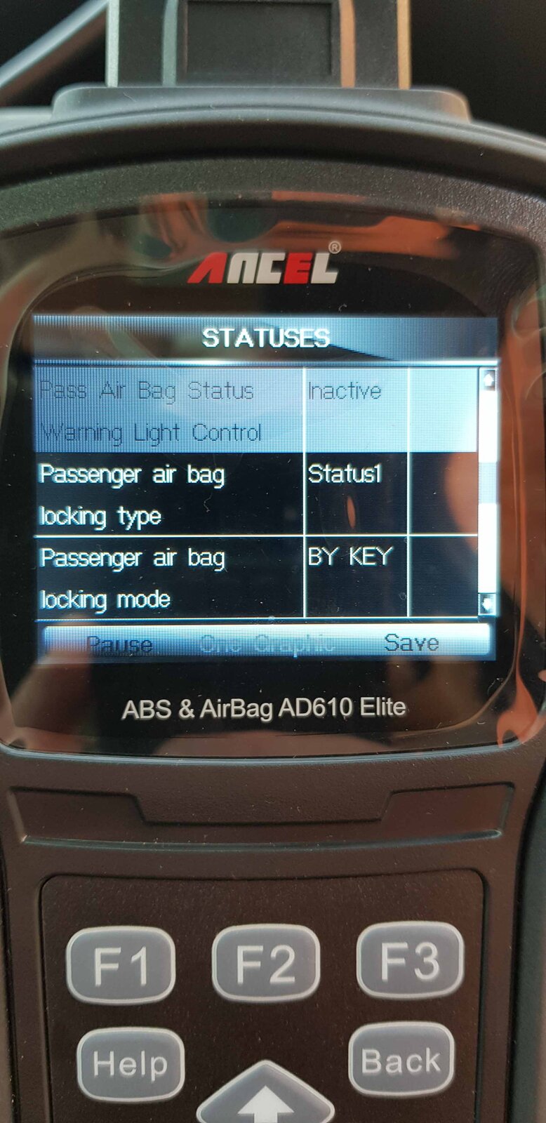

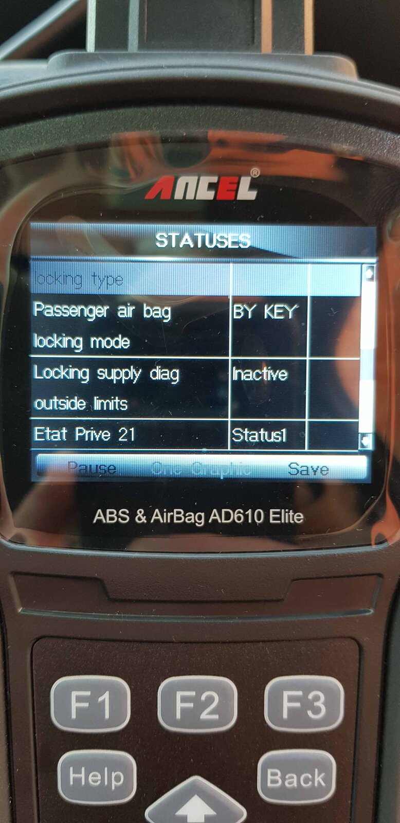

The passenger airbag key switch on the door reads the correct 400Ω or 100Ω and the warning light comes on to tell me its switched off.

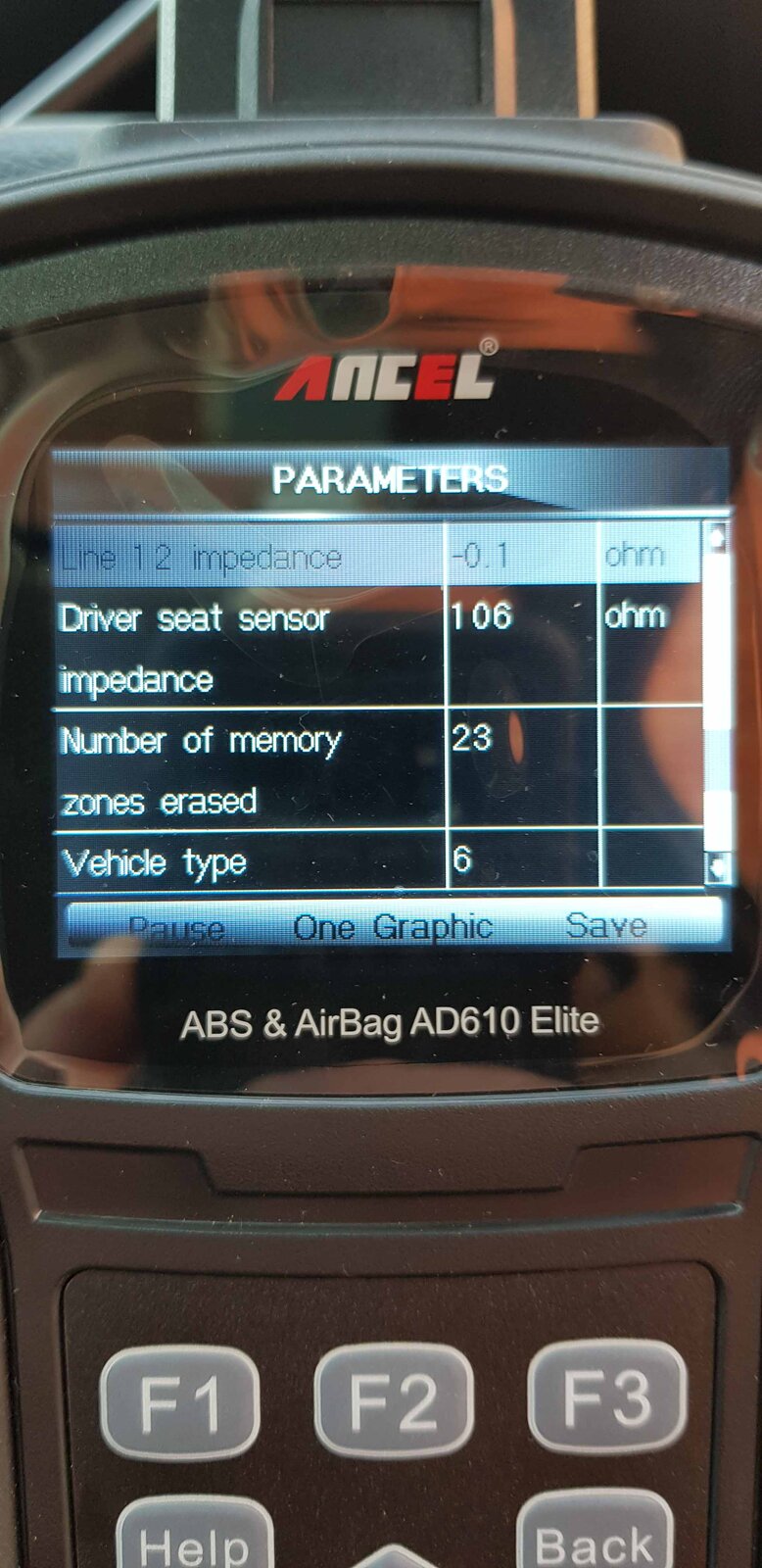

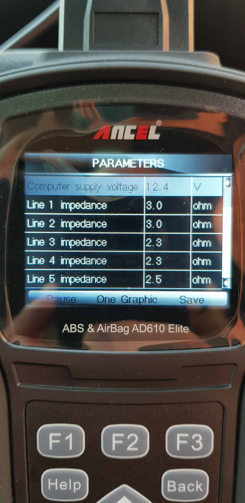

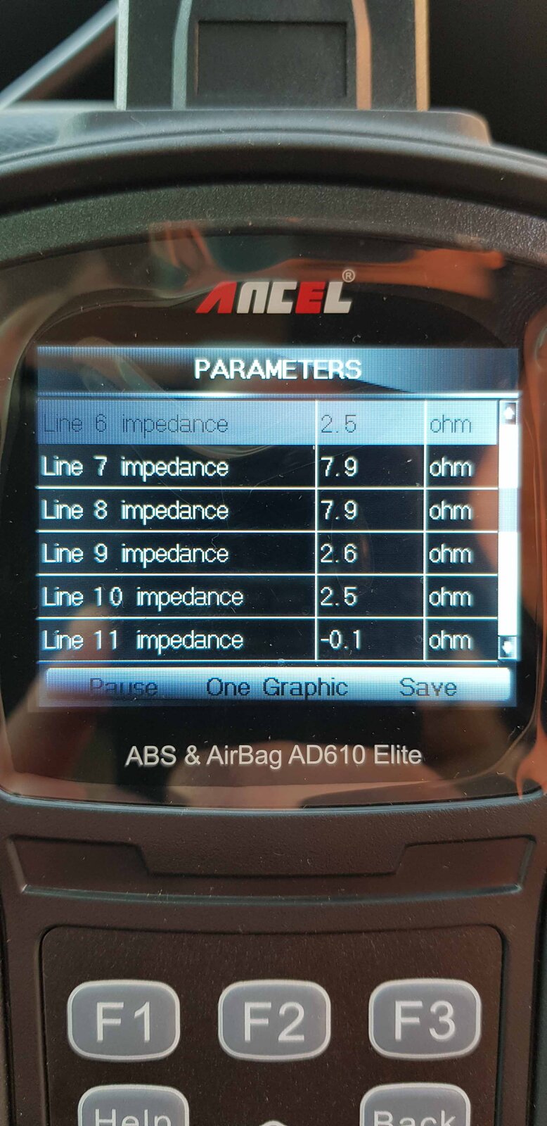

Can anyone with a OBD2 reader that can talk to the airbag ECU, who's clio doesn't have an airbag problem please spare me 10 minutes and read the parameters so I can compare the line impedance Ω's with mine as as shown below I have 2 the show 7.9Ω and 2 that show -0.1Ω
This will at least give me an idea that I do have a resistance problem.
