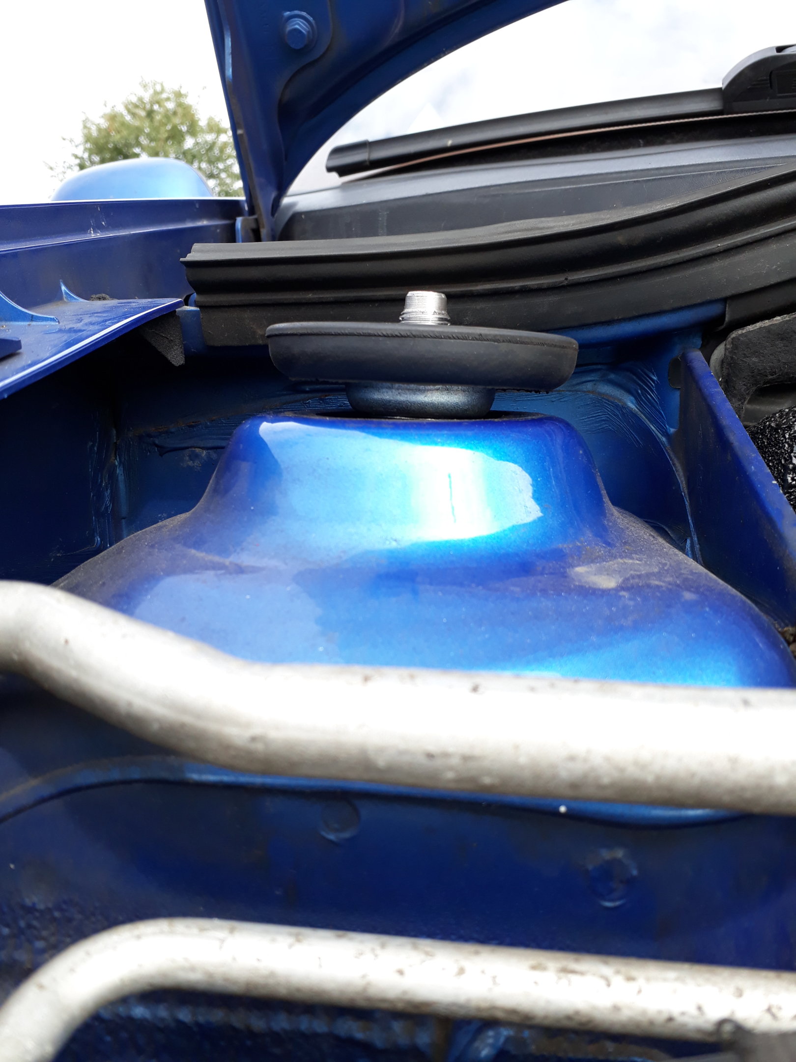

The only variable I have been able to come the conclusion of is that around a month ago I replaced both front strut dampers and installed brand new Febi top mounts. I have attached a photograph demonstrating the distance the offside mount is sitting proud after having jacked the car up and then returning it to the floor. I doubt this is an influencing factor though.

Going back to the photo I attached of the offside top mount, this is sitting significantly higher than the nearside. Having this evening taken both the top nuts off the mounts, it looks as though one of the rubber cones is sat further into the wheel arch recess than the other. I suspect this may be having an influence on the car's behaviour. Is anyone aware of incorrect rubber cones being supplied in the febi kits?
I installed the Febi kit 37597A is of any help.
This weekend I will be taking the front struts out of the car to inspect the rubber cones and see if I can find any differences.

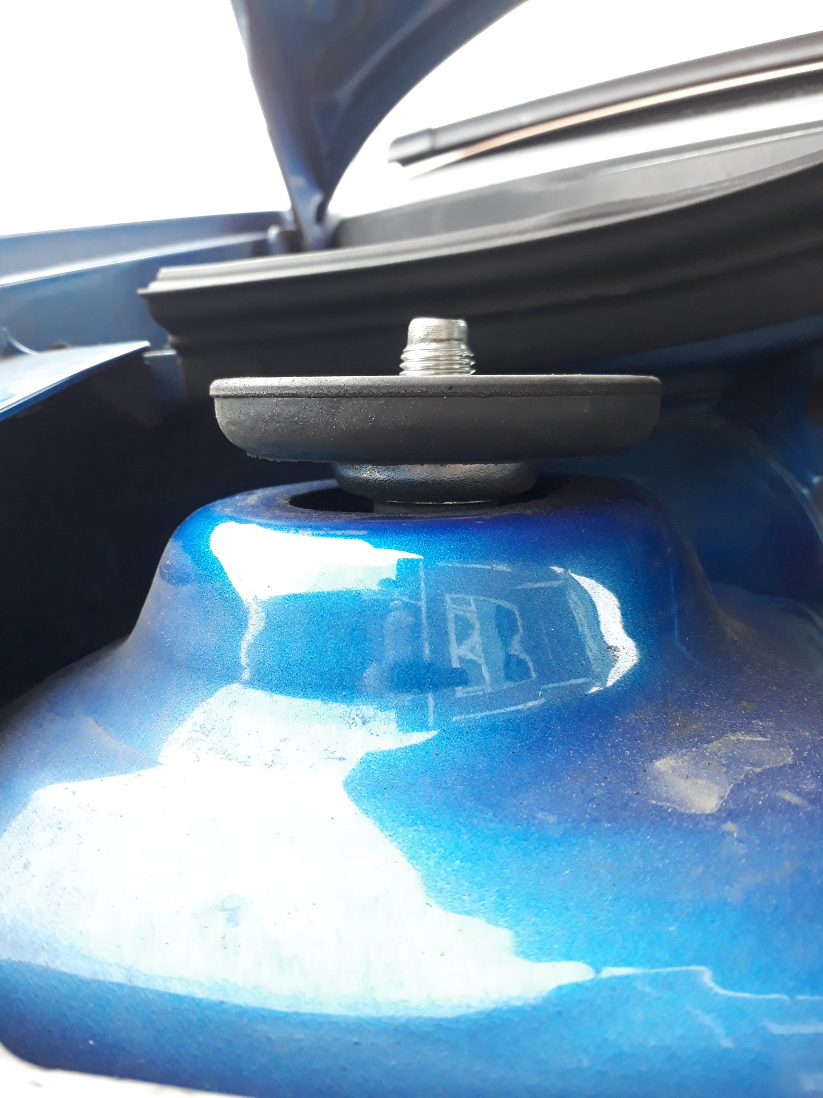

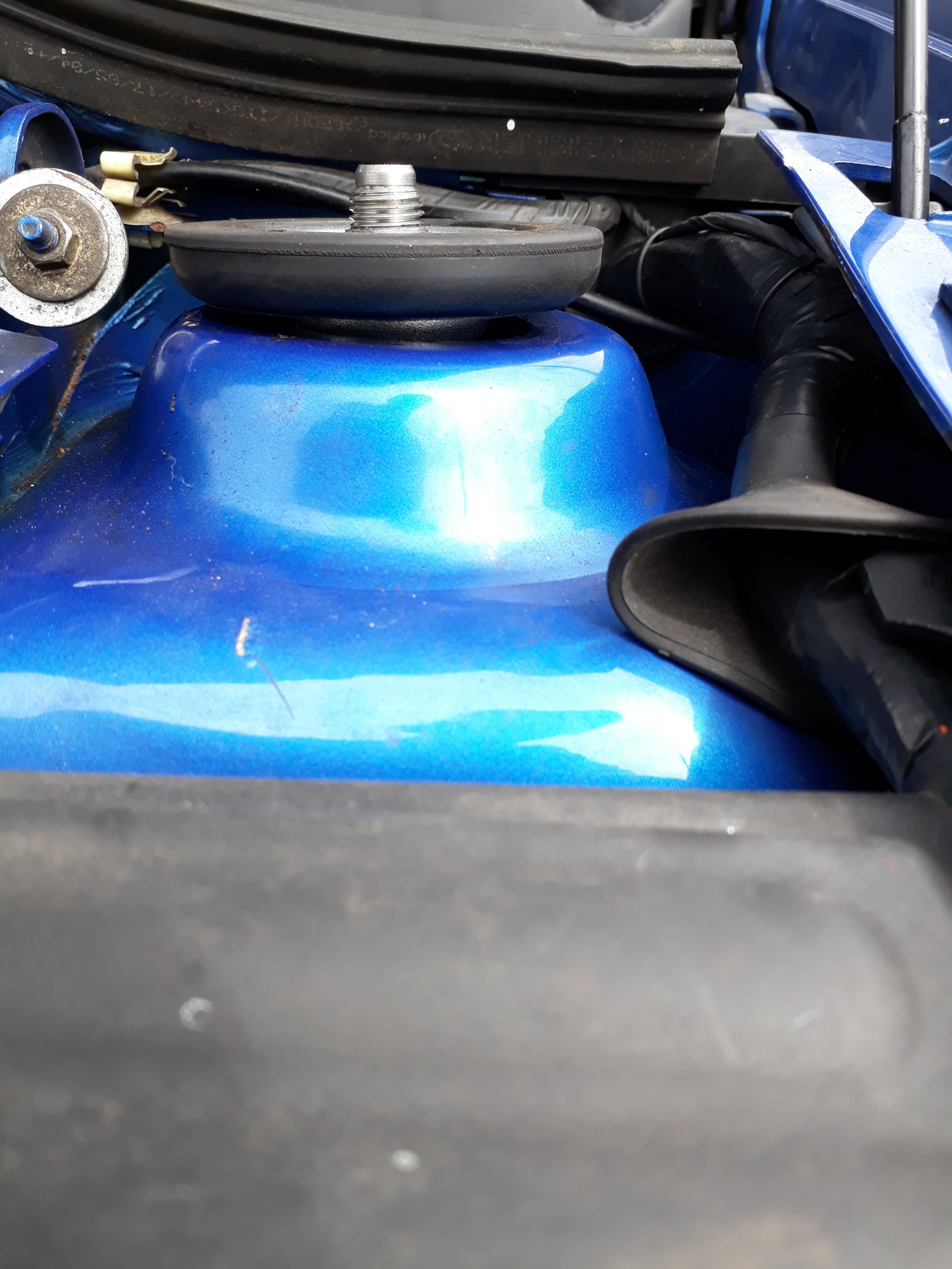

I do still have the difference in top mount height however, as per below. I have attached a photograph demonstrating the difference between nearside and offside, with the car parked on a flat part of road. Is this normal?

Did you tighten the top hat of the spring down properly? The 17mm nut holding down the rubber, bearing and the spacer cap?
This. Plus is the spacer in the correct way on both sides? I.e did you ensure you’ve built both up equally?
Did you check how the springs were housed in the strut caps (both top and bottom)? I’ve seen it before where a strut cap had a smaller ‘dent’ that was idea and the spring didn’t want to seat correctly for love nor money.
  Clio
Hi,
Both upper parts of the strut and top mount were assembled the same way. I have measured with calipers to check there were no discrepancies and they are identical. On inspection one rubber mount visible sits snug in the strut well and the other does not. This is exactly what I had with the previous top mounts that I have replaced this morning.
