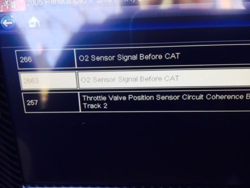

It has been on a diagnostic machine, I don't know what machine though as it wasn't mine (I don't have any renault diagnostics stuff). The throttle fault showed up as '257' but an internet search doesn't come up with anything relating to it that I can see. You can also see the lambda fault in the pic:

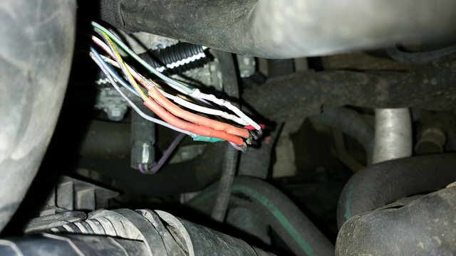

I noticed when removing the TB that the connector for the TB has had all the wired to it cut and replaced just near the plug, as if someone has put a new plug on. It looks to have been done properly though, all soldered and shrink wrapped. Should I remove the shrink wrap and check each of the connections?

I will get a pic up of the soldered wiring to the TB, it must be an issue that someone has tried to fix before. I wouldn't know where to start with checking the wiring, would I be best off getting a replacement loom (about £40 on ebay) and just swapping it out?
I got a photo of the wiring to the TB, it seems to have been done properly with shrink wrap so not sure if I should fiddle with it or not.
