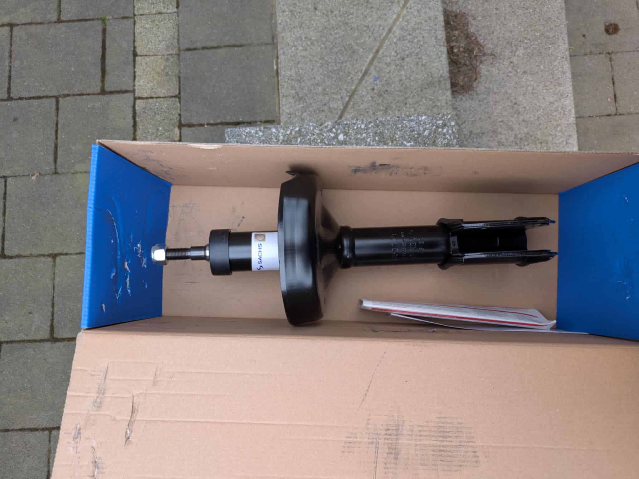

Went onto Autodoc and had a look, KYB didn't list any (i believe that's who manufactured the Renault items?) but seen Sachs did, along with a few other cheaper brands. Ordered a pair of Sachs and when they arrived they are some odd hybrid using 172 bolt spacing, but with smaller bolt holes that the standard bolt wouldn't fit anyway, on a non RS shock. a bit more digging online shows they are listed as fitment for both 1.2 16v and 2.0 16v which obviously makes no sense.
