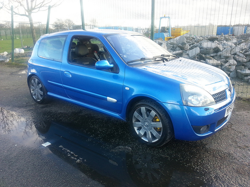

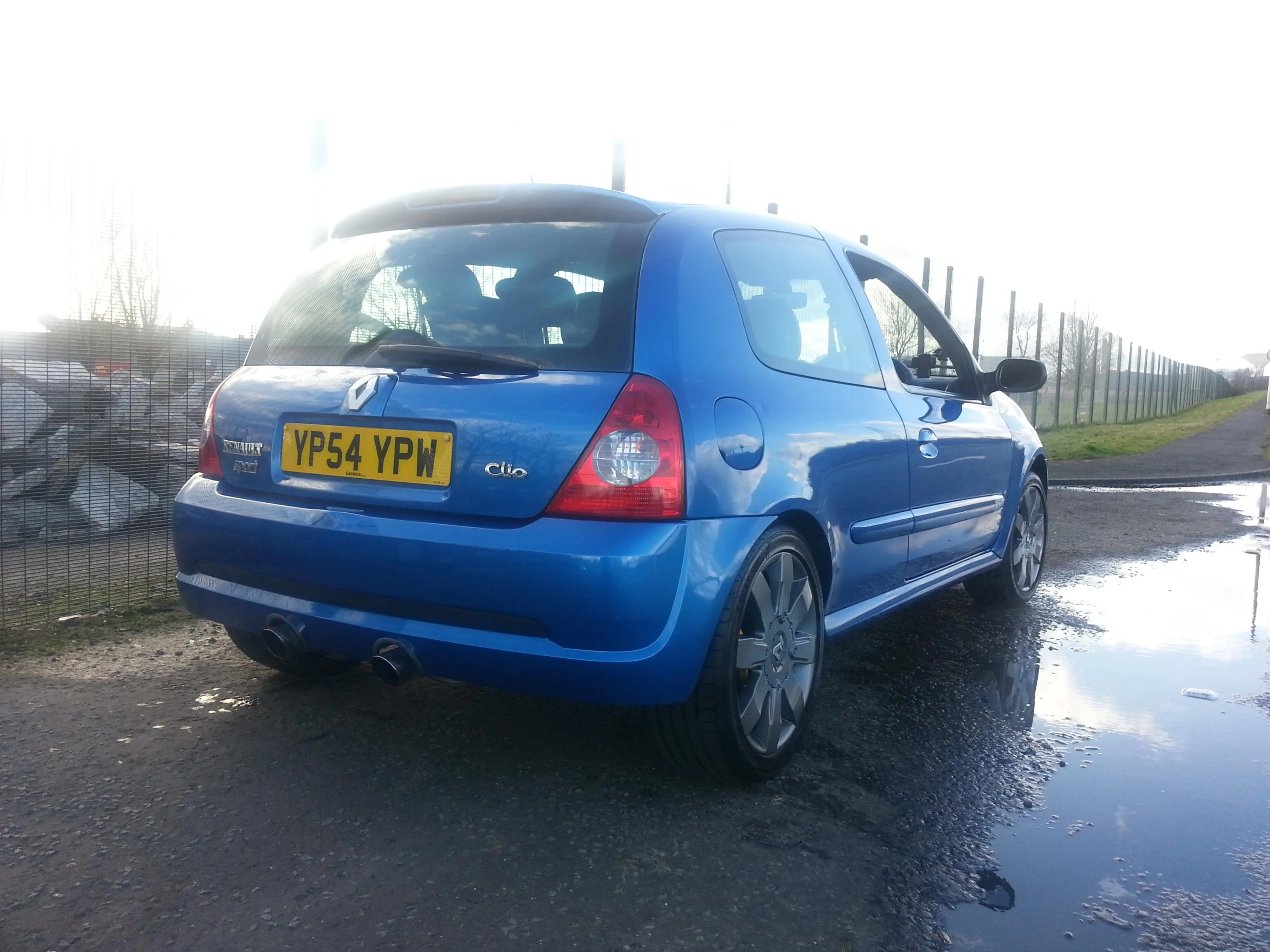

so this is how she looked when I got her in January except the bullets and diamonds where anthracite which I quickly swapped over to standard

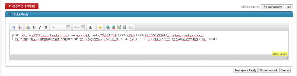

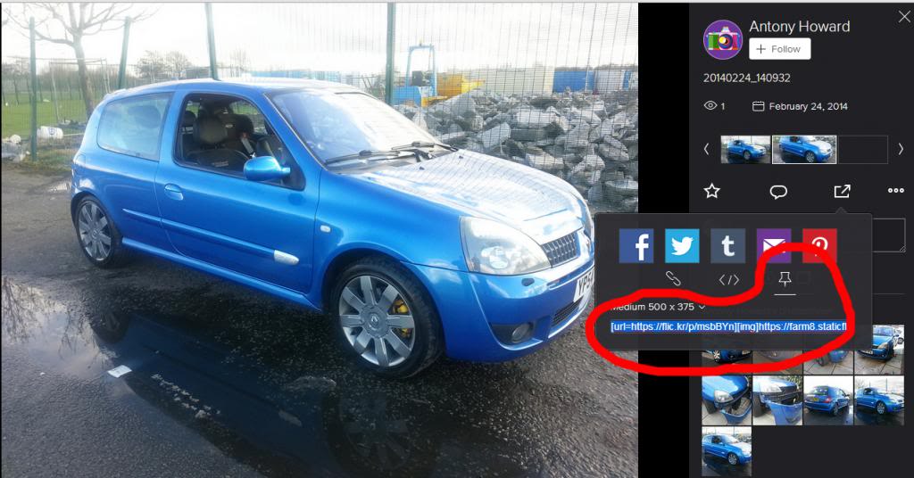

tried to add more pics here but failed ??????????? why do some upload and some dont and how do I link from bloody Flickr ??????? HELP PLEASE :S

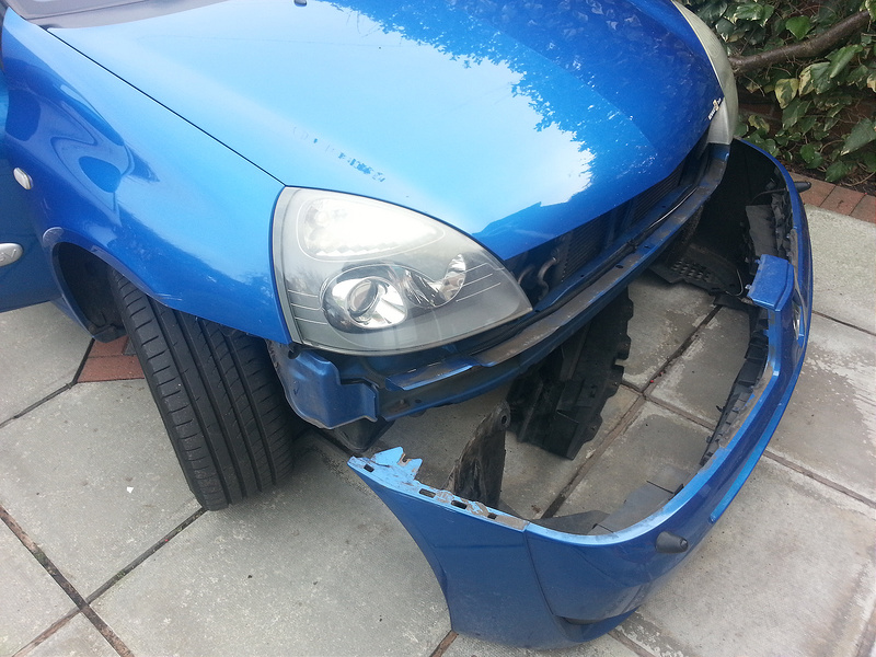

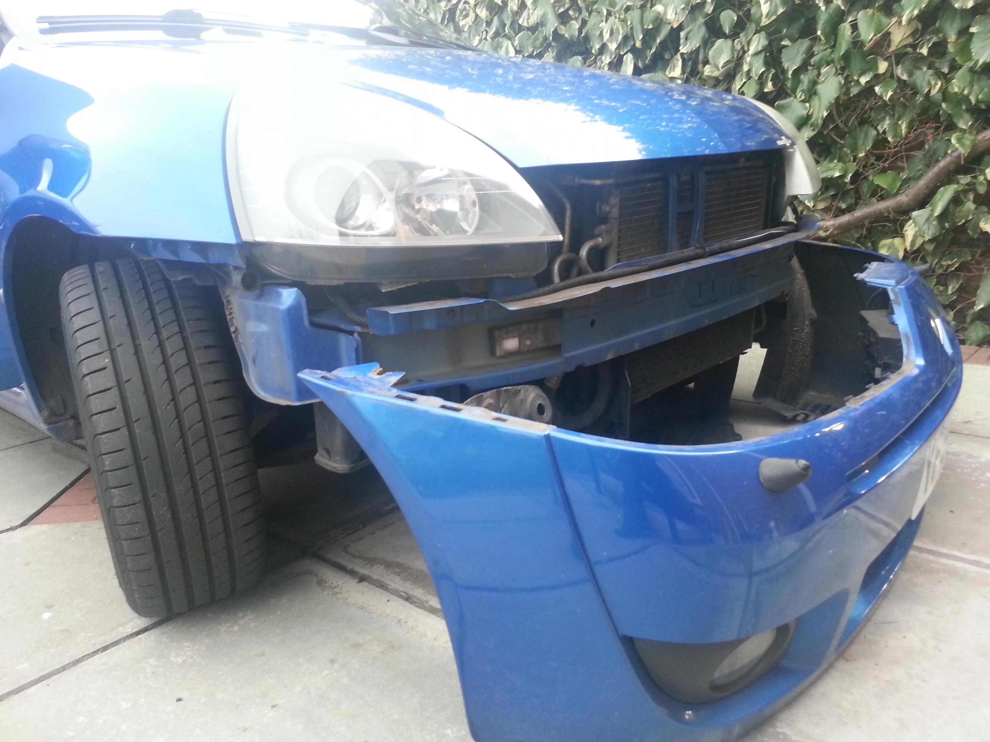

Then Disaster. after owning the car for four weeks I came out of work one night to see the car had been subject to some hit and run B*****D
front wing damaged front bumper literally ripped off and grill all broken. I WAS F*****G FURIOUS.
Anyway what could I do but pick up the pieces throw them in the back of the car and drive home .
So jumps in drives a few hundred yards up the road and BANG hit a pothole and wreck nearside front tyre. AAAAAAAAArgh
Rings my dad to come and collect me and leave the car there until morning.
This is a pic on the drive next day but this is the sight i was greeted with when i found her the night before

I have got the car back together but still need to replace the fender which I have now sourced and get the bumper painted as and when I can

GREAT SCOTT I think hes done it.
Give that man Grazo a cigar for his patience with a total flickr noob

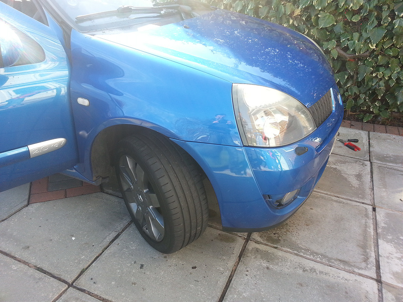

Not good at all Like I said the bumper had literally been ripped off and most of the mounting points for the bolts where damaged .
I have got it back on with plenty of messing and it sits near enough perfect so may just stick with it and get it painted when I can
Anyway with the bumper being off it was a good time to replace a cracked fog lamp, attach the skoda splitter I got in the group buy and satin black the grills and fog surrounds.
So all that done a couple of hours later the car was looking like itself again
and a few hours after I started she was washed and hoovered and back on the road.

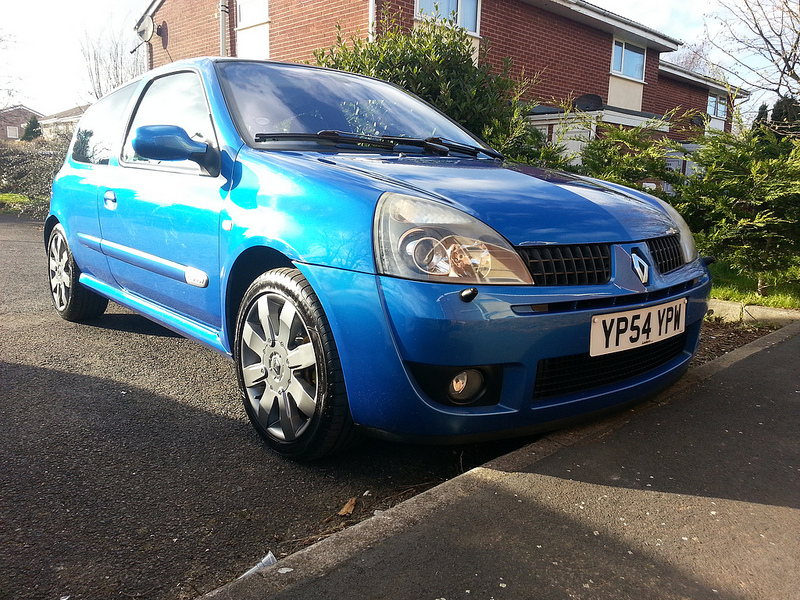

Anyway she looks like this now.........I know I know the gap on those arches is HUGE

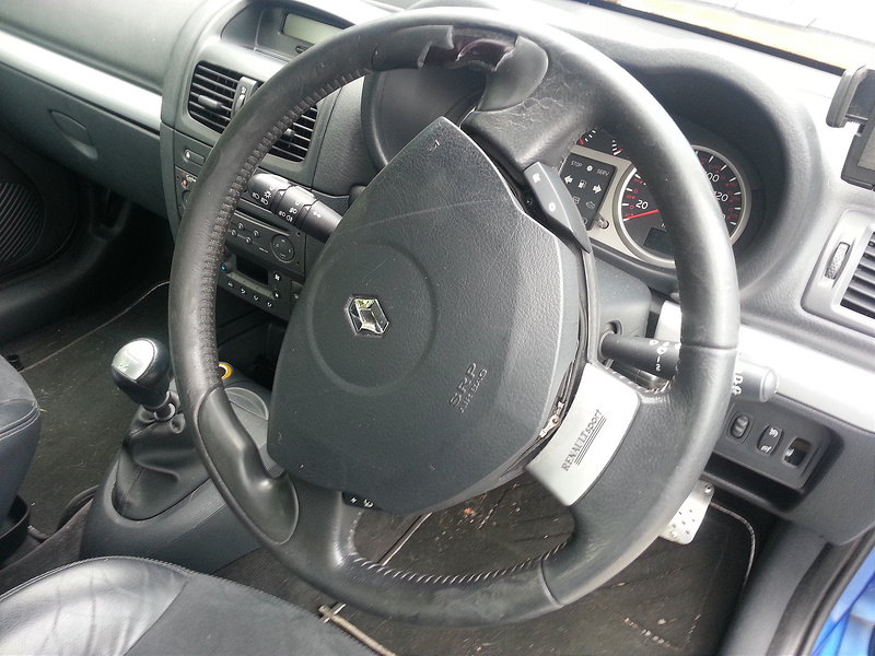

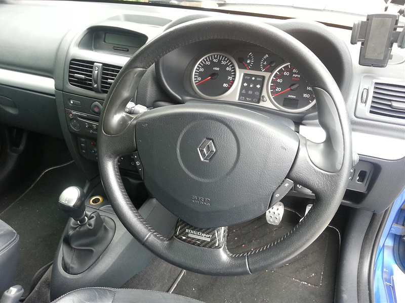

OK little update today
Just the usual steering wheel and headlights but I am quite pleased with the results.
The wheel isn't perfect but will do until I can get through the snappy waiting list :)
So the steering wheel was as most totally knackered so I came across a decent OEM
Its not perfect but it will do for now

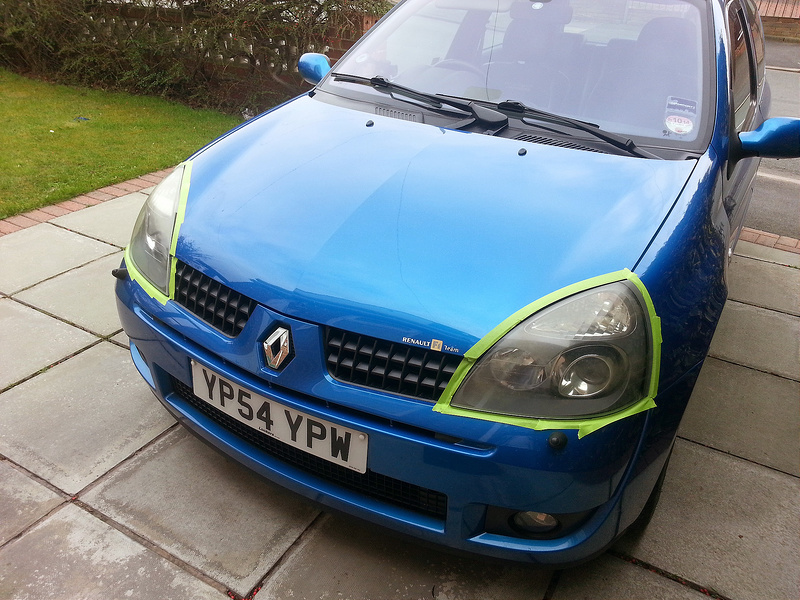

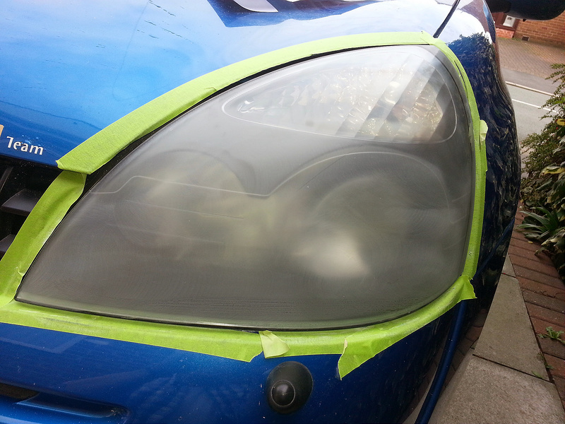

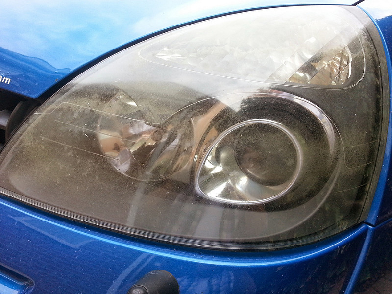

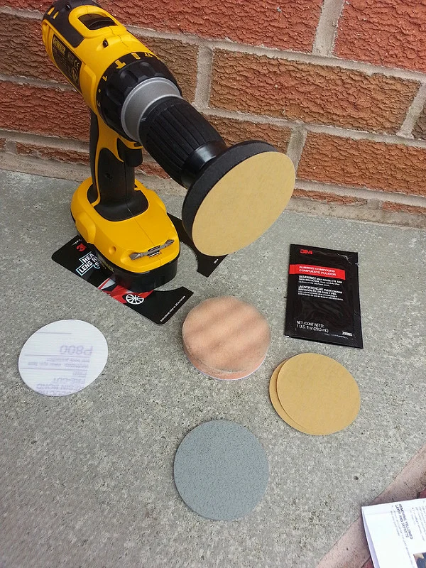

Next up was the headlights with the usual hazing

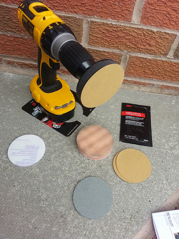

I used a 3m kit and I can definitely recommend it as I think it gave top results
Headlights where pretty bad beforehand as you can see
So first thing was to protect surrounding areas with the supplied tape
Then onto the 500 sanding disc
After around 10 minutes of sanding the yellow hazing was gone and a nice smooth frosty surface remained
Repeat with 800 and 3000 discs and onto the polishing compound and the end result is ....I think fantastic
