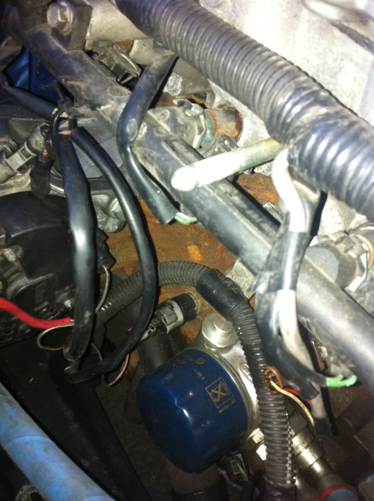

If it's the sensor, here's a pic of where it is, it's very easy to replace. (just on the left of the filter), believe it's a 22mm deep socked you'll need

Ordered a switch just now will leave the car in the drive until it arrives. Dont want to risk damage if its not the switch. Fingers crossed.
