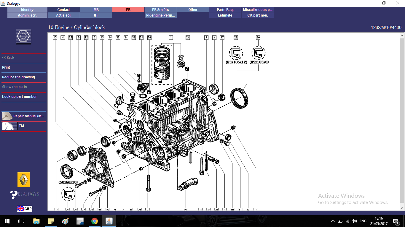

The hard cornering wont cause oil to escape the sump, if any of the seals in that area are worn out the oil will leak out just with the engine running. There's loads of places oil can escape from so narrowing things down to a particular side/area of the engine will help point towards the problem, this pic might help
