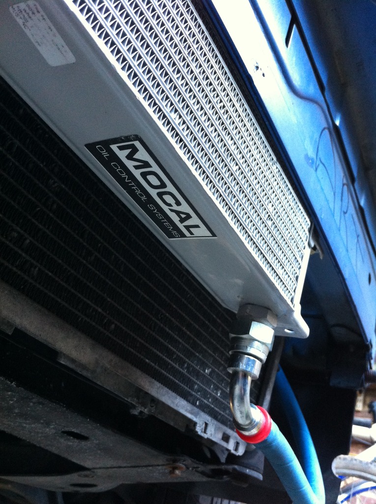

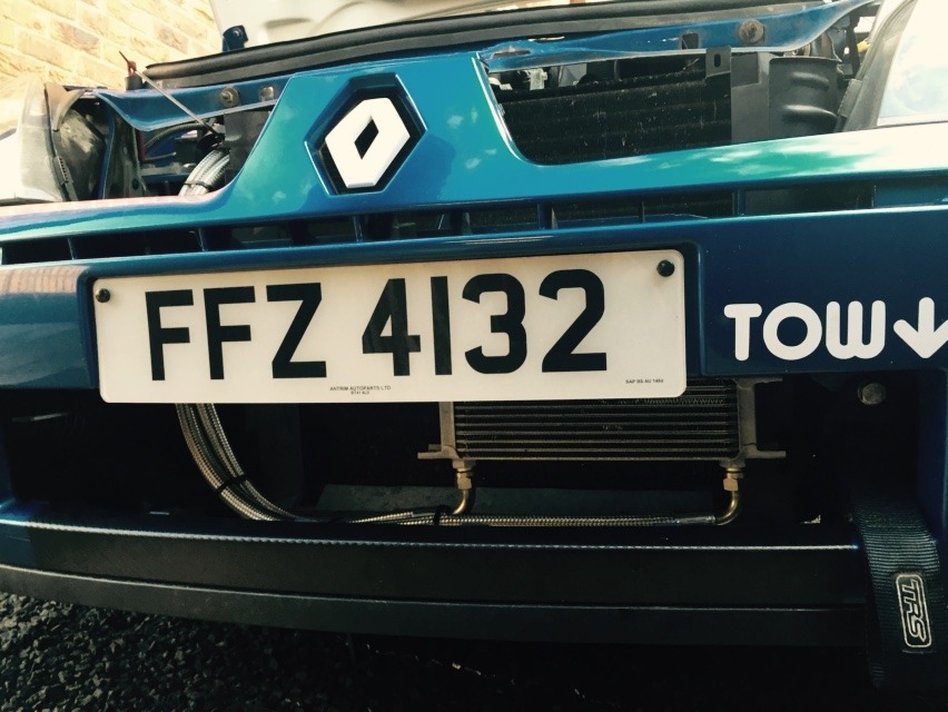

I put a wanted ad on here, got a mocal 10 row with thermostatic plate and braided hoses.....which I'd prefer as there's less risk of them being cut open by rubbing/stones etc, worth spending a bit extra. It made ~ 20 degree difference to my car on track so happy with that. Not sure I'd want a bigger cooler as it hangs pretty low once the fittings are on there.....

yes there is definitely room on top, although some sort of bracket needs made as the cooler is longer than the flat portion of the crash bar, no big deal though. I put it under as I had pre made hoses and they were long and didn't want to just coil them in the engine bay. Yes, 2 plates, one for an oil temp gauge, the Mocal plate didn't really have a place I could drill and tap for it, so just have both. One track day down fitted and no issues, but glad I did it.

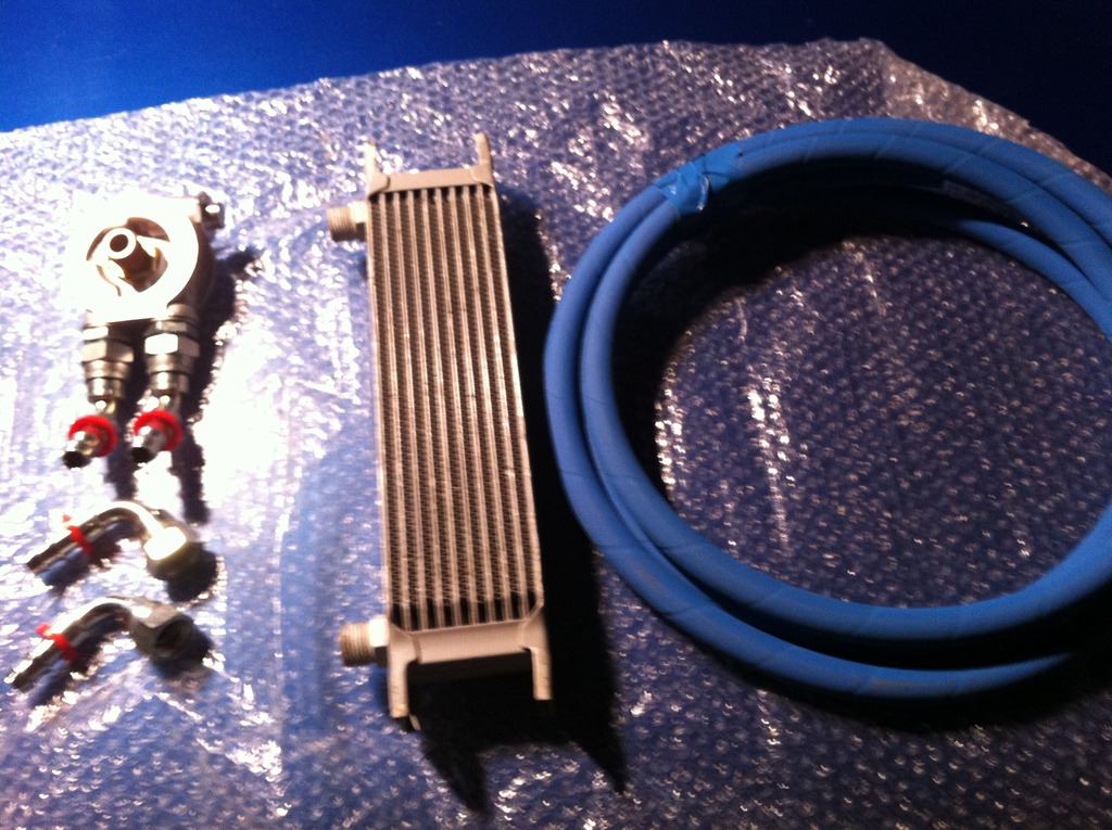

Have a look at the speedflow push on hose and hose ends. Not expensive at all to buy and very reliable. They've got the internal dimensions on the site.

I'm using Mocal AQP Aeroquip 1/2" Hose for my oil cooler on the 172 Turbo, takes some getting on, but if you use the matching fittings there no need for hose clips, and you can just cut to the length required.
And if your looking for a cheap cooler, i'm using an MGB GT 13row Oil Cooler from ebay, make sure you go with a Thermostatic Sandwich Plate, the quicker the oil gets up to temp the less wear there is on the engine, and the quicker you can give it the beans.

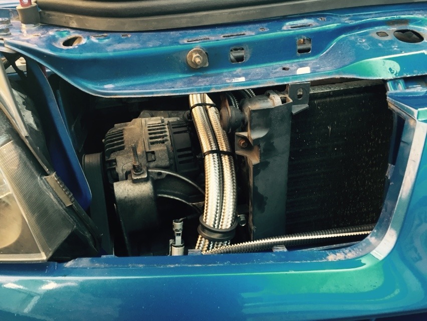

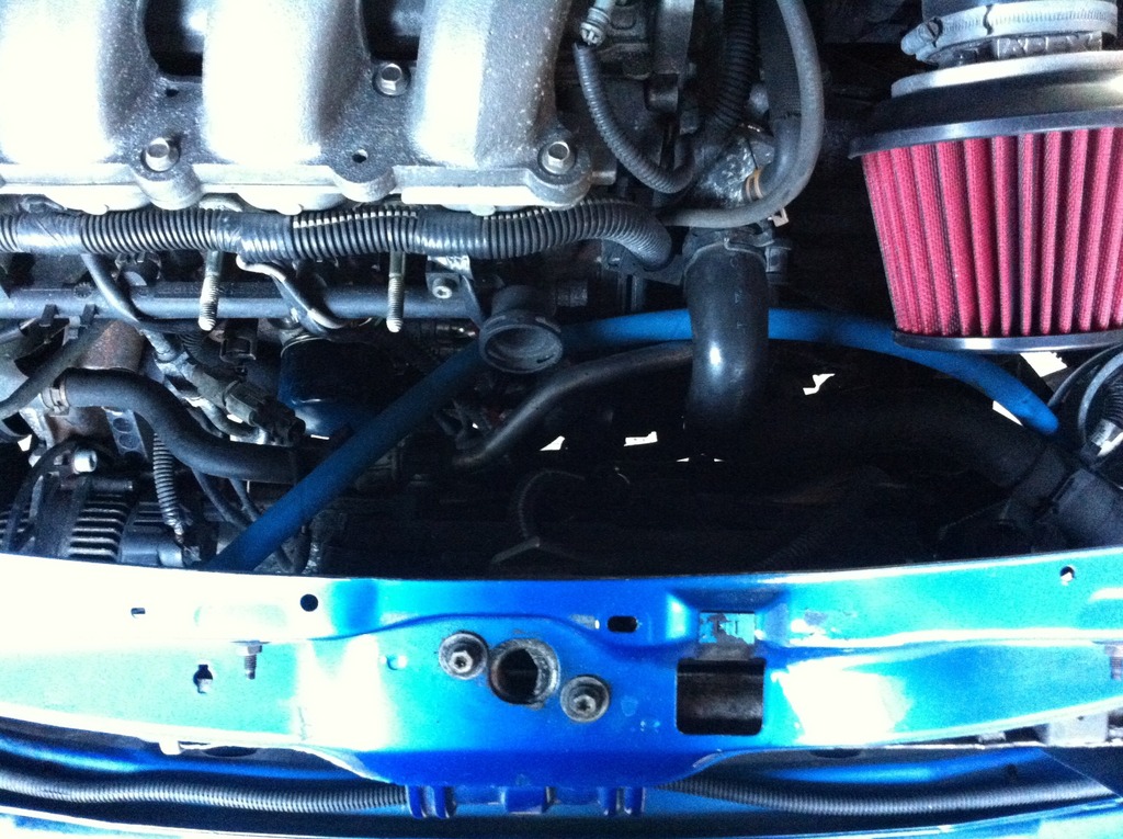

Just had a look at that pipe, it does seem like a good idea and not that expensive either but how secure is it .

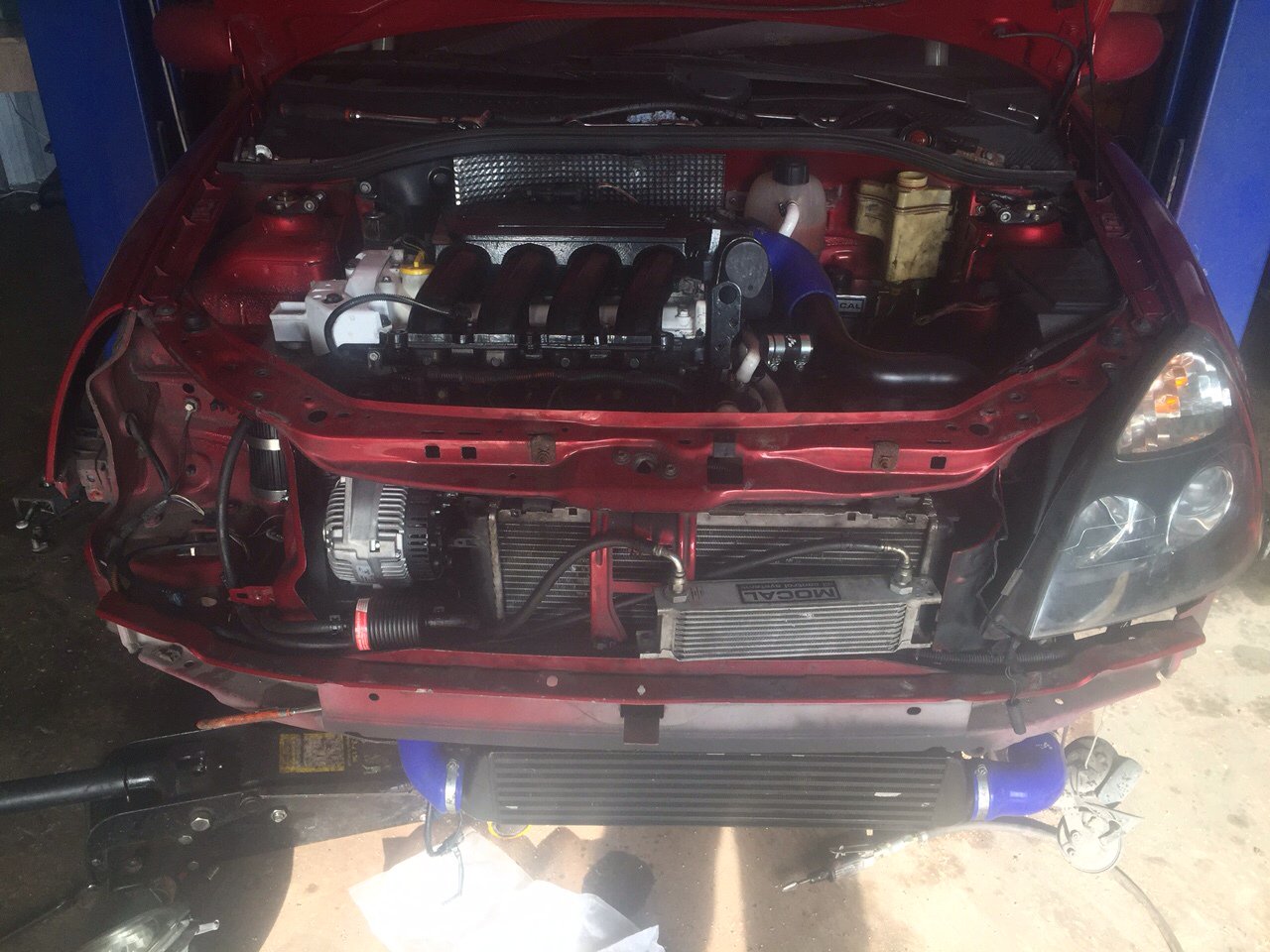

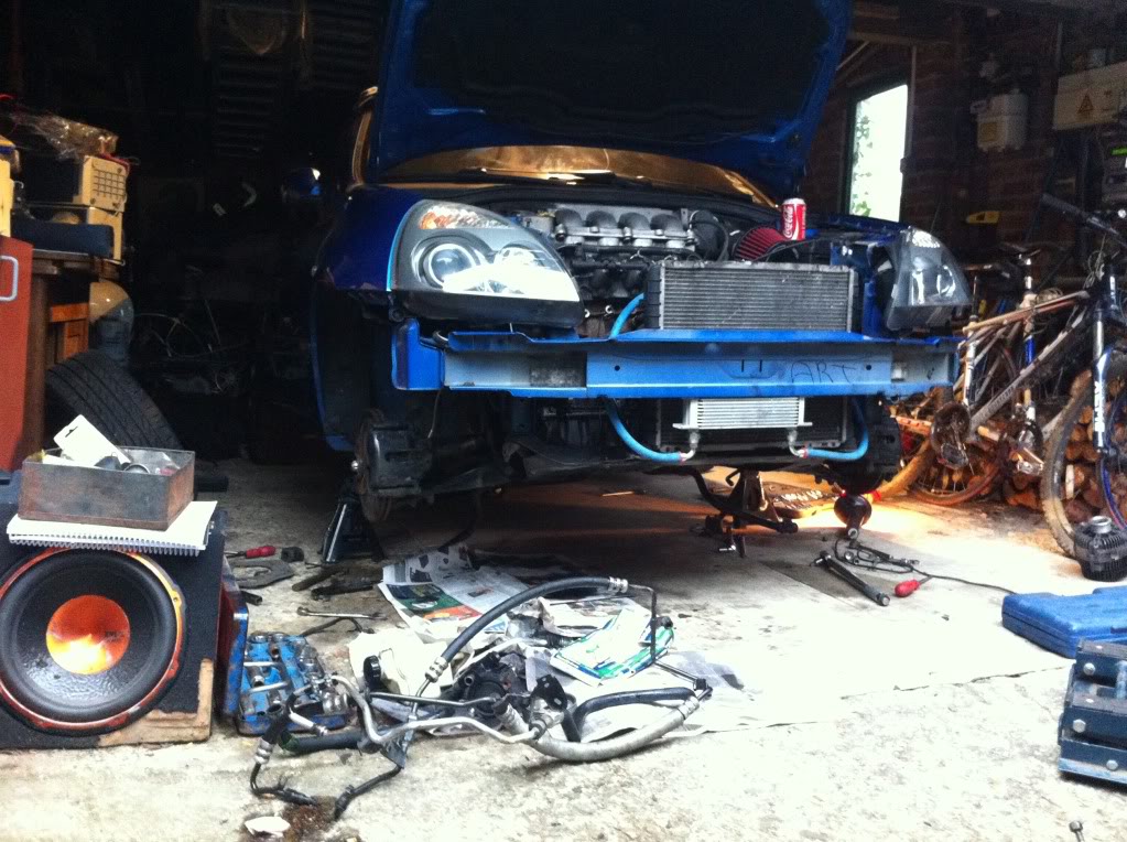

Have you got any pictures of how you have routed your pipe and where your cooler is fitted.

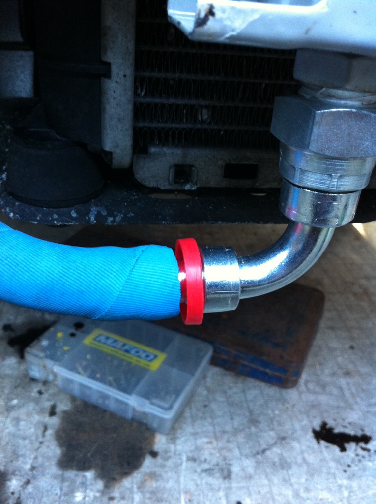

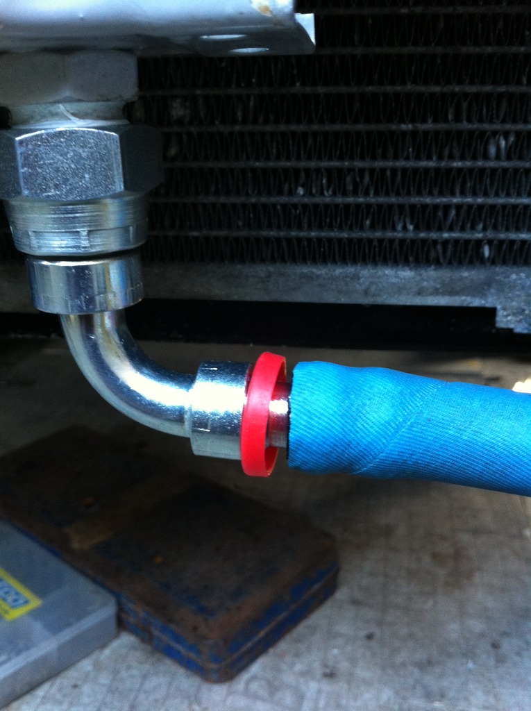

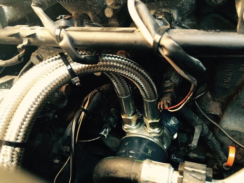

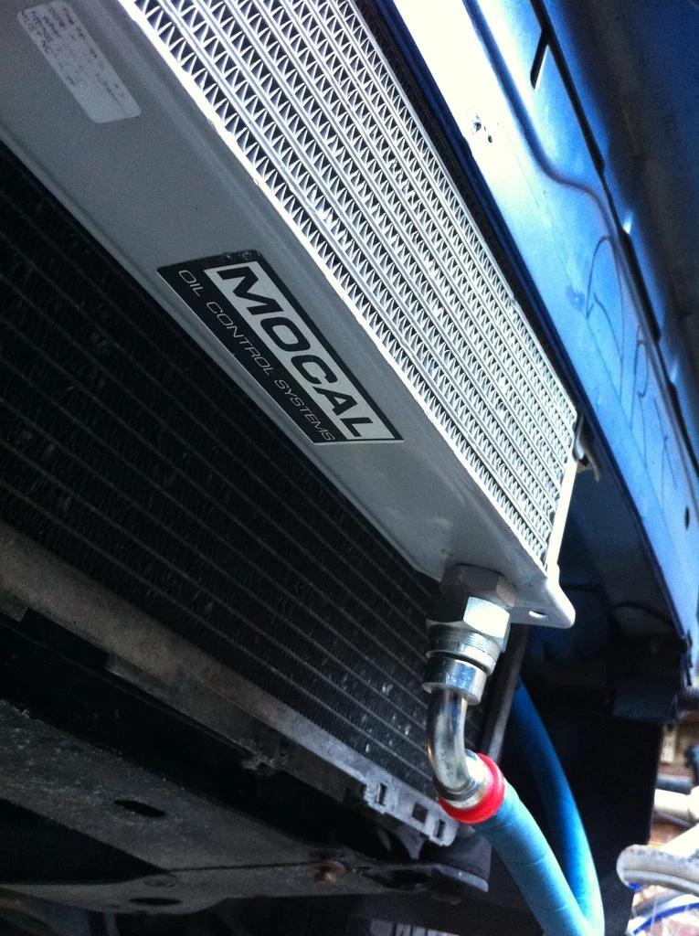

I had exactly the same fear about push on hose but can say its absolutely crazy how tight it is. It's not coming off without being cut off the barbs. Found some more pics of mine. Like @EZ Tutty I had 1/2 bsp or 13mm. Mine was mocal push fit. Bought 3m which was plenty. Couldn't push these on more than the below. Did thousands of miles and a few track sessions like it and they never moved.
Mines a Cup so routing the pipe is easier as I Have no air con.
I found soaking the end in boiling water and using a squirt of WD40 helped to shove them on all the way.... Was still a b**ch tho!

Really depends on where you're siting it, I have a 10 row, spaced down about 1/2" to clear the lip of the crash bar and with the fittings it's low enough, a trip over a large curb or onto the grass would worry me. It dropped my temps ~20'C so I don't think a bigger one's needed anyway.
