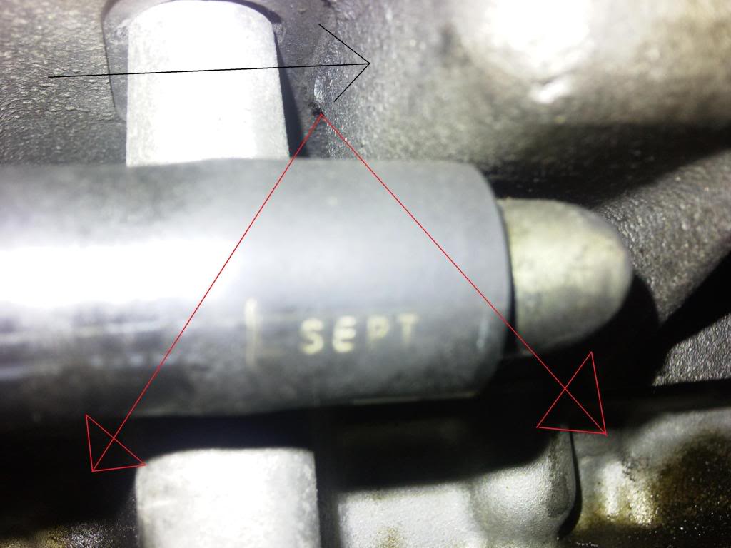

Thanks for the help so far guys, had a look today and I am still unsure to be honest, so I have taken some pictures to see what you guys think.
^^ This is where I think the main leak is coming from, would you say this bolt is the one that is leaking?

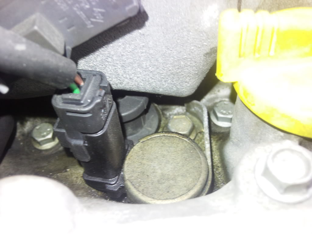

There is some oil here as well but I am thinking this may have just been spilt from when changing the oil?

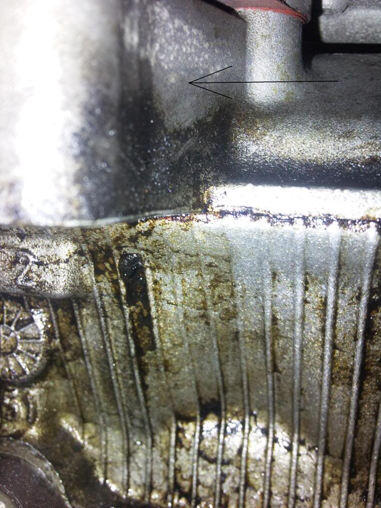

Okay this is a picture from the back of the enine bay looking towards the engine, sorry it aint great but its an difficult place to get to, but as you can see there is a fair bit of oil. Tryong to give you some idea of where the picture is looking at the black arrow is pointing at the part that holds what I think is the coil pack (I may have got the wrong name for that part tho)

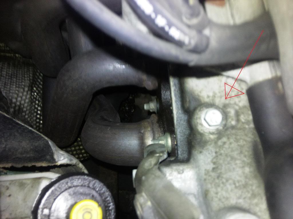

Okay last pic... again back of engine, this is where i think the main leak is. (Black arrow = same as last picture) As you can see its pretty bad. What do you think?
