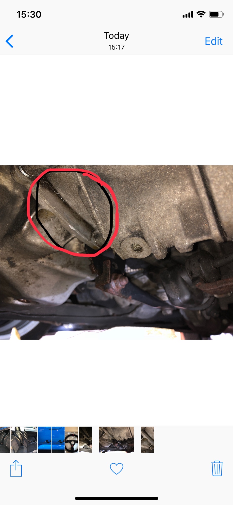

Selector seal and casing leak. Both need the box opening to fix I’m afraid.
It’s more the time and cost of removing the box tbh mate. I can sort the box if you can get it out and up to me though.Ah damn it. Not a cheap and easy fix then.

Yep. That’s the casing join mate so it’ll need to be opened up to fix.Thanks.

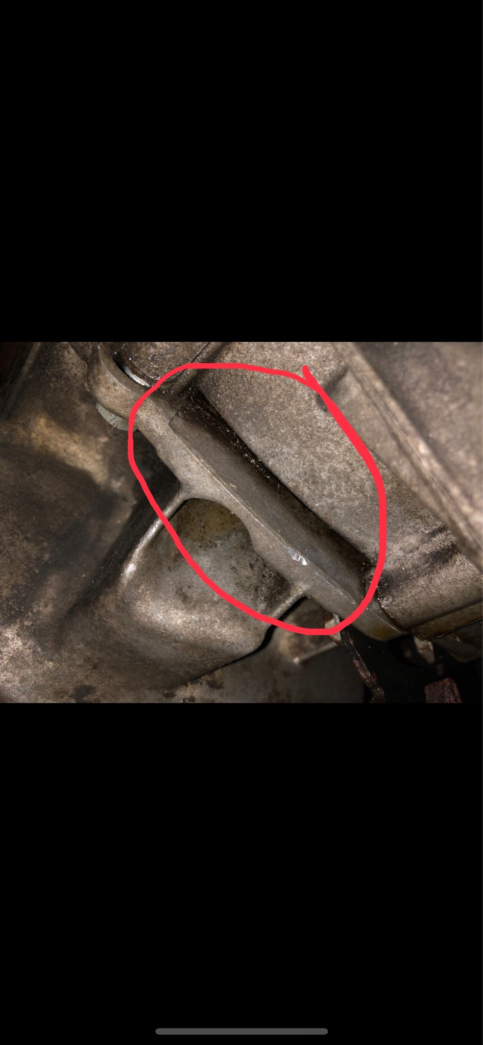

Just had another look and the leak appears to coming from the area in the pic. Or somewhere from there.

Bellhousing/sump is circled.
Is it?! Lol didn’t pay enough attention clearly!Bellhousing/sump is circled.
@Phil555 Rubber gasket on the sump. Could be rear main oil seal as well if it’s leaking in that area.
