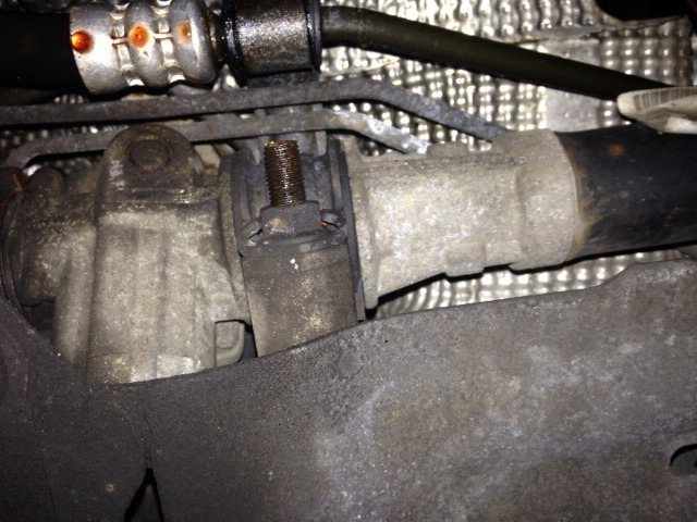

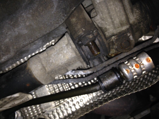

hi folks, I'm a new fully paid up member and picked up a nice 182 this week. It's got an oil leak which I'm after advice on please. Not hugely mechanically minded so thought I would post a few pics here to see if it's a common problem area. The belts and dephaser pulley were changed last week also. Thanks for any advice or pointing me in the right direction.....

As above, looks like the high pressure power steering hose
My one leaked and its a pain to change 😧
I did write up a guide in the guides section from when i did mine

Thanks guys much appreciated. I'll check out the how-to-guide and see if I can pick a used pipe set up. Cheers.
  Clio 182 FF
Well, picked up a PAS pipe set off Ebay dead cheap and got the job done this weekend. Must admit, its a b**ch of a job and I bailed - calling in my local spanner monkey to sort it for us. All seems ok now...lets the mods commence! Thanks fellas, much appreciated.
