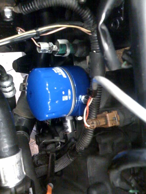

Found some photos of what im guessing im asking about (borrowed off Icarus)
Take off plate for oil pressure/temp.
Yea, the green sender.
deally fit a take off with a length of braided hose to remote mount both the new and old sensor on a T peice.

Yeah I am looking to get oil temp and pressure in mine as I miss it from my Williams.
I did. It's the blue plate under the oil filter in the above pic. Just a default off the shelf one. Nothing special or hard to source.

So once a sandwich plate or whatever is fitted just need is the gauge and an appropriate sensor correct?
had issues with inferior rubber seals on sandwich plates in the past so i dont use them, but yeah, they're an option
Well don't buy cheap ones then! I've never had an issue with them and have used them on everything from Nobles to Novas for oil cooler take offs and temp/pressure take offs.
