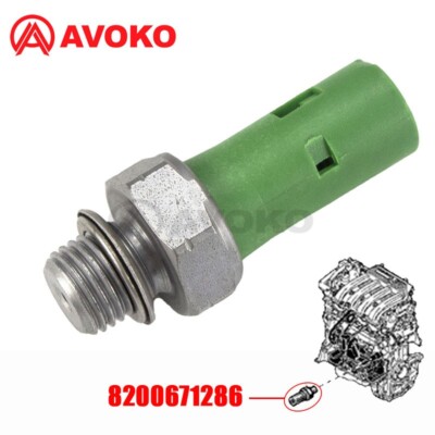

Can anyone please confirm if the oil pressure switch sensor is located immediately to the left of the oil filter on the front of the engine?
Im stuck at work in severe weather with STOP and red oil can lights so any help appreciated!
  cup 172
cheers for that Fred
Its getting at it in a 60mph wind with the bonnet flapping about thats an issue now! Wheres my 19mm deep reach socket when you need it.
  cup 172
For anyone else with same problem. Renault charged £28 for a new oil pressure sensor and brass washer. The item is an easy fit if you have a deep reach 22mm socket as then nothing around the sensor needs removed.
Halfords do one for a measly £6.49 in 1/2 inch drive.
