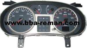

the dial at the top on the right is the one that randomly goes reall high
in the manual it said that the light meant the engine temp was to high and that i should stop and leave the car on idle for a few minutes until it dropped
That's water temp gauge mate.

That's water temp .. not oil temp sir !!
