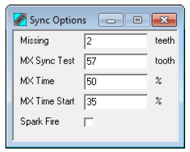

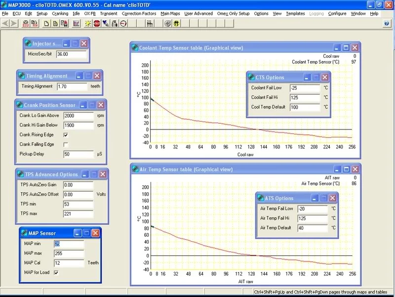

Just trying to configure the CPS on my omex 600. The map currently on ECU was set up for a 172 cup, im going to be putting this on my cup racer which has a modified flywheel. It is 60-2 still but the cutout in the flywheel is now missing the one long tooth and it is standard length like the others. If that makes sense?
What Omex say in the setup manual for 60-2 configuration
The configuration on the ECU for a 172 cup
Ive checked the tooth control table and it is exactly what its meant to be so im a bit confused as to why the MX time & MX Start time % are different. It also wont let me change them.
Anybody got an idea of how to change this?
