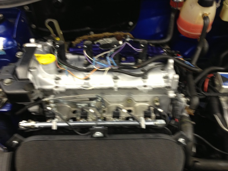

Just had a look about on the net and seen that a few people have done this on omex and ran it as wasted spark coil on plug, if I was to try this with scenic pencil coils would it just be 12 v from the coil plug pin 3 to each coil then pair cylinders 1 /4 and 2/3 to the relevant earth pins on the coil plug pins 1 and 2.

That would be my choice to Andy... Running this exact coil with my DTA S40pro for the 19

I tried pencil coils today wired as shown in the omex manual for wasted spark purely because they cost £5 from the breakers 5 min from my house, unfortunately this did not work either so the ecu is going ot Omex in the morning for a health check and ot have ignition amps re installed.
