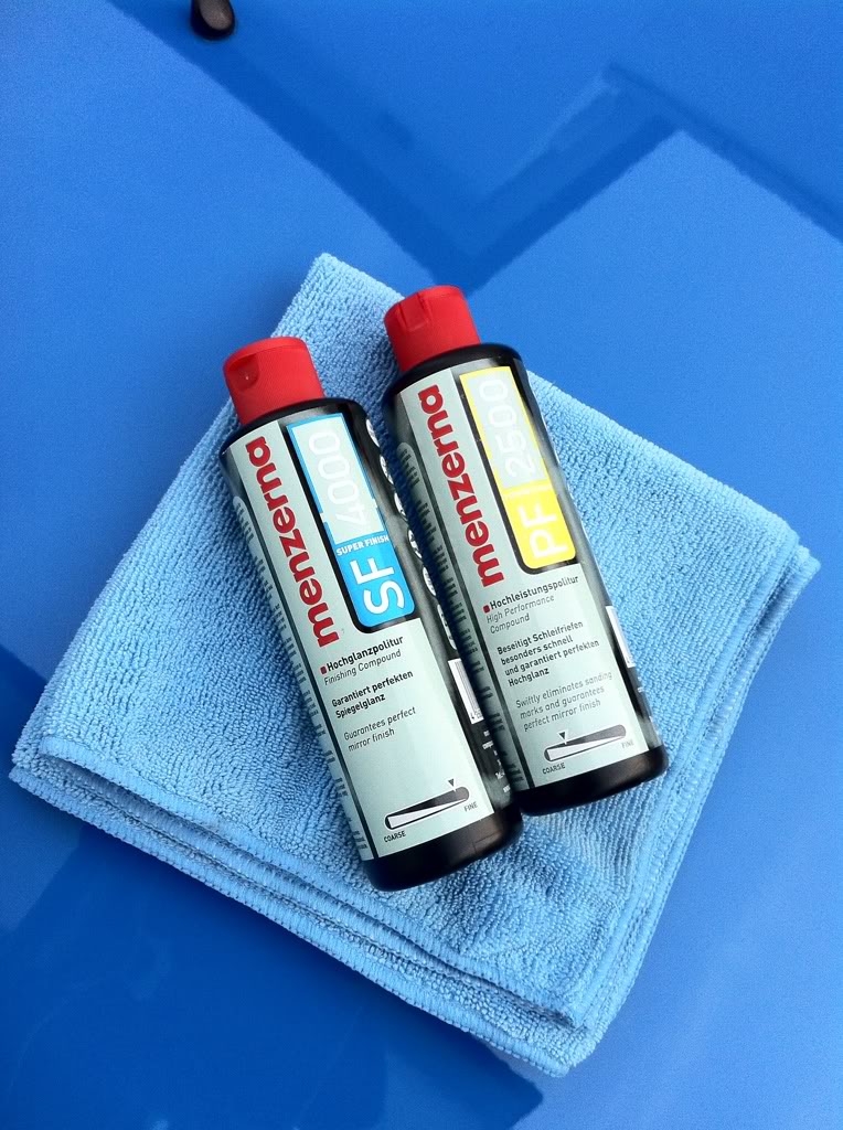

Currently using Menzerna Orange and White pads and Menzerna polish 2500 and 4000.

Orange is a cutting pad mate that means you're doing something major wrong. I'm guessing technique though.
Are you using a DA?
Clio paint is very hard from factory they use "clearcoat hard lacquer".

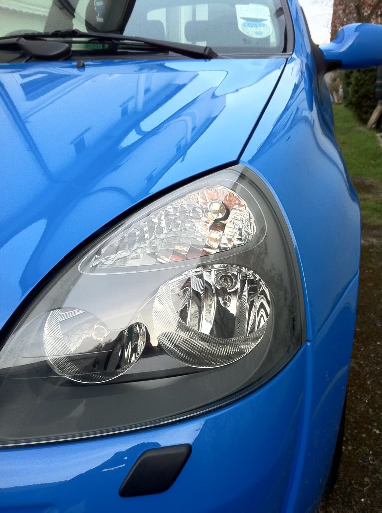

Was pleased with the headlight refurb I did with it too.

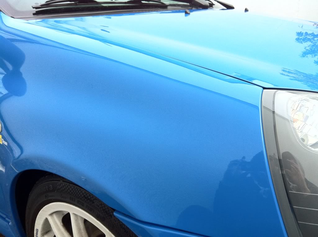

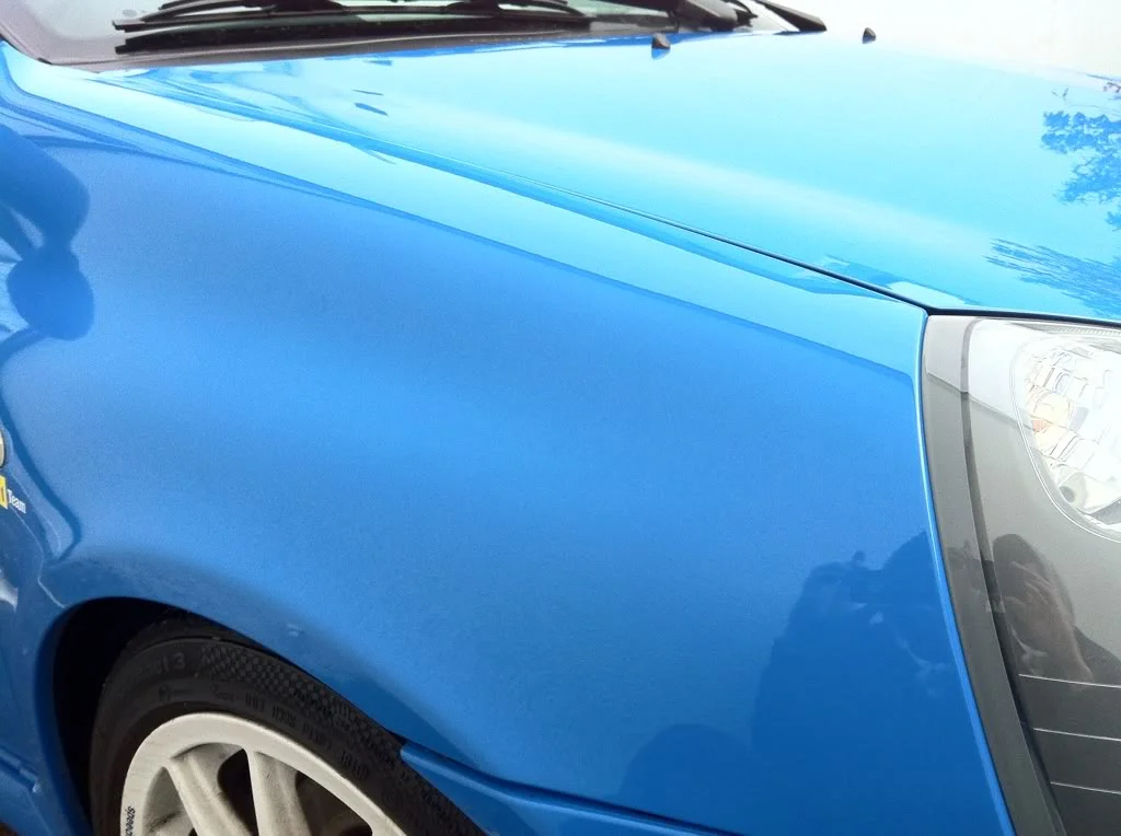

It looks pretty good here, but when the light is on the paint you can see the light swirls.
Gally
Are you using a DA?
The finish isn't bad tbh. I'm sorry to say but cutting into paint like that with those kind of pads isn't clever.
A simple one stage polish and glaze would suffice for the time being until your technique and stuff improves.
Even 95% correction can be like the holy grail. Takes proper practice etc to do. Guys like Russ don't just read threads and go detail. They practice.
I don't want you damaging your paintwork chasing something unachievable.

I'm not a fan of RB one bit, but those pics make the paint look very wet with good depth.
